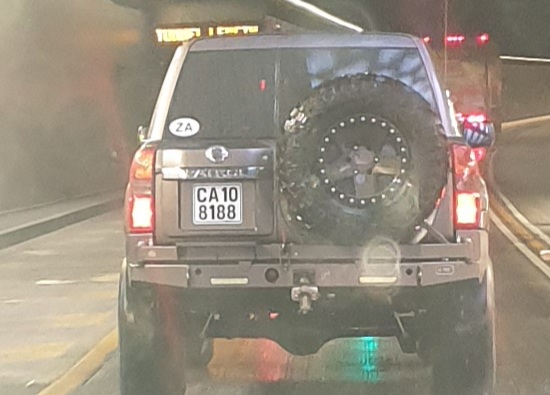

Gerhard, aka G-man's rear steal bumper is a really slim looking full steel bumper.
Looks like he did the quarter chop aswell.
Saving up as my next project.
