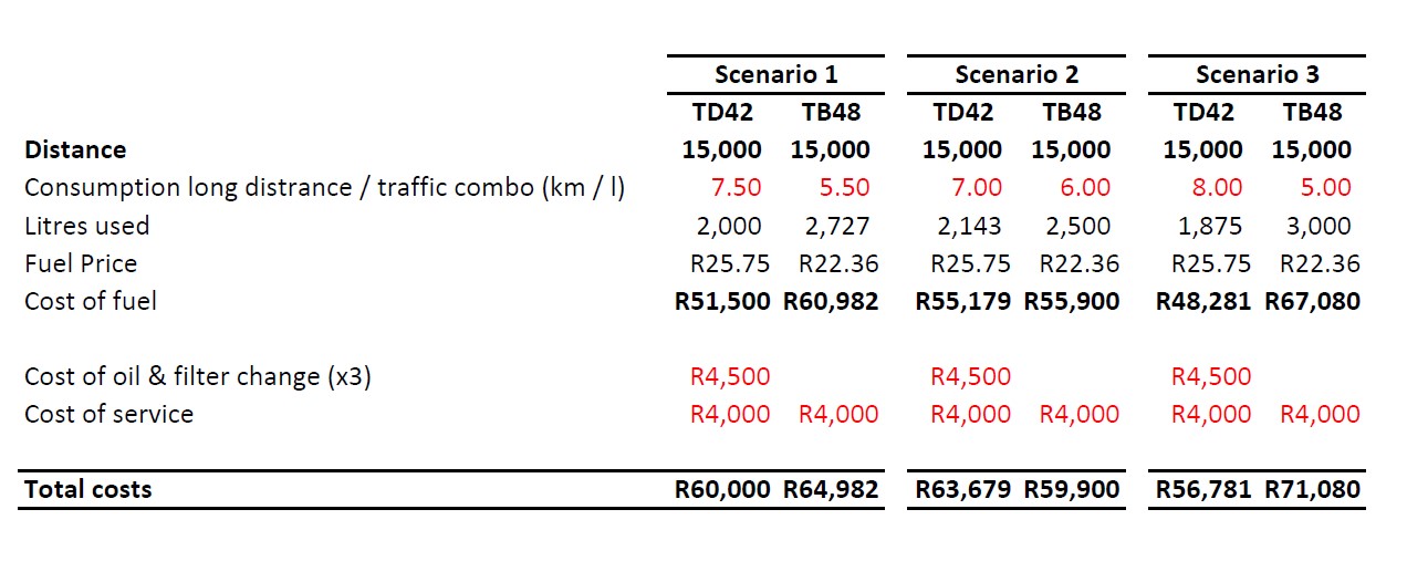

Recently I have been chatting to a friend who drives a petrol model Cruiser bakkie that's been rigged for touring.
He was complaining about his consumption, (around 5 and sometimes less than 5 km/l in traffic).
And it made me wonder again why the TB48 gets such a bad rap.
The EFI 4500 is notoriously heavy on fuel.
Be that as it may, more specifically, given where the price of diesel is nowadays, is it really worth it to have a TD42 rather than a TB48?
I know each has his favourite cup of tea. I like both. But using consumption as the reason for a TD42 is not a forgone conclusion anymore.
The TD42 also needs a bit more attention with more regular oil and oil filter changes. Beyond that, it gets more complicated, as the injection pump and tip service can be pricy, but then later on bigger things may need to get fixed on the petrol too. All in all, I think the TD42 is more costly in terms of maintenance though.
So below is a simplified comparison on three different scenarios - since not all TD42 and TB48s behave quite the same in terms of consumption.
If you disagree with the numbers, or would like a different distance travelled to be used, let me know, and I will gladly update the comparison.

Even when I did my engine swop (March 2019) the running costs were surprisingly similar when doing the calculations on normal pump fuel.
But I had two factors that changed the sums. Firstly at the time bio-diesel was reasonably available at about 60-70% the cost of pump fuel, and secondly my average fuel consumption at the time was 3.8km/l. These two factors made a big difference to the calculations. That first situation has changed now, and the second was unique to me.
However the diesel still has one big advantage: fuel range. It's other advantage is the massive torque available right at cruising speed. It makes for a far more relaxed drive, especially when towing (if you can keep the temperature under control).
The other often-mentioned advantage is the diesel's supposed better bottom-end torque. I still believe this to be false. The perception is due to the fact that the diesel's injector pump has a mechanism built in that attempts to keep the idle speed steady irrespective of load, and the TB series of engines don't. And so the diesel can be left to crawl over obstacles without throttle input. But I remain convinced that in the region below about 1200rpm, the petrol engines have more torque than any TD42 I have driven. It just requires a sensitive toe to access it without surging and breaking traction.

I have also been reconsidering the petrol vs diesel recently... ever since I paid R28 a liter for diesel last week
But we dont drive Patrols because it makes any long term sense financially compared to a polo
I think the purchase price makes the biggest difference, once again especially compared to a cruiser but at the end of the day the only thing better than 1 Patrol is another Patrol
and Alex has nailed that with 2 diesels and 2 petrols

I can understand the diesel vs petrol A vs B cost comparison for the average guy in a mix of city and leisure driving, but horses for courses. Type of use and availability of fuel are a big factor, for both cost and functionality.
You need a petrol trok in your fleet if you want to drive dunes (Cape, Kalahari, Namibia = petrol territory) The only reason I have a TB48 is because it's my Cape car, and I procrastinated for years before getting it because the cumbersome weight and size doesn't really suit the intended purpose, in comparison to bush driving where the size and weight improve the drive.
In the bush, and up north in africa (excluding Namibia) where you do between crawling speed and about 40kmh on dirt tracks, and up to 60-80kph on "the open road", with diesel fuel readily available due to the proximity of trucks, and would involve detours and route planning to fill with petrol, then in that environment naturally aspirated diesel is king and they chug along like a train.
Turbo-diesel are attractive because they are a happy medium ticking most boxes adequately to cover all bases. But turbo diesel patrols are just pretty scarce unfortunately
