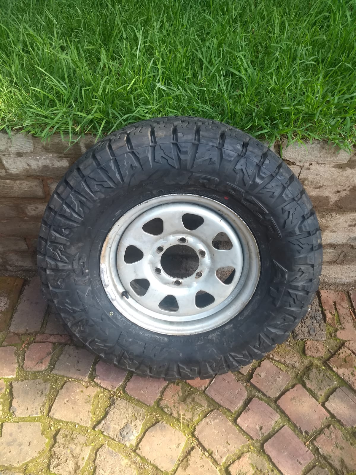

A quick update on the new Maxxis: I got them sorted out by Rob last week. They refitted all the tyres on the rims and got them properly balanced. Since then the wobble is gone. :woo:
Rob told me that one of the rims may have caused the wobble or added to it. However, he couldn’t tell me what exactly is wrong with that rim. I’m using it as a spare now.
Nevertheless, I would like to rotate all five tyres, so that they wear evenly. Hence, if anybody has a 16 inch steel rim that you are happy to part with for a reasonable amount, please let me know. I attached a pic of the spare wheel.
