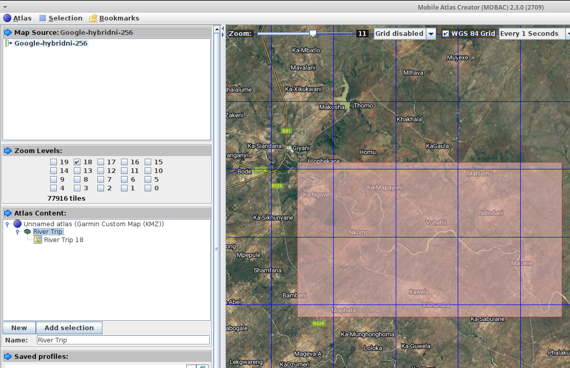

Basically, create a file called "google.xml" containing the text on the above-link. Restarting MOBAC and selecting "Google" from the list of map sources now provides access to the Google Earth satellite imagery. Win... :)

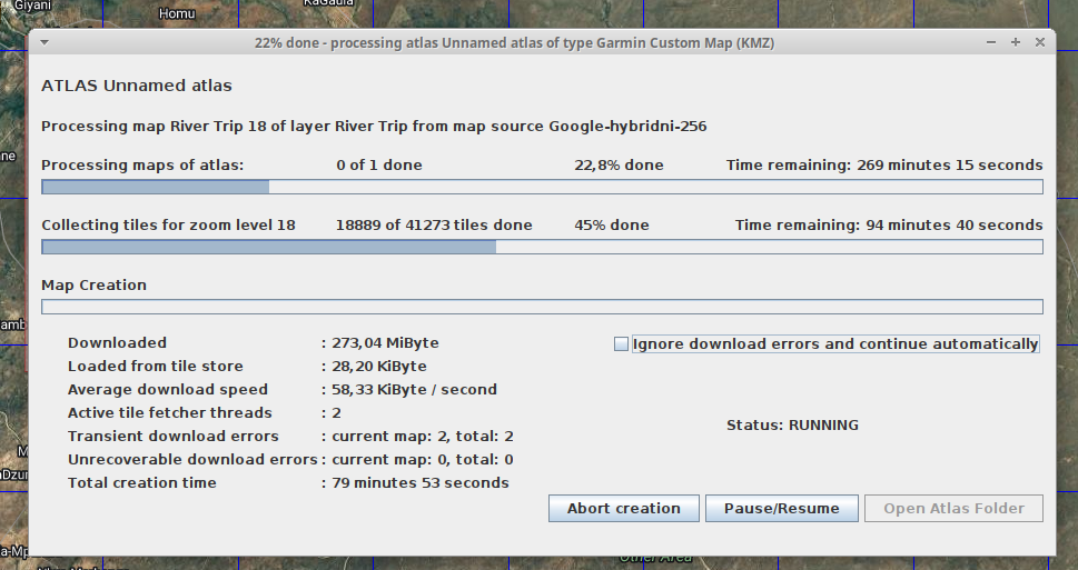

Usage is easy, but settings (especially the zoom level) will need to be customised according to the device you want to use (ie: screen resolution and similar). Simply select the area you're interested in, select the zoom-level, click on "Add Selection" you want and then generate the atlas. One caveat: you cannot have more than 500,000 tiles in a single custom map.
It may take a while for the map to be generated originally as the tiles need to be downloaded from Google. Subsequent runs (where tiles have already been cached locally) are much faster...

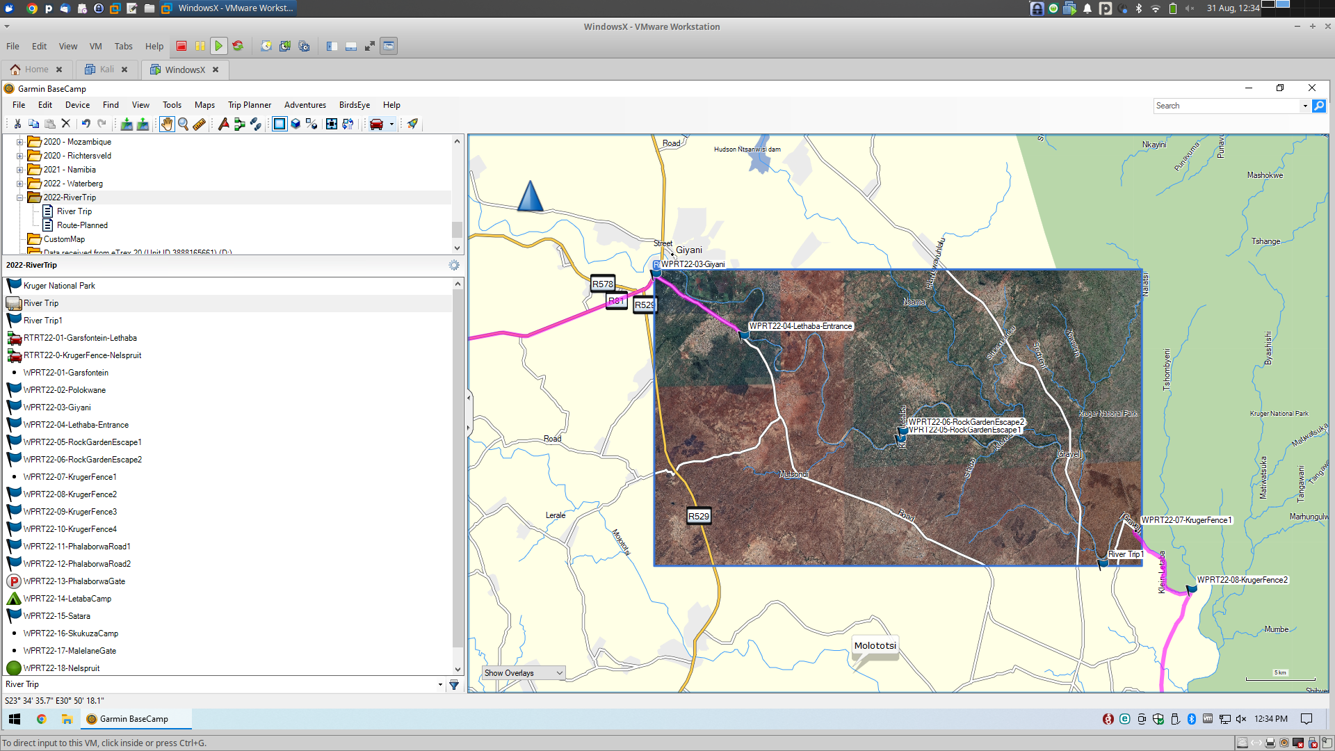

The custom map can be imported into BaseCamp, where you will have your "routable" map (ie: tracks4africa / whatever) with the map displayed in the background. Here's the section of the Klein Letaba in BaseCamp... :)

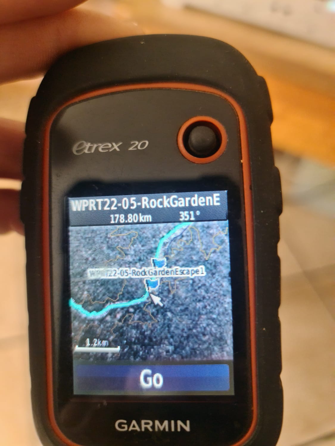

To install the map on your device, connect to a computer and copy the KML file generated by MOBAC into the Garmin/CustomMaps folder.

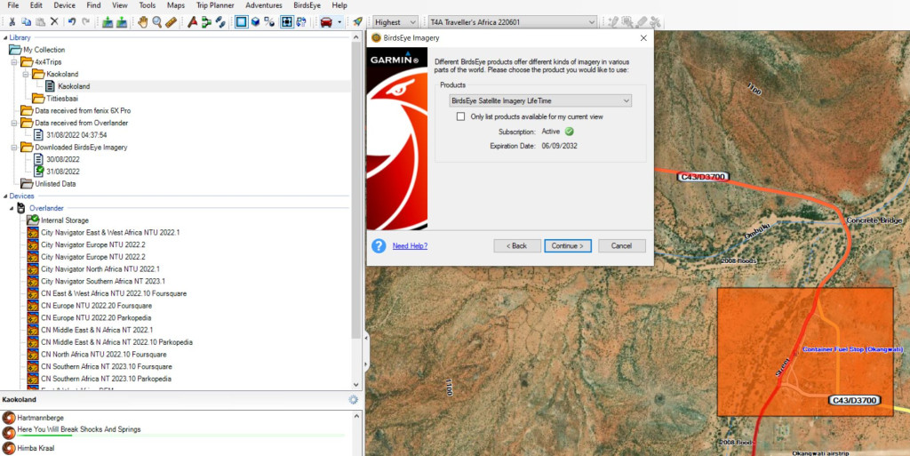

For those who are not so IT technically inclined, I finally succumed and bought the Birdseye Lifetime subscirption (not sure if it checks your age ;-). Very simple, but using BaseCamp, you can only download small blocks of high res data one at a time (<310 Mb). For my Kaoko trip, I have been downloading for 4 days now, but the resolution on The Overlander is spectacular. The annual subscription is R249, and I think I paid R800 for the Lifetime.
