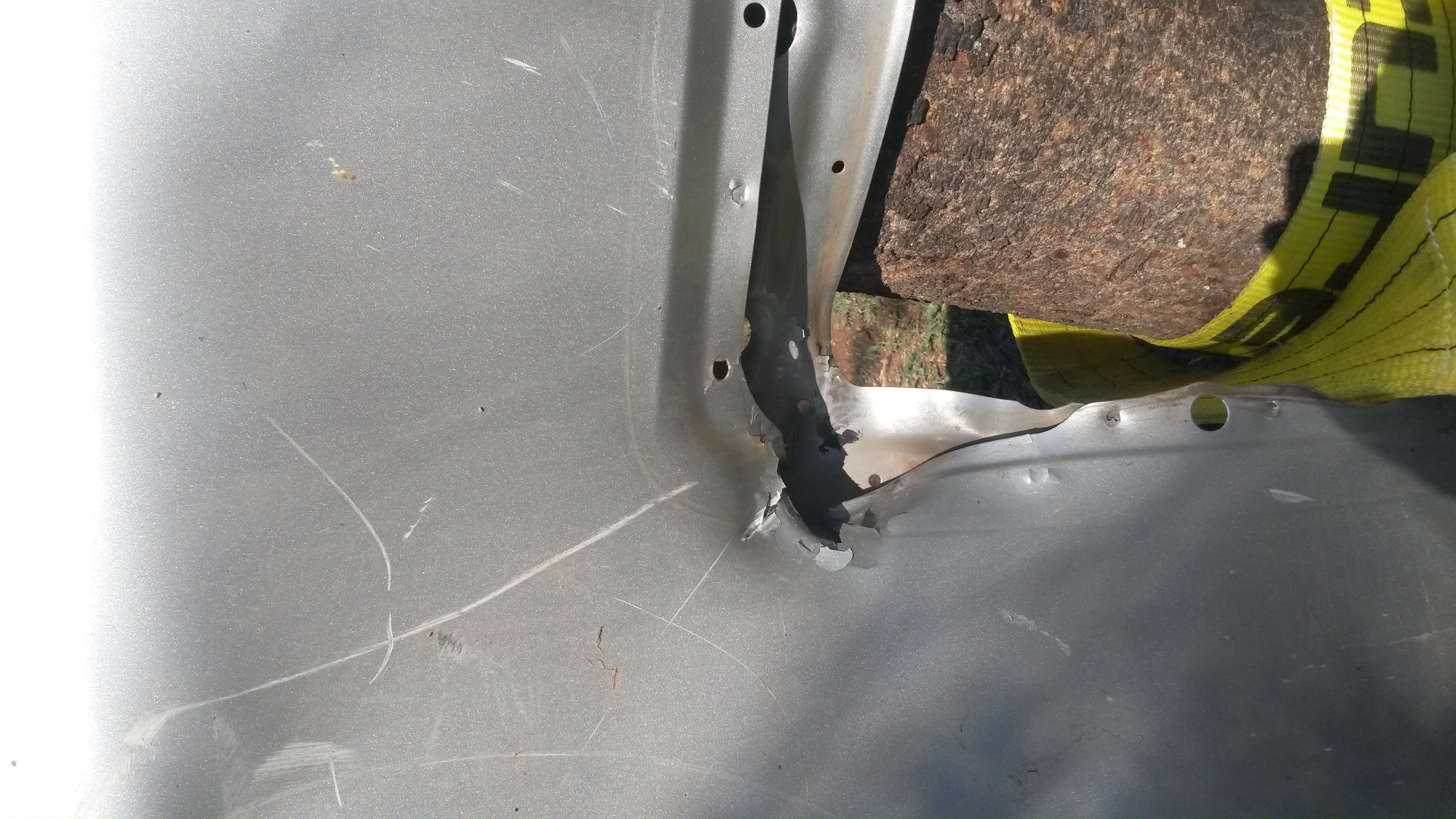

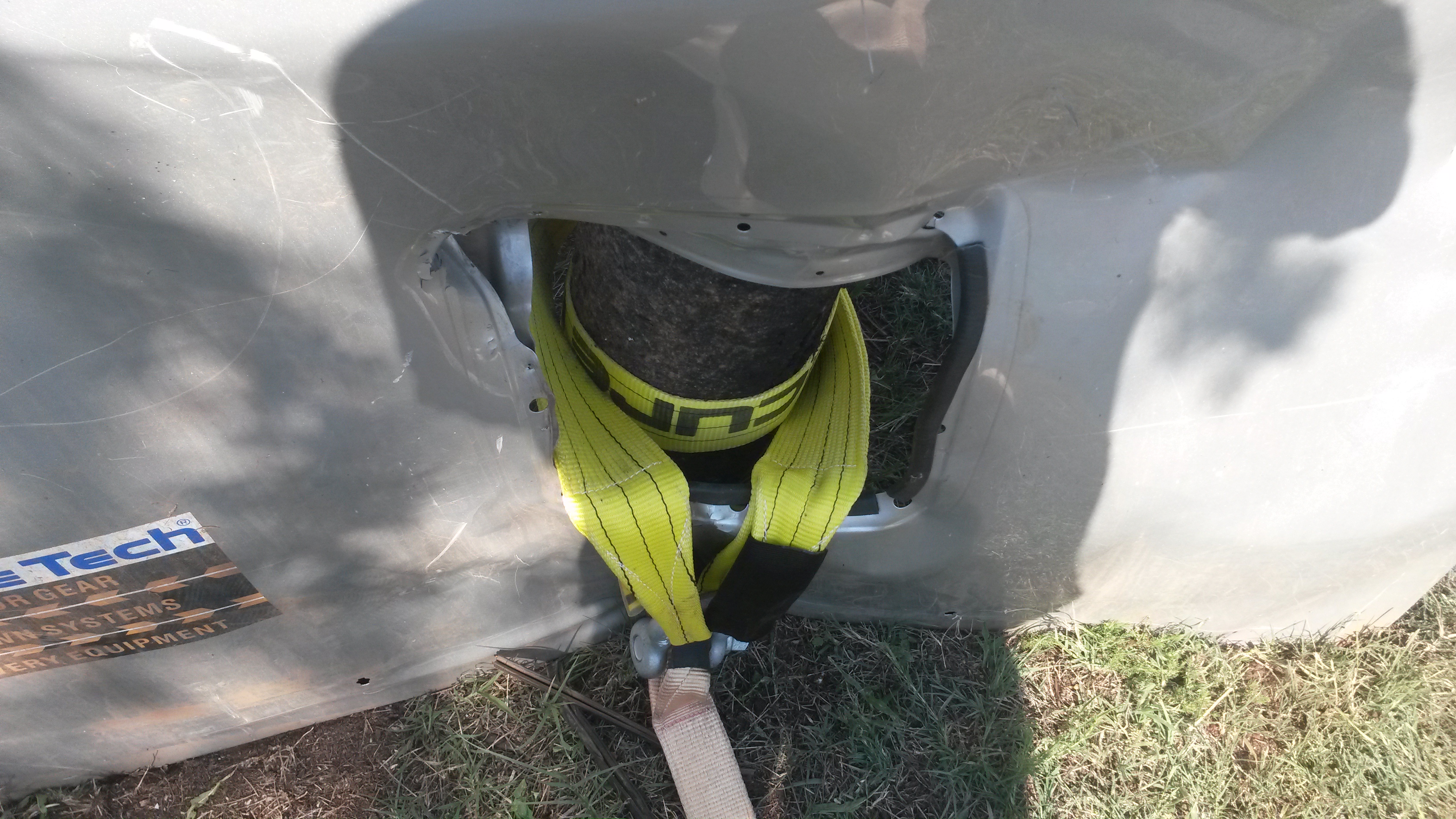

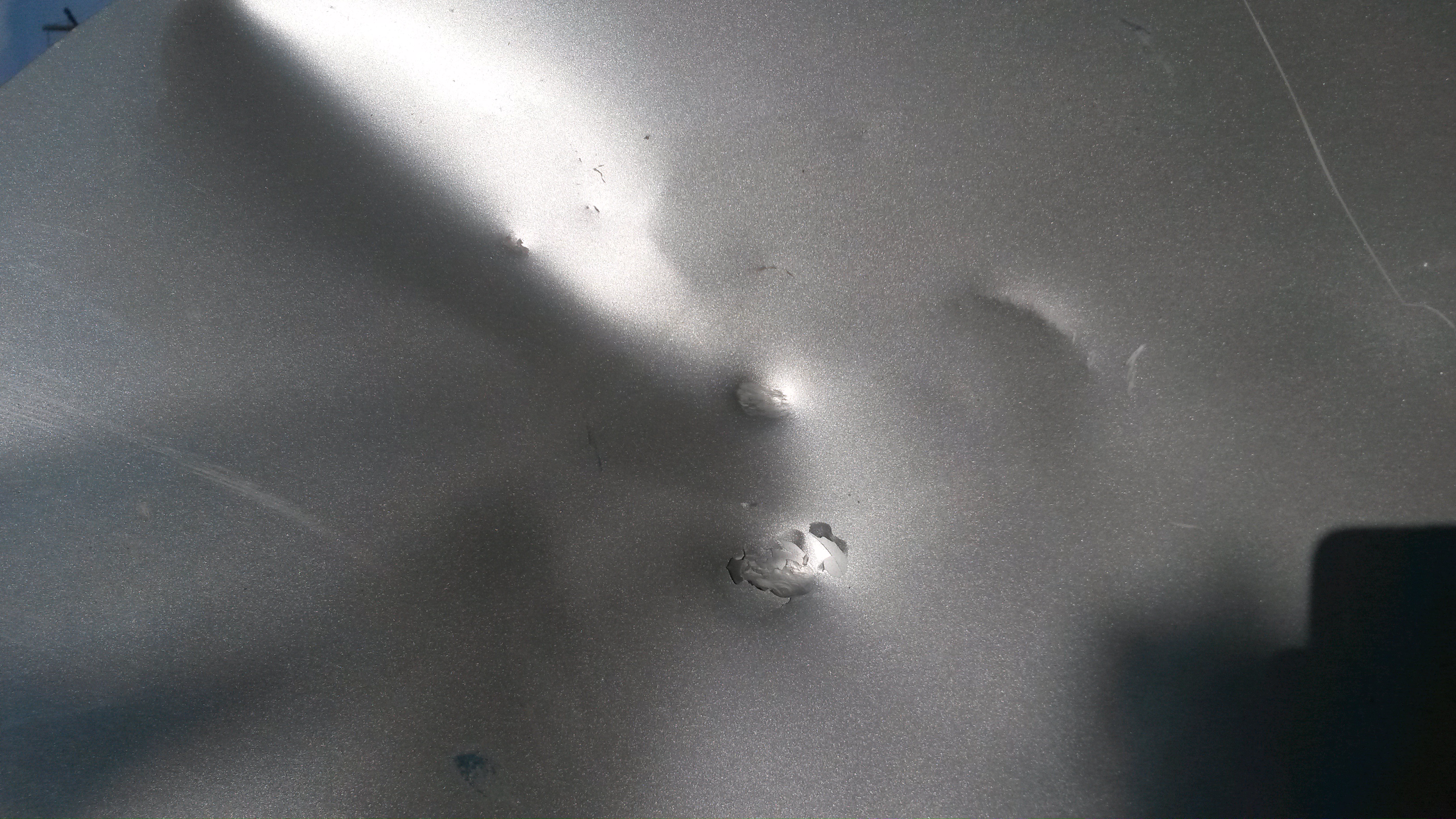

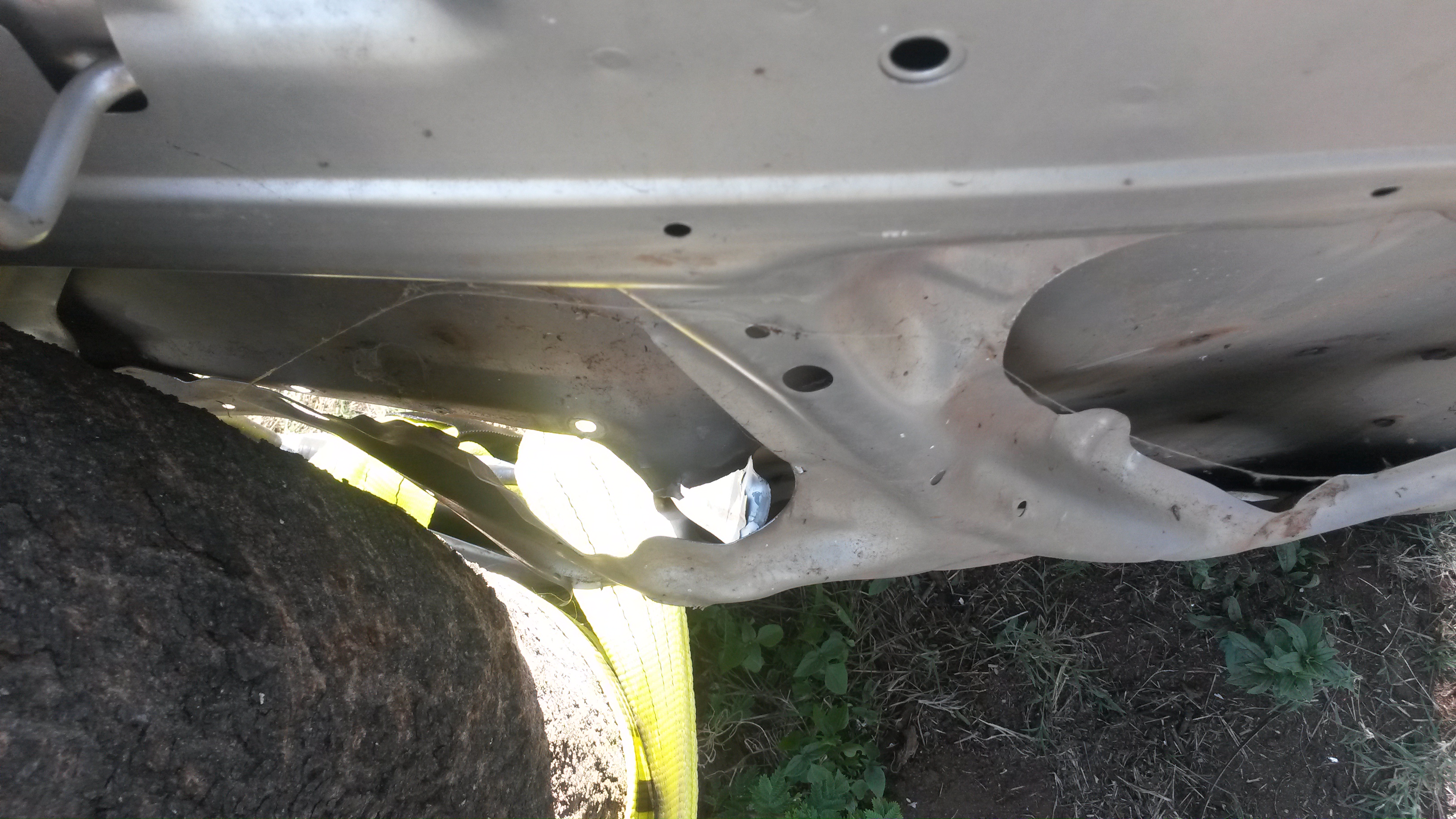

Back in 2014, the Nissan Club had (I think it was the folk from Secure Tech - or perhaps Glynn Demmer) perform a "failed snatch recovery demo" at one of the events. I think Cedric drove the Patrol tasked with performing the snatch. It took a few attempts. The "dents" in the bonnet in the images below were from one of the "failed-failed snatch recovery demonstrations". However the other images will show where the shackle went straight through the bonnet - the holes to the side of the intercooler vent.
In short, I've seen several comments on other sites sort-of-saying everybody would have been fine if the bonnet had been open. I say possibly.
