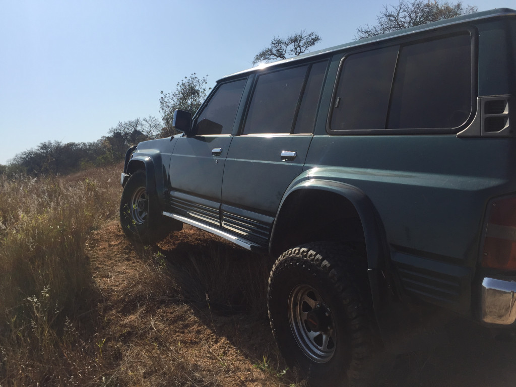

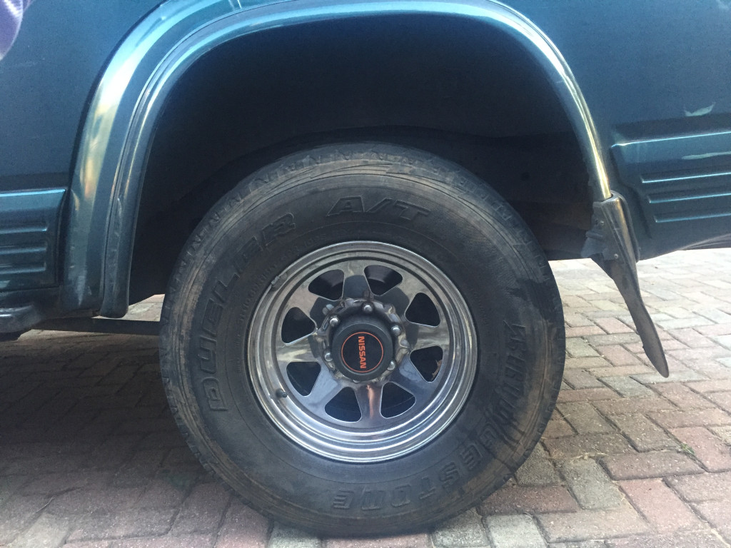

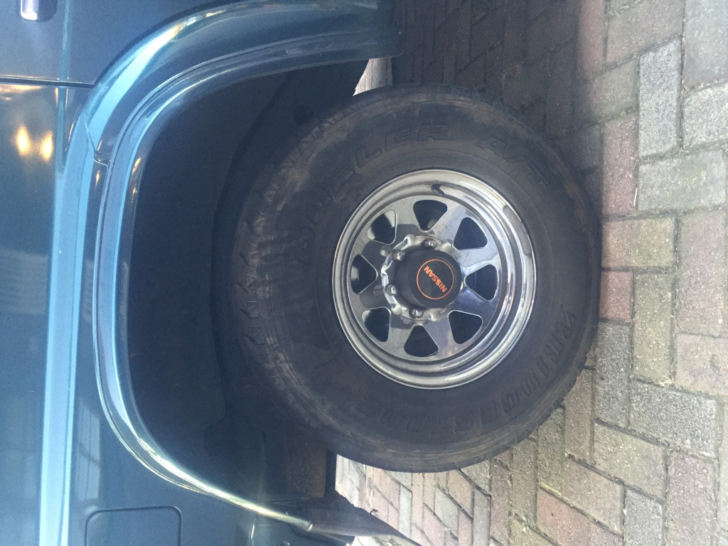

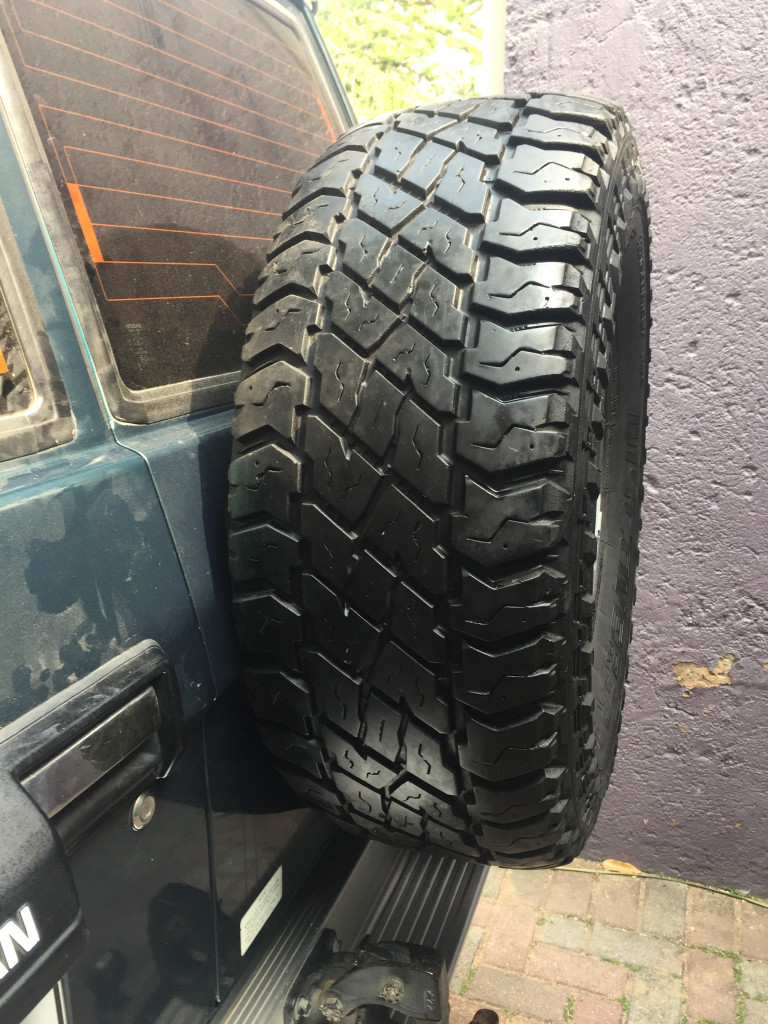

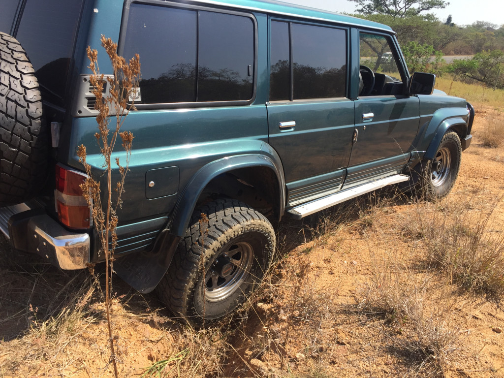

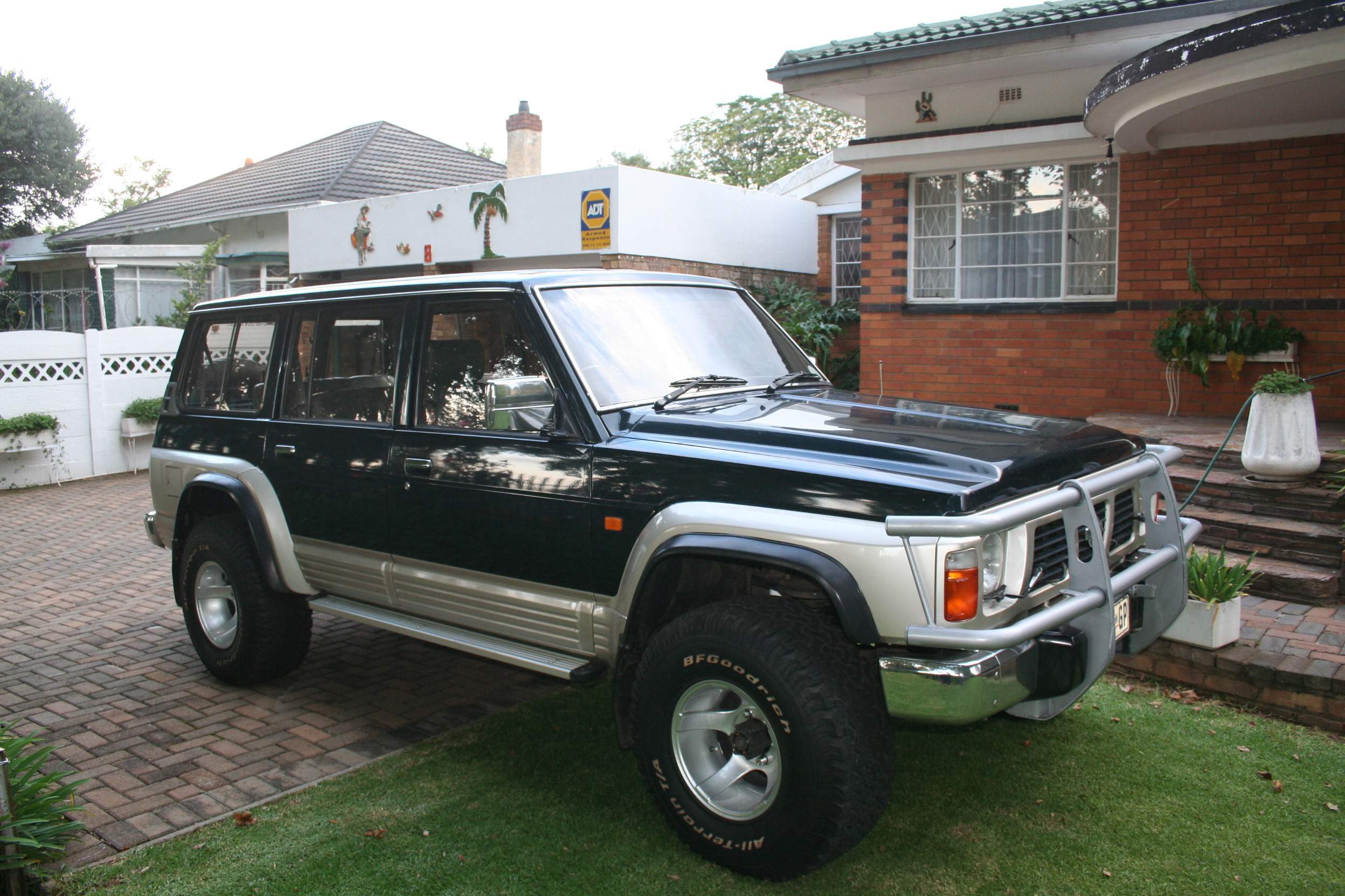

Pic of the worn 31x10.5r15 on my gq:

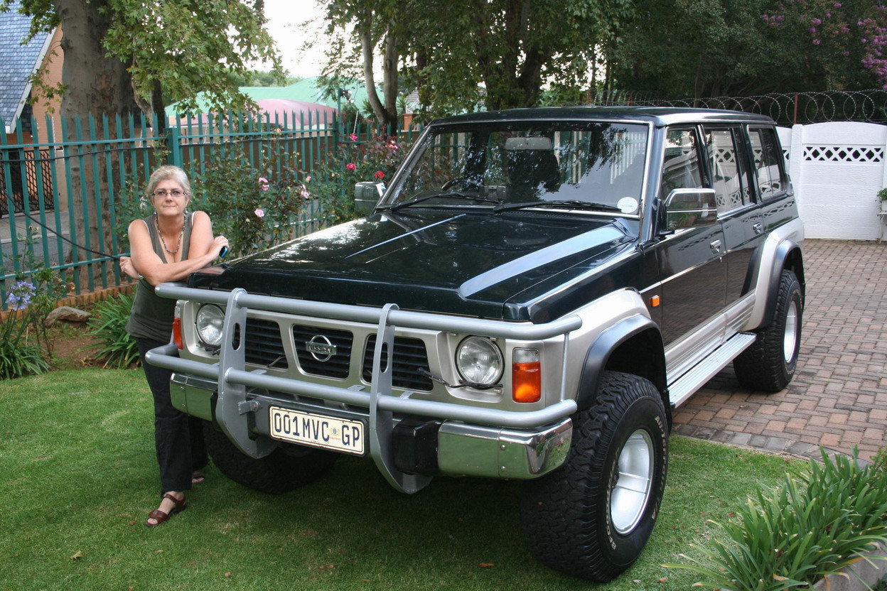

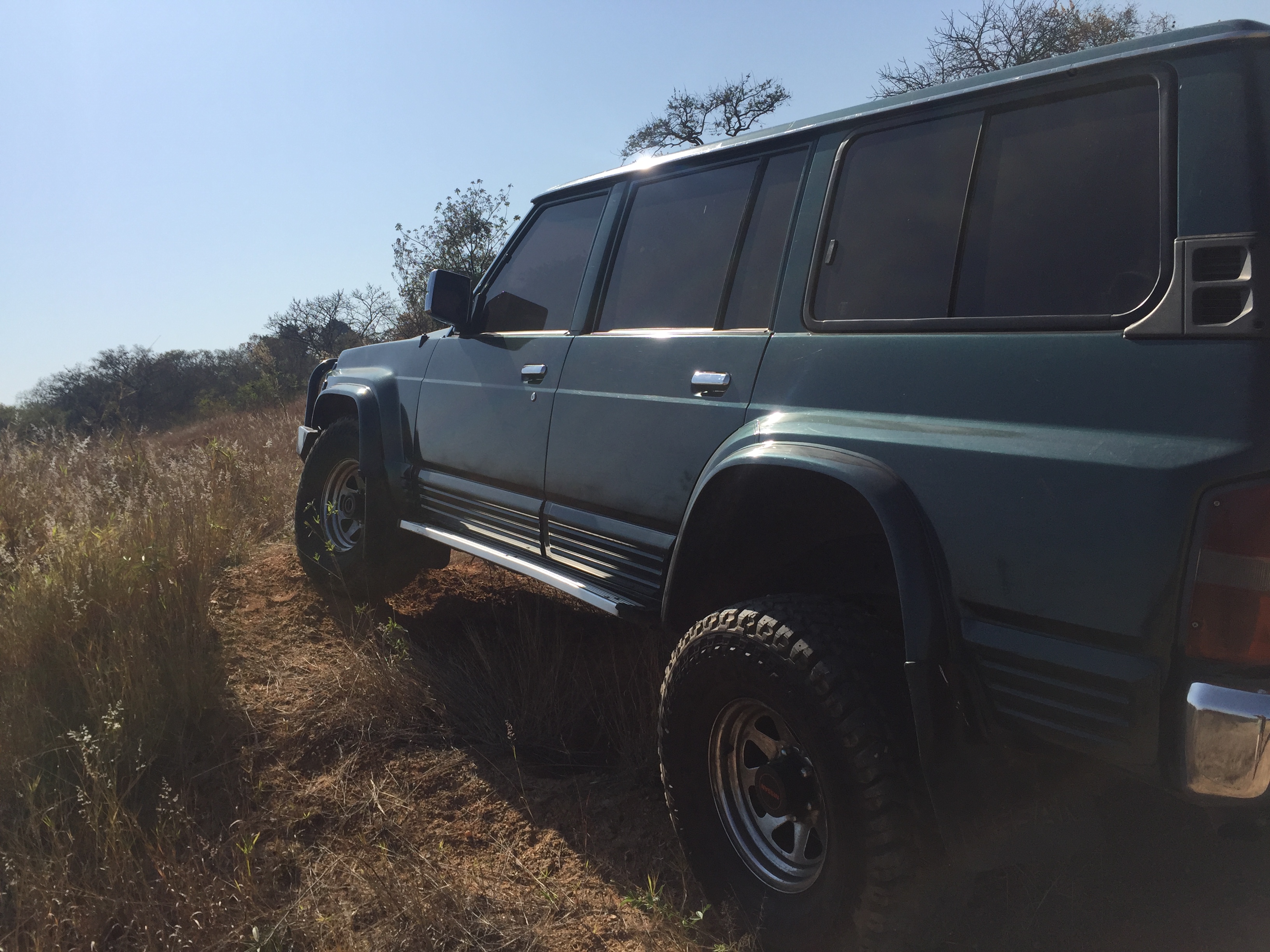

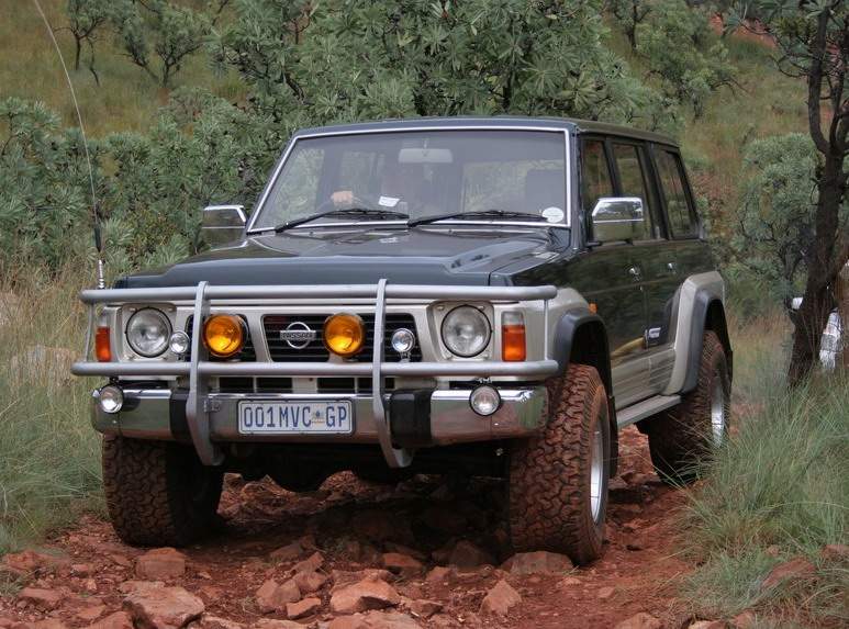

I fitted 12.5 33 R15 tyres on 10" wide rims on my 1995 GQ after lifting it 3 inches.
I was happy with the looks and tyres never caught.

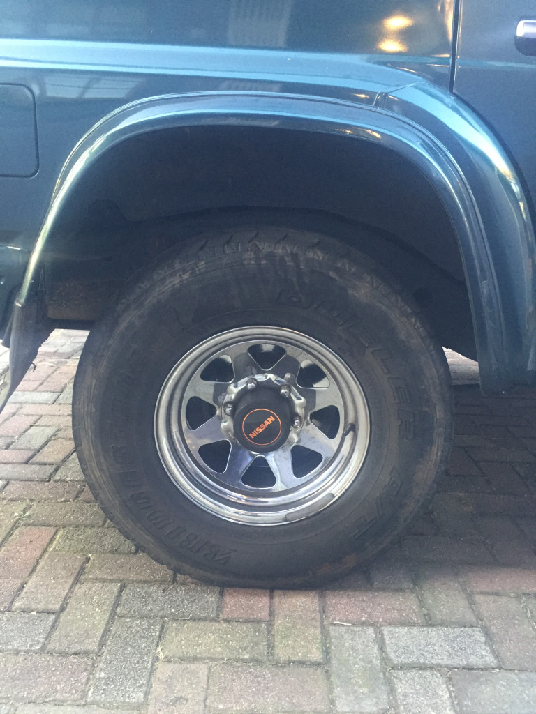

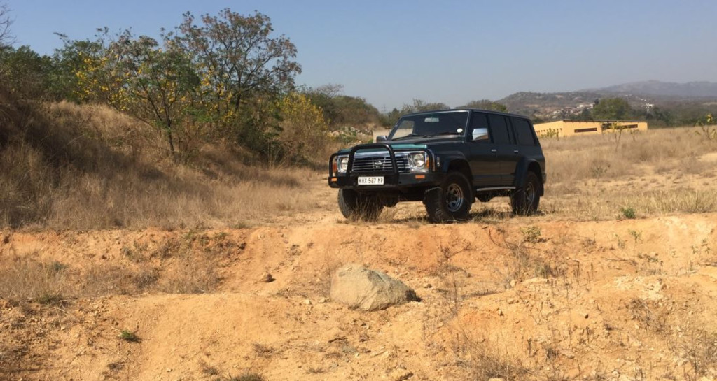

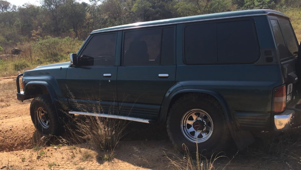

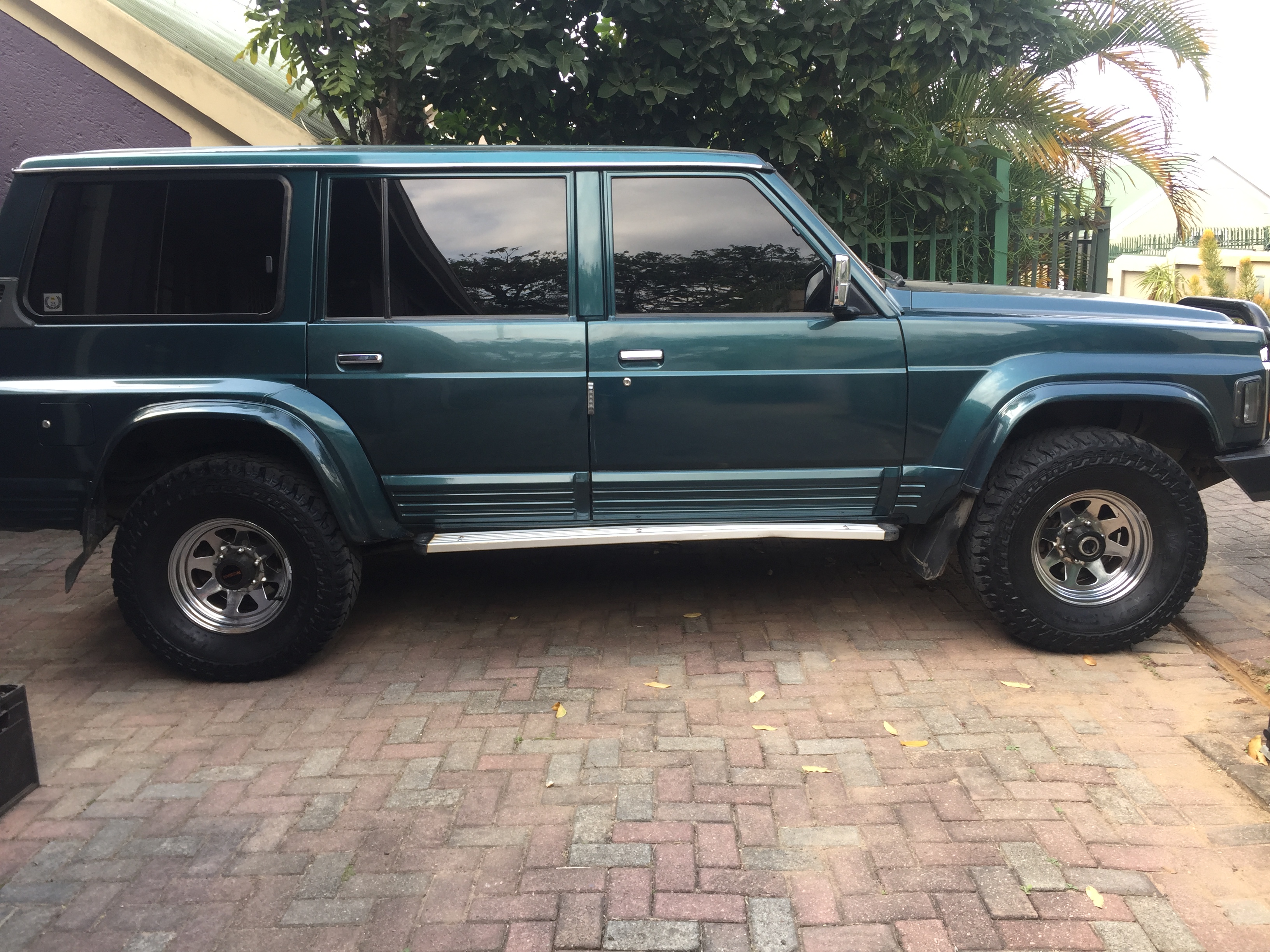

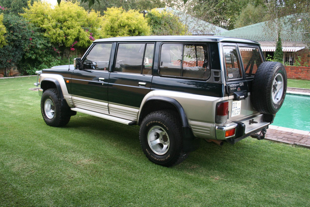

Another few pics of my GQ with the 31x10.5r15's:
(on 8" GQ chrome rims)

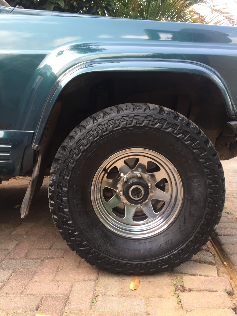

Re: What size tyres on your GQ?

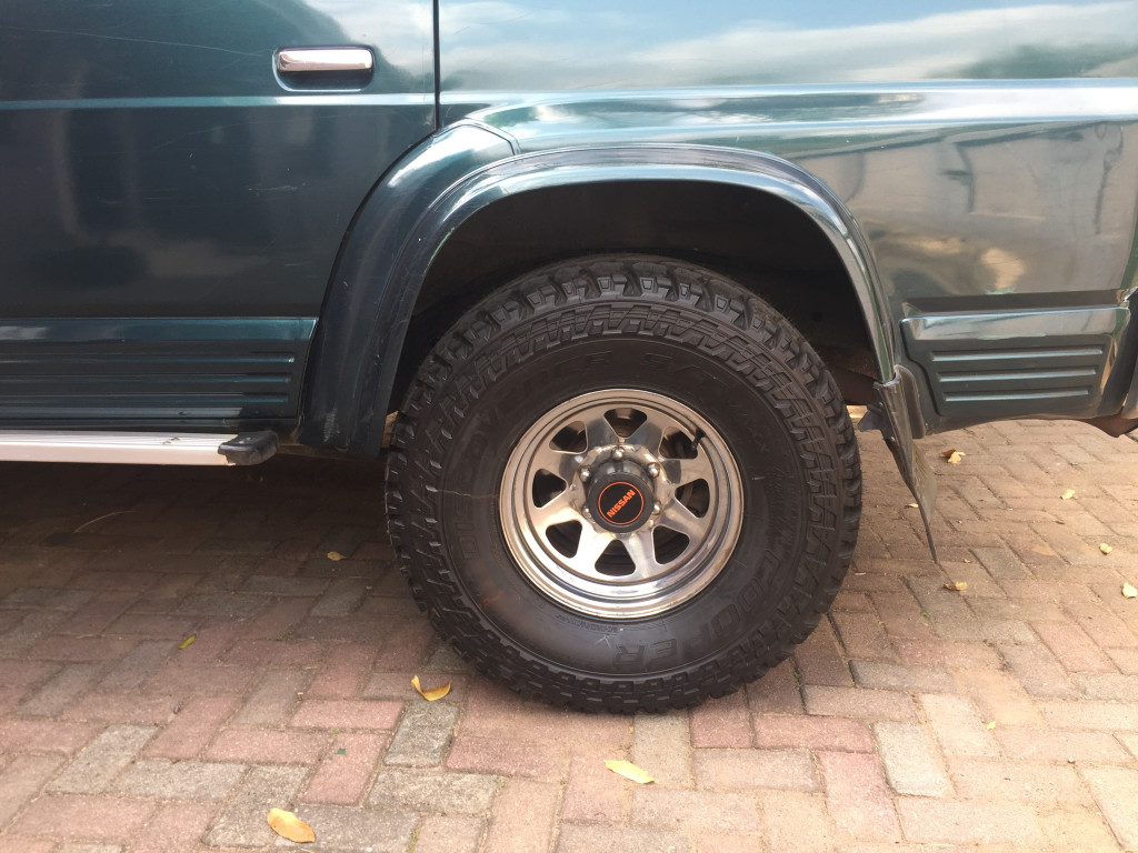

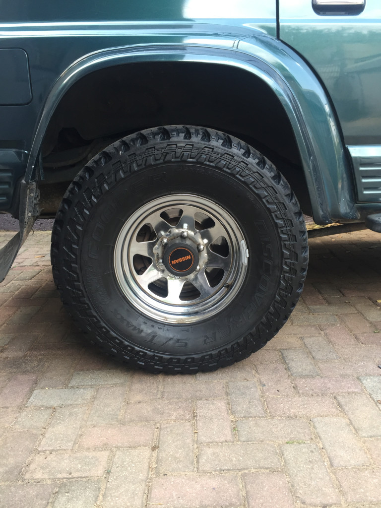

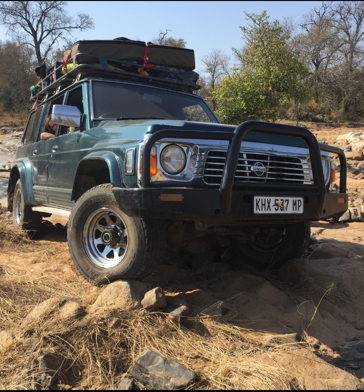

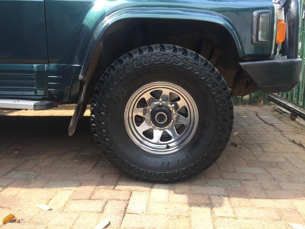

Here with 33x12.5r15 Cooper ST Maxx (on same rims):
Must say, the 33" tyres just look right on a Patrol :salute:
I read about 33" rubbing on full turn on mudflaps or even on extended wheel flares, but mine is not rubbing at all.
Must still test it while flexing...

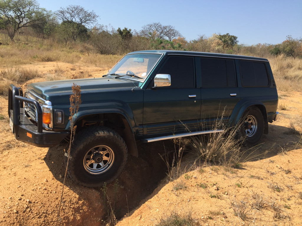

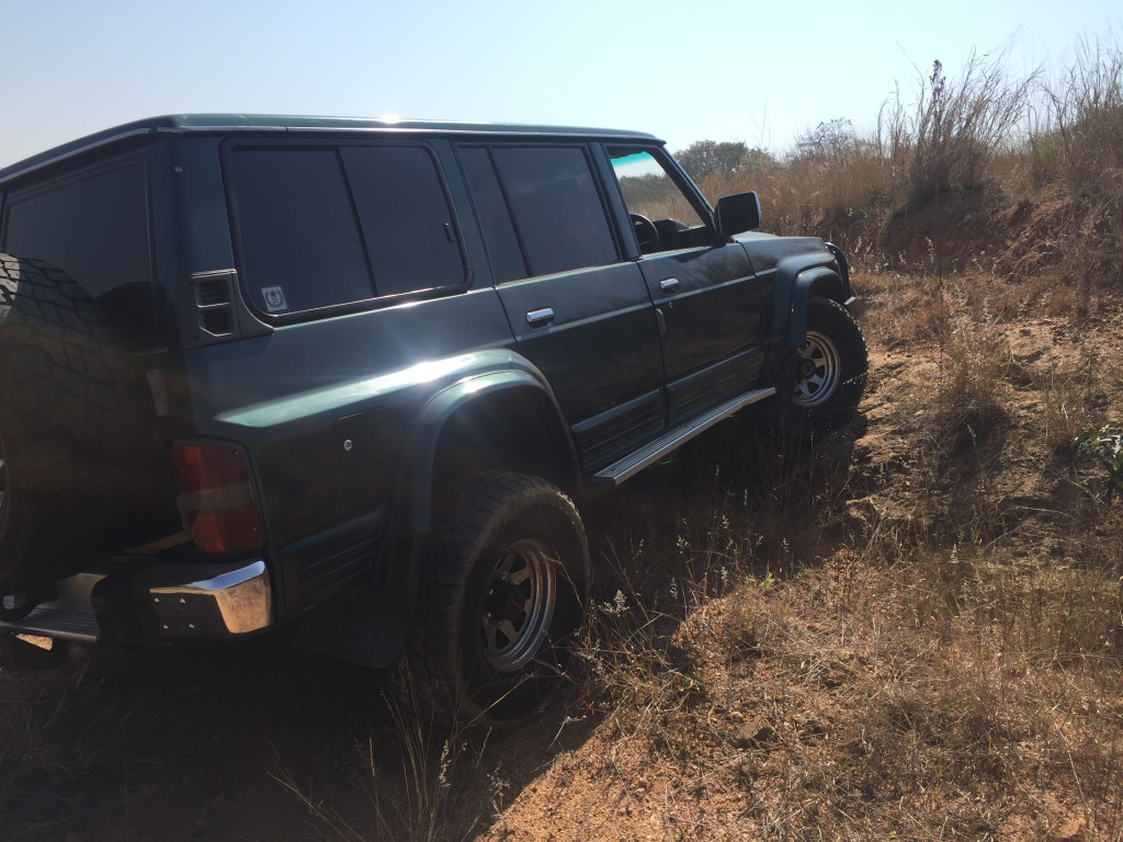

Posts: 3361
Has thanked: 246 times

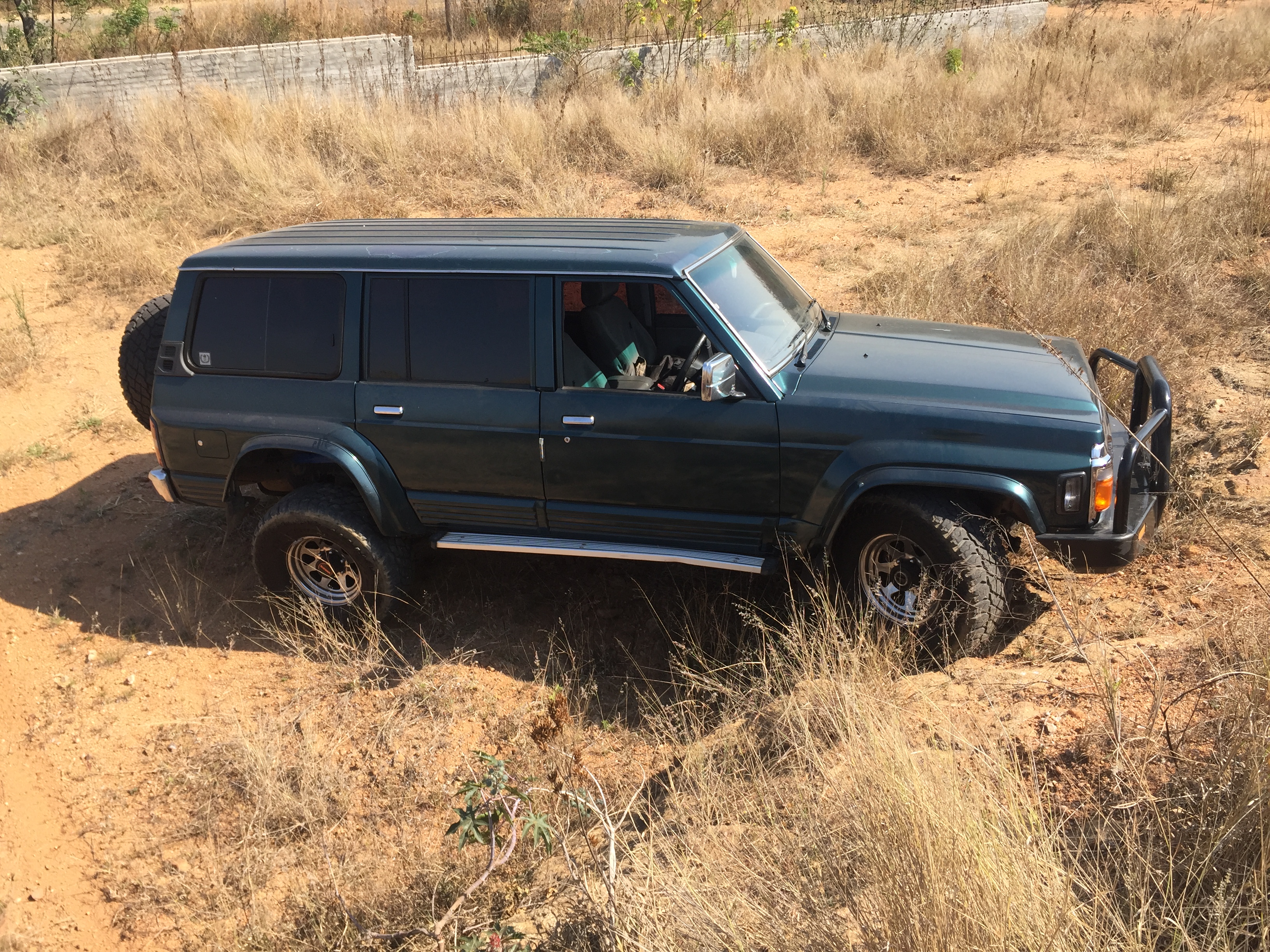

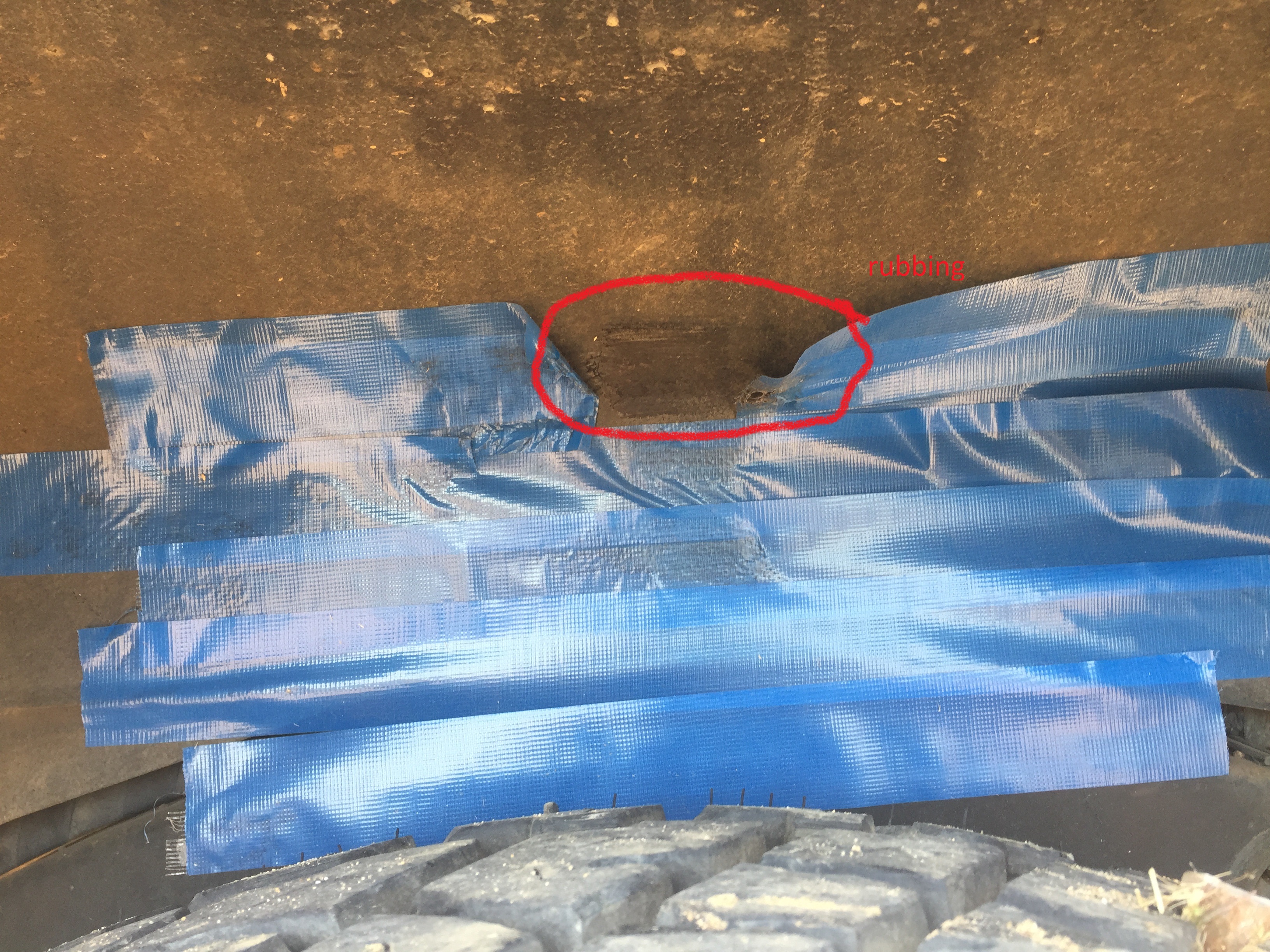

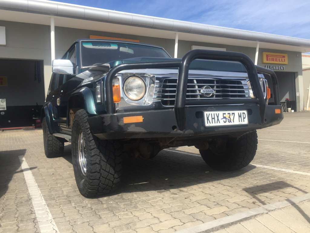

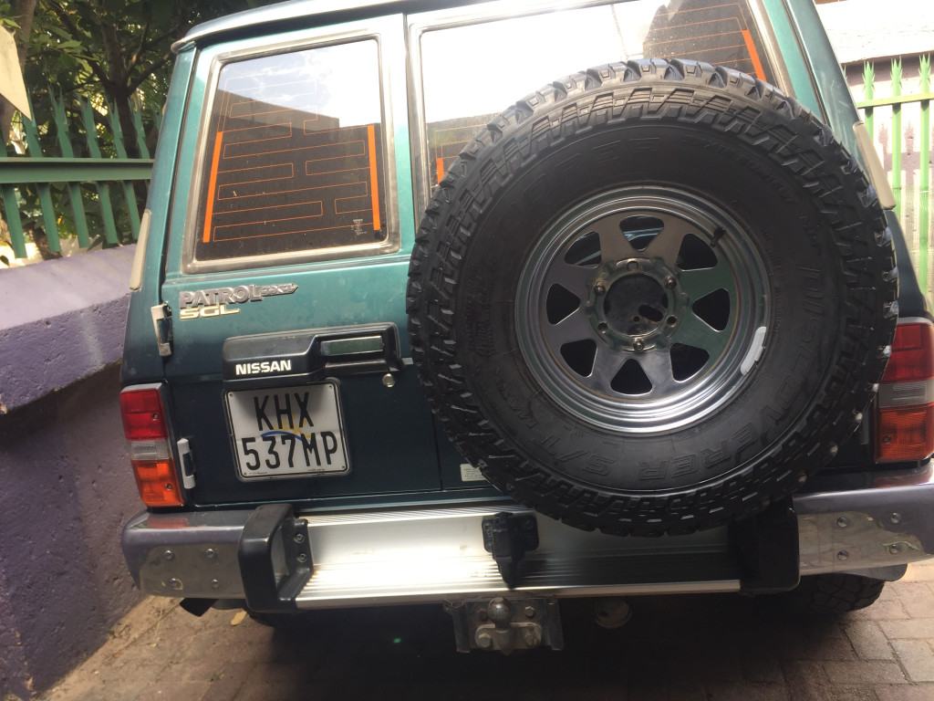

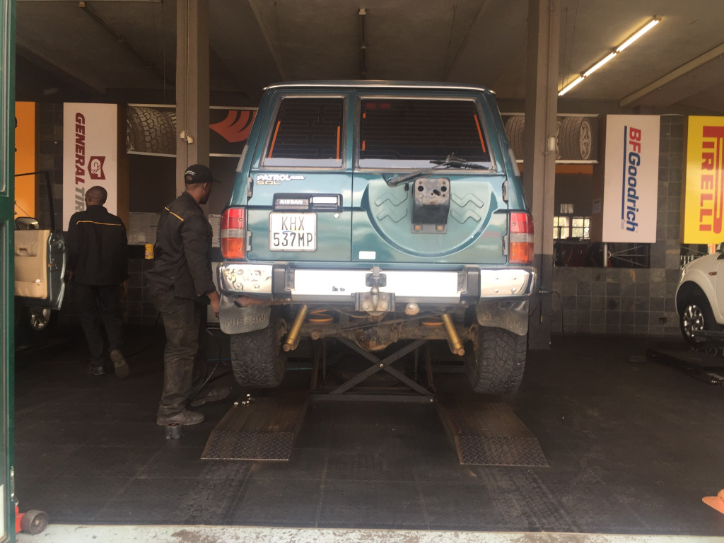

Went to test the tyres to see if they rub on full flex... (at a "playground" close to my house).
I got the new tyre on the rear left, which is the only tyre rubbing slightly at full flex. 6mm spacer will fix this :wink:
Must say huge improvement from the worn 31" duelers to the 33" st maxx's.. one crossaxle i drove previously, I had to use locker, this time no locker required.. :blonde:

Did you have to use a spacer on your OEM Rear Door Spare Wheel Mount?
What off-set are those 8J GQ wheels?
