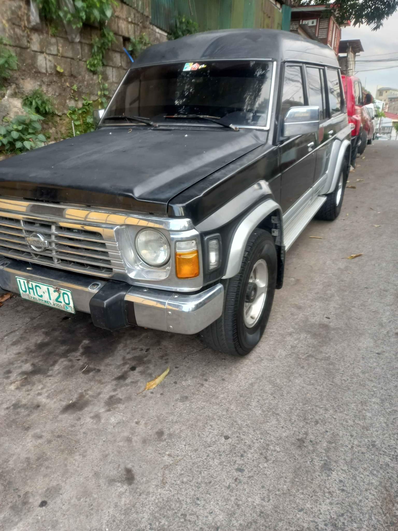

Hallo,
considering this 1996 patrol safari td42 naturally aspirated.
manual
160,000 km
locking diff
5,500 usd
slight rust beeing from Philippines.
Anything to look out for? Seems like too low mileage for age.
Cheers
manual
160,000 km
locking diff
5,500 usd
Cheers

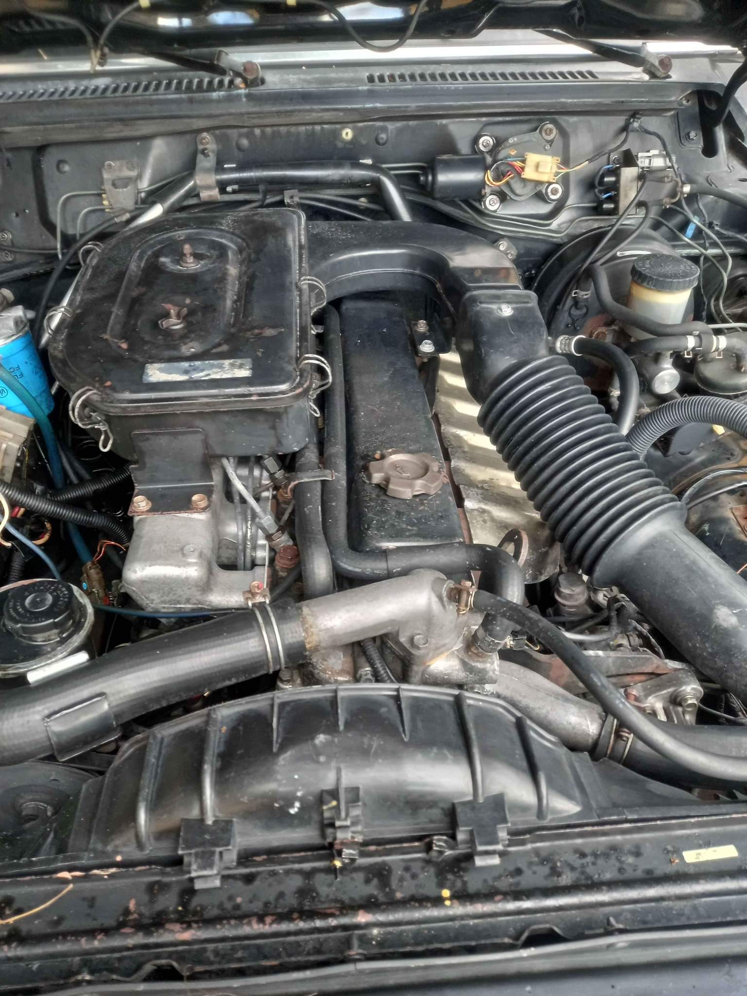

One thing that worries me from the photos posted is cooling system corrosion. You can see some of it on the thermostat housing. Makes me think the car has been run without anti-freeze for a while.
The TD42 is a very reliable engine but it is finnicky about the cooling system, and overheating can cause cracked heads. I would check that cooling system very carefully before purchase, and also perhaps do a compression test.

Took a look see at the ride. Here's what I gathered.
-head gaskets where replaced due to leak( worries me from what was said about the cooling sys3)
-compression was spec
-at idle there was sharp high pitch clak clak clak sound, is this worrisome?
-at revs the above sound was gone
-overall was smooth with power
-shocks or bushing shot loud clank on down stroke
-exterior 5/10 faded light rust
-interior 7/10
walked away with a good feeling. Felt strong and the ref can keep the beer cold.
Any thoughts.
G
-interior 7/10
Any thoughts.
G

As I mentioned earlier - I'm not really a diesel expert. But I'm sure the oil burner people (cough-cough) will be here shortly...
Some of this sounds fairly normal. I know the diesels can sound very "tractor-ish" at low revs. For peace of mind regarding the replaced head gasket, you can perhaps have the coolant analysed. Not sure what facilities are available over there, but most radiator workshops around here will be able to detect the presence of exhaust chemicals in the coolant. This is a nice way to know that the head is not compomised.
The loud "clank" on down stroke - I presume this is when the vehicle is articulating ? Could be suspension bushes or perhaps even a cab mount. Was this front or back ?
Re: Too good to be true
The clank clank at idle, without actually hearing it, is kind of normal. These are noisy motors to start with, but when under load the "clank: becomes more of a direct injection diesel sound. The "clank clank" could possibly be improved by having the rocker clearances adjusted. This is a little time consuming to do, but not overly difficult. I can't off the top of my head recall the gap size, but its best to do it when the motor is "hot", but without burning the hell out of your hands. Once set it's kind of done for the next 300 000 km.... haha... and that give loads of time to drink the cold refrigerated beers.
Bodywork can always be repaired. It just depends on how much money you want to spend.
What did the coolant fluid in the radiator look like? If brown and unclear, then that is a sign of not having had antifreeze/coolant added to the water, which is not ideal, but if the water is tinted from the antifreeze/coolant and clear, then it sounds like it could be a winner. It's so difficult to offer an opinion cause it is always an unknown on the honest actual history of the vehicle.
Keep us posted, and if you need the specs for any settings on the motor, or any info really, there are manuals here on the forum that will help you with everything. here is the link - viewtopic.php?t=7667
