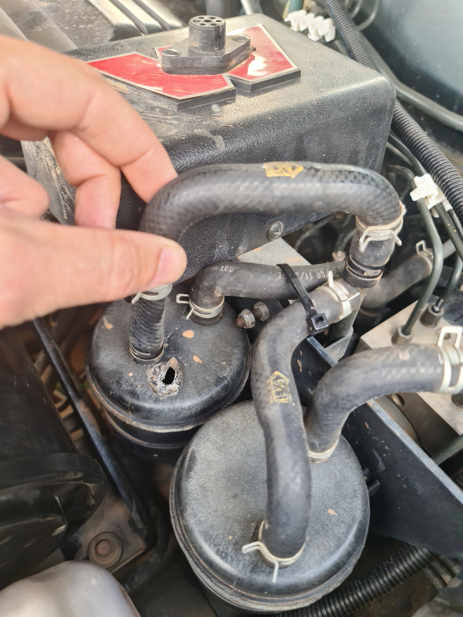

In any case, the one pipe on the left-hand pod was broken off. There was an indication that it must have been repaired quite recently, based on the glue at the base. As I mentioned before, I'm not going to dwell on that.
I stuck the pipe back on using super glue after which I gave it a liberal dose of epoxy. This has worked - the clutch is fine again now. Anthony has a spare vacuum pod for me, and I'll collect it at some point and install it.
I think the only thing I'm confused about is that although my clutch was very stiff, the brakes were totally unaffected. And yet the various diagrams I've seen on the TB45 motor indicates that the brake booster should run off the same pod as the clutch. This makes no sense, so I'm going to have to see exactly where the brake booster vacuum pipe is connected. Perhaps it runs from the other pod ? I shall investigate this at some point in time.
This is a photograph of the broken pod.

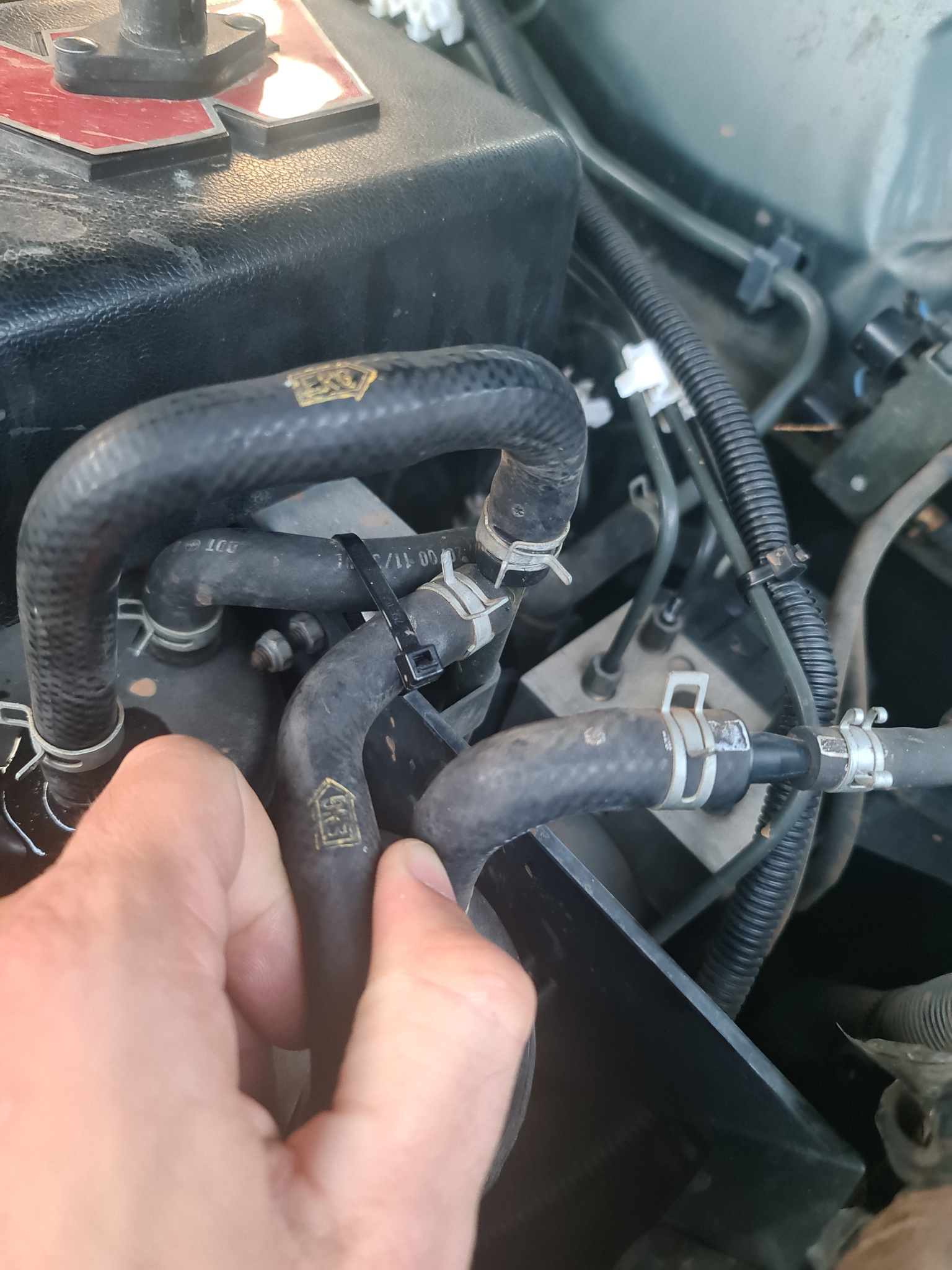

And this photograph should illustrate the non-return valves on the rubber pipes. The yellow arrows on the pipe indicate which way around the pipes should be and there is also a visible thickening of the pipe at these locations. These thicker bits are the non-return valves. If you remove the pipe and blow through it, you will only be able to blow through it in one direction. One can also note the liberal amount of epoxy around the broken pod in the background of this photo...

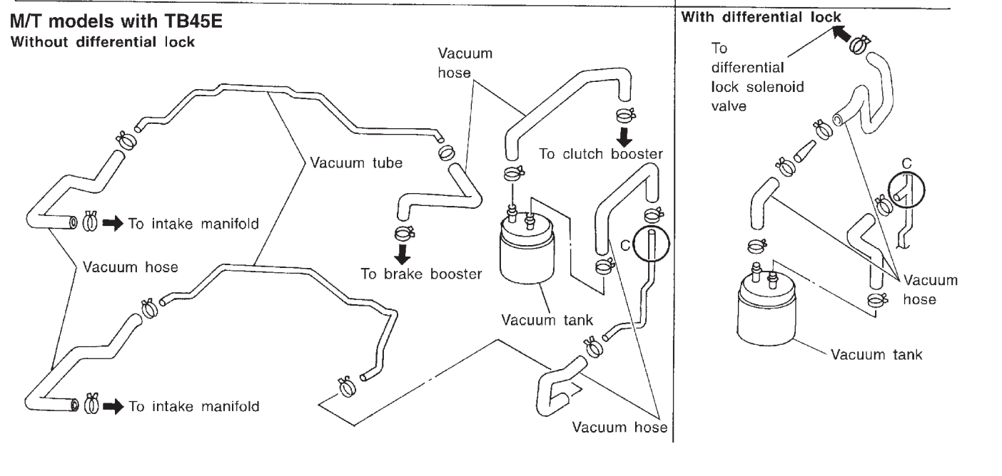

Just for information. The reason why the brakes were not affected by the vacuum leak is that they do not run via the vacuum pods. The brake booster gets its vacuum directly from the intake manifold as per the attached diagram.
