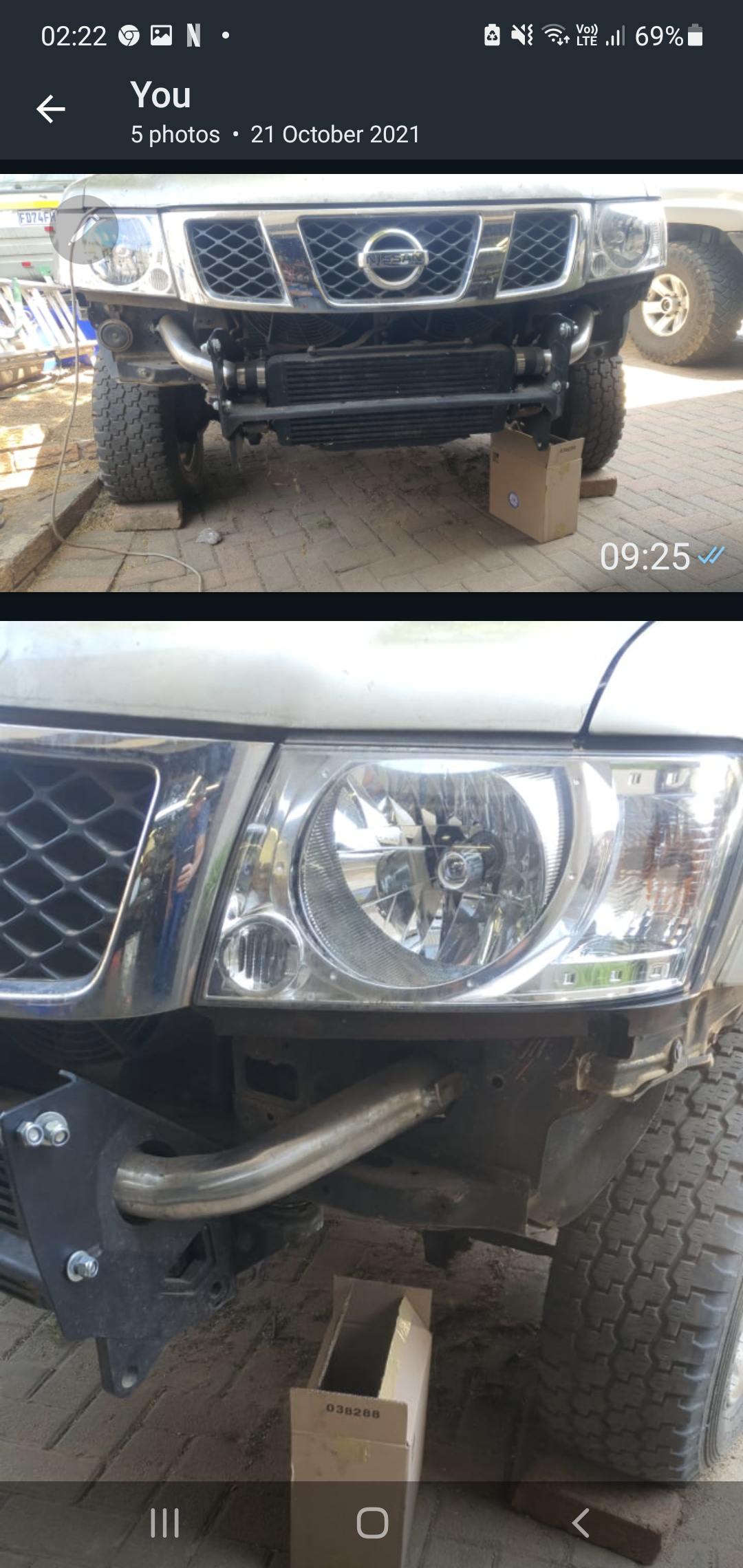

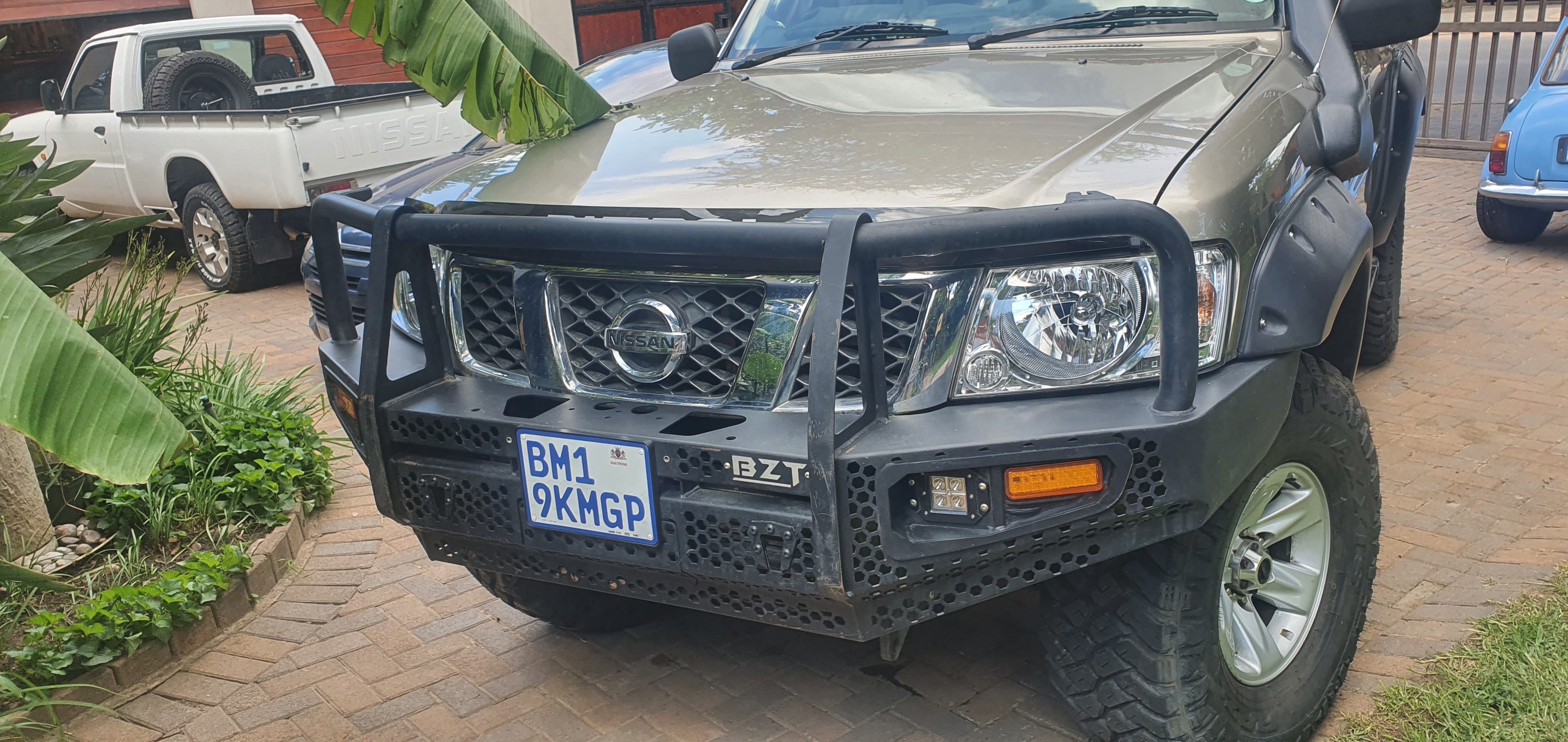

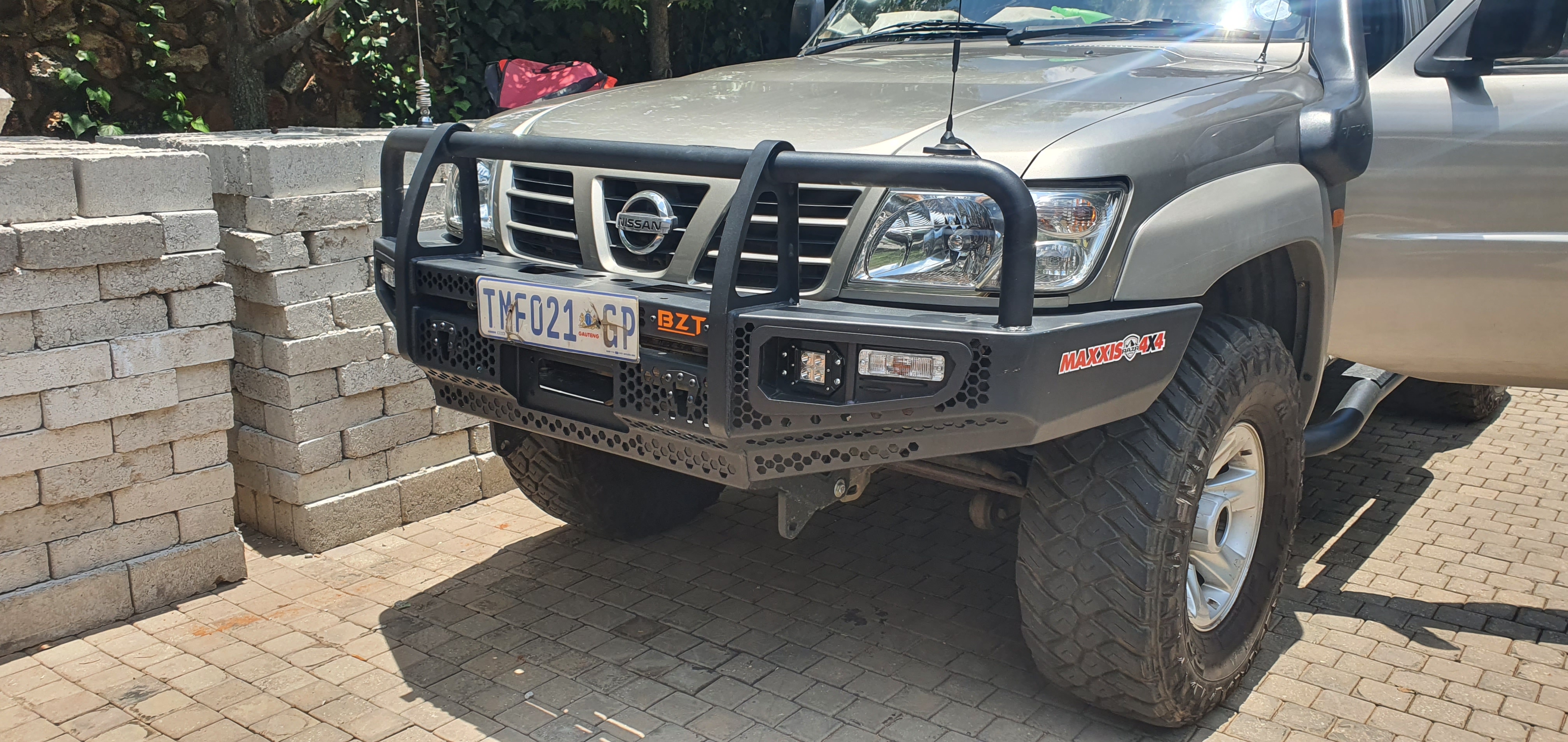

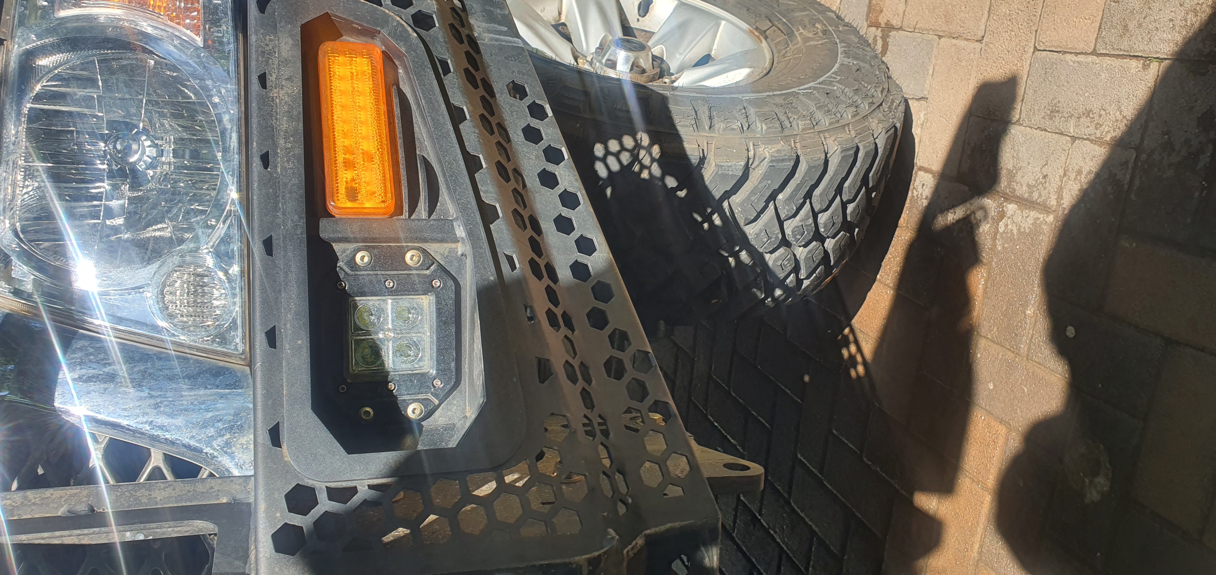

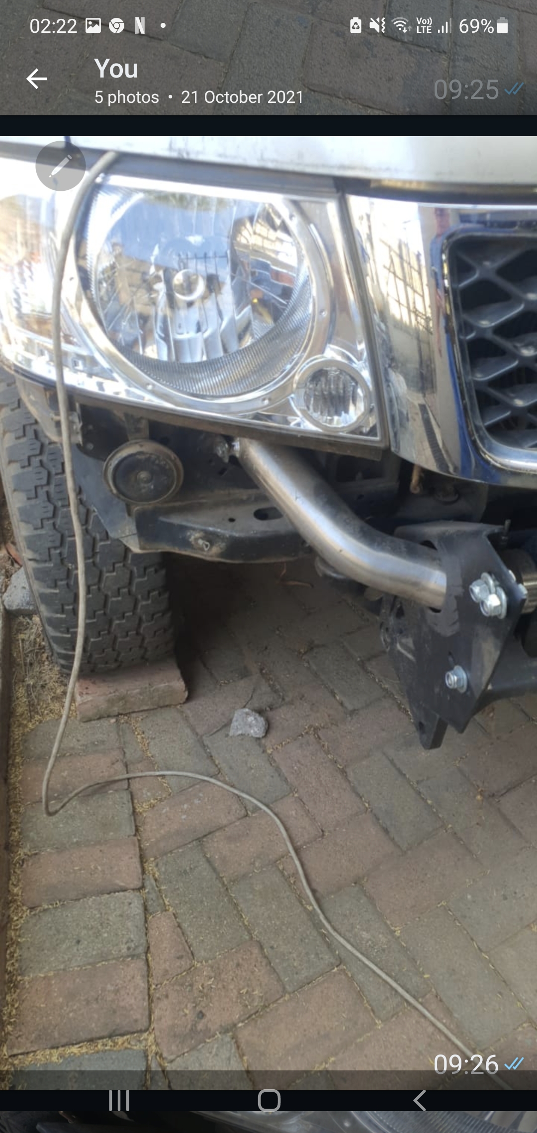

on both my bumpers i allowed for airflow under headlights so that coolers can be fitted away from aircon and radiator to not give more heat to water .On my suv i dropped my front intercooler way down below the winch plate so that the heat doesn't bug the radiator .
Re: oil cooler plans on the TD42t

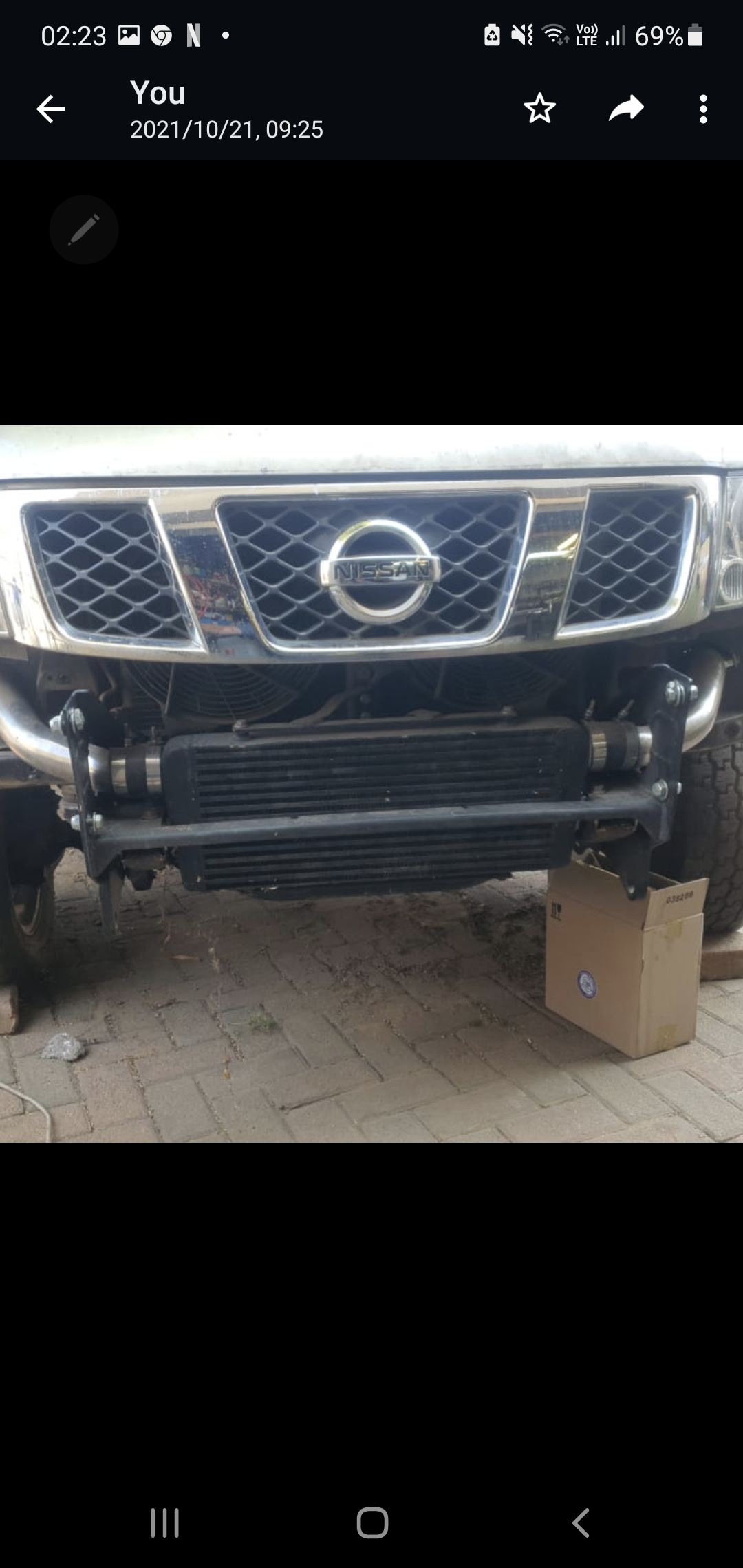

Here you can clearly see how low the cooler for the air is sitting and that it is under the radiator . I also took the bottom crosmember form a 2010 td42 Na suv and changed my radiator to a nissan original core with allu tanks top and bottom that is the wider tipe like the 30l and 4.2 na and 4.5 uses . this allows intercooler heat to go below the car radiator and not make it hotter
