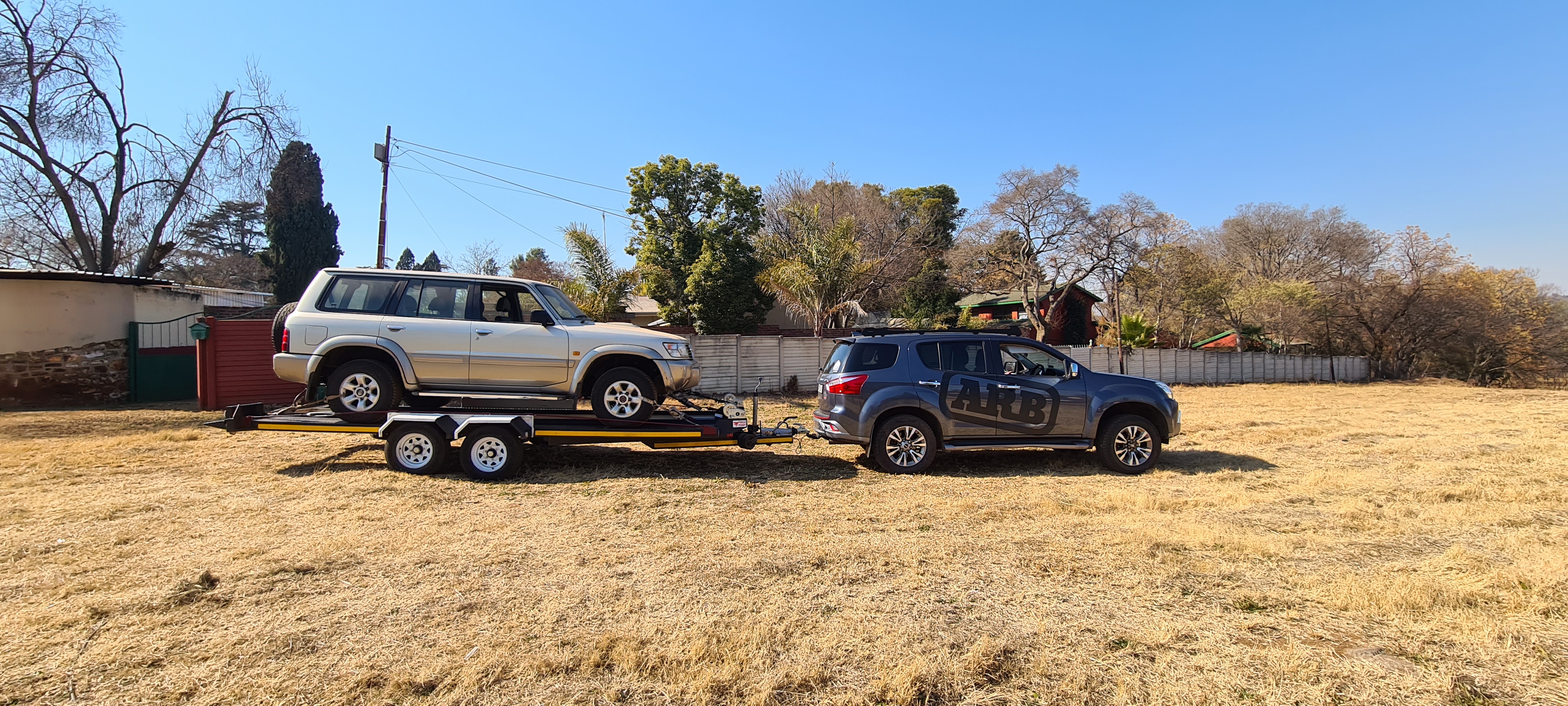

The collection
- 20210731_101823.jpg (3.1 MiB) Viewed 12416 times

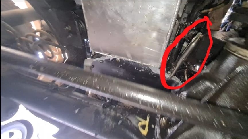

Re: Speedy se toer trokkie
So this was how the engine looked. The original sump was blanked off and a new hole was cut into the block to build a sump away from the diff. Apparently bath silicone was on special that day and a vice grip included to sweeten the deal. No wonder the whole undercarriage was soaked in oil!
- IMG-20210723-WA0163.jpg (48.79 KiB) Viewed 12416 times

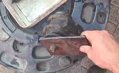

So when we finally pulled the engine, this was the next horror we found. I refer to it as the engine mount spacer bracket. The easy backyard mechanic way of moving the engine mounts 5cm forward without the need to make new engine mounts. In a way I am very glad I pulled the engine and redoing everything. This whole setup was an accident waiting to happen! This past weekend she went in for her new engine that will be prepped and installed the right way to ensure everything works properly from the start.
- Screenshot 2021-08-30 091021.jpg (30.92 KiB) Viewed 12416 times

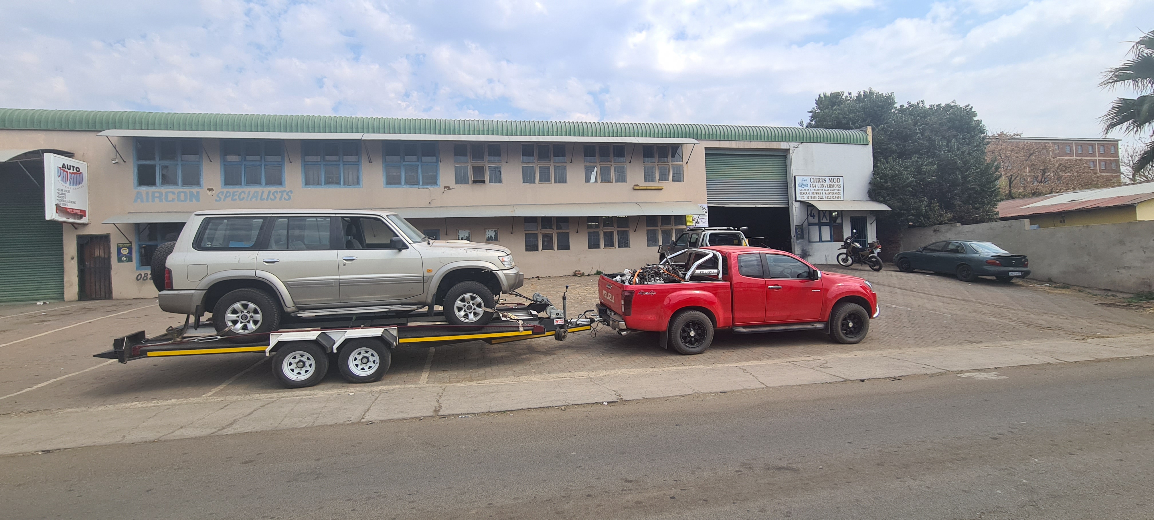

Dropping her off at Chris Mod 4x4
- 20210828_110530.jpg (1.98 MiB) Viewed 12185 times

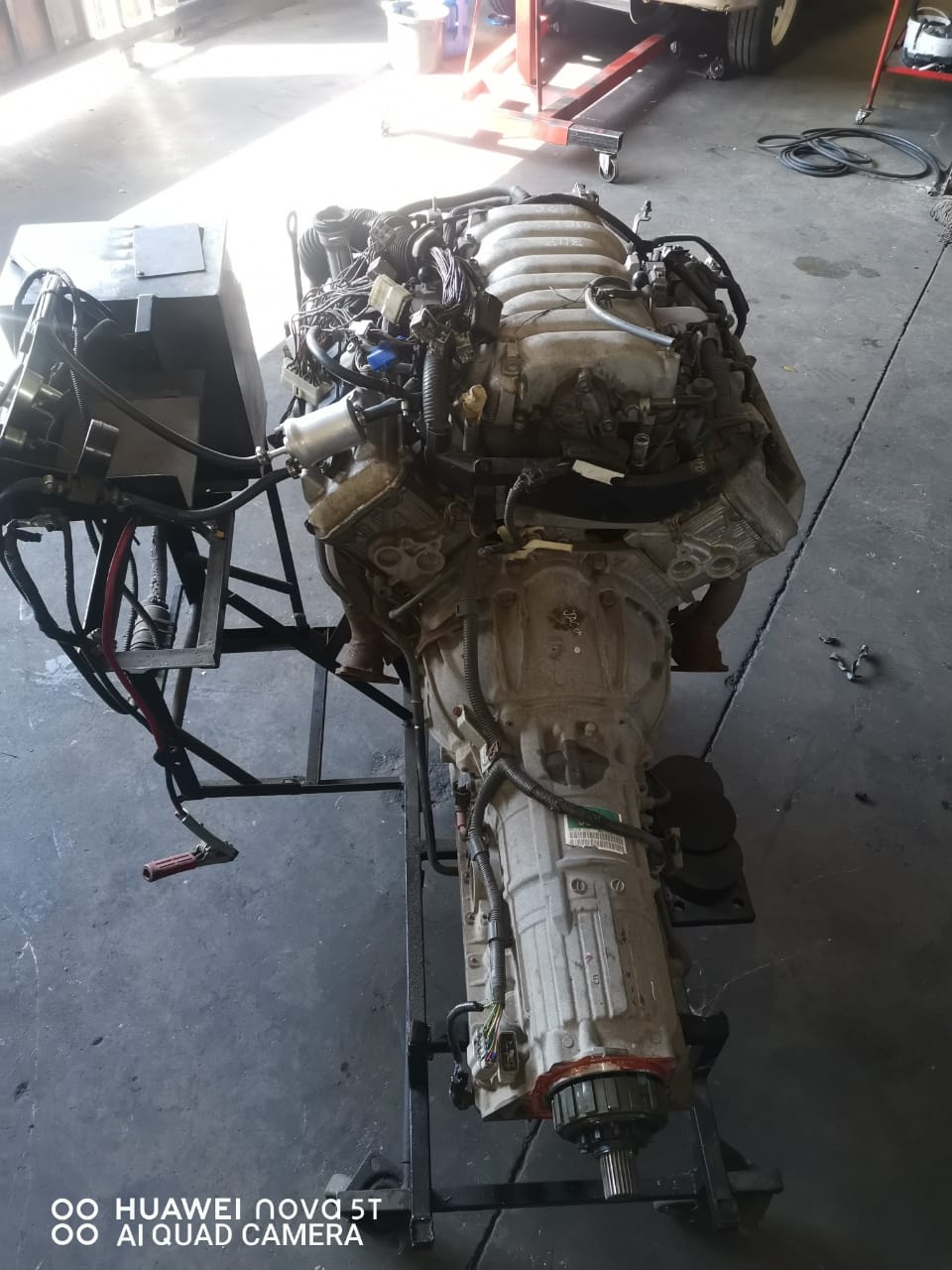

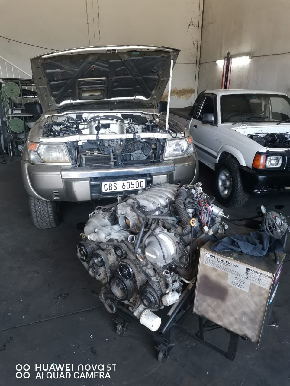

First step for Braam is to bench start and ensure the engine runs smoothly before stripping and prepping
- IMG-20210830-WA0040.jpg (150.05 KiB) Viewed 12186 times
