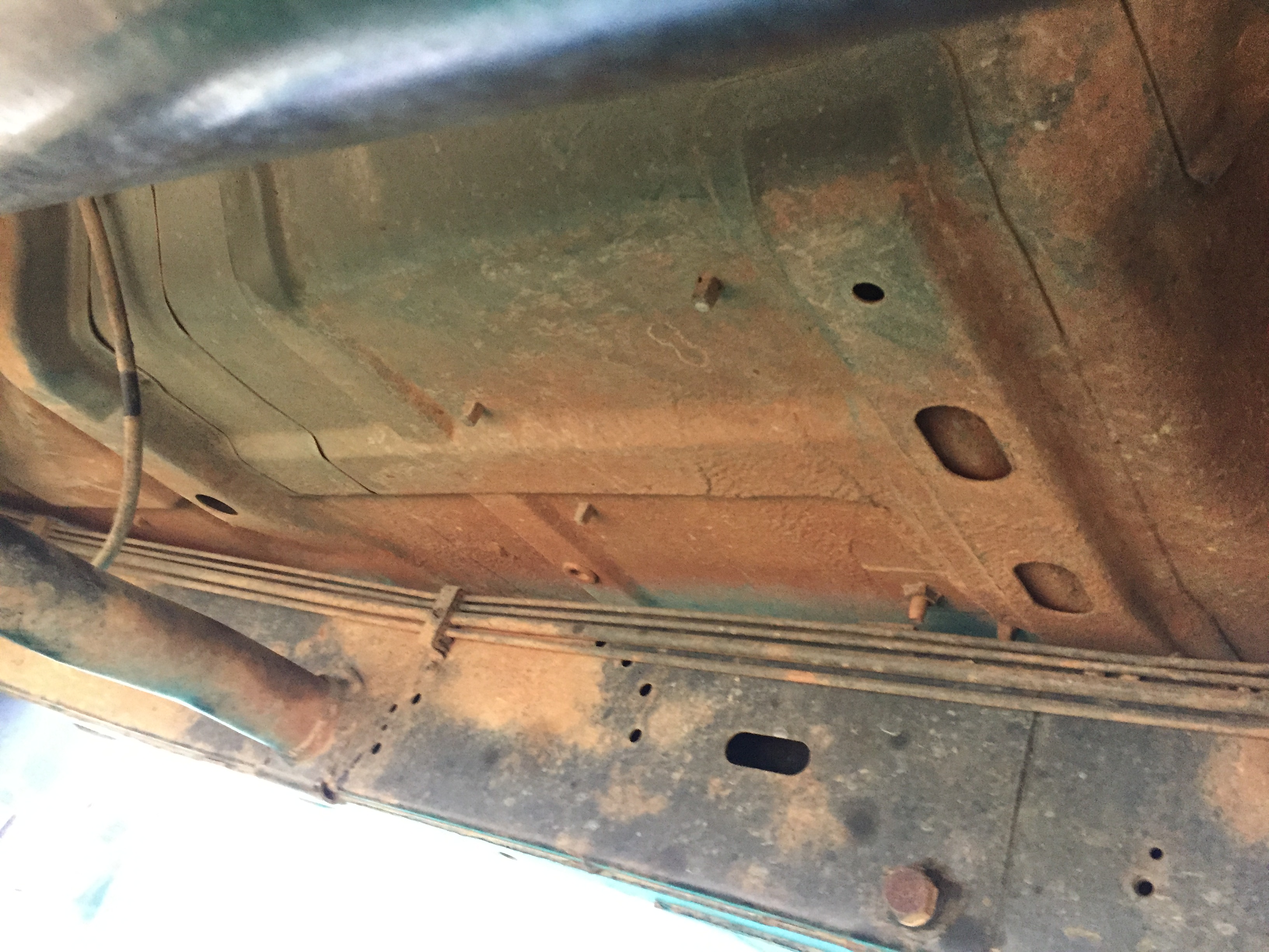

Lyk nie of daar veel plek vir sub tank is nie...sun tank is seker nie baie “diep” nie.
Posts: 2867
Has thanked: 193 times
Been thanked: 275 times
Re: GQ sub tank installation options
Kyk Frydag hoe pas hy.............. 40L
Posts: 6157
Has thanked: 1134 times
Been thanked: 1044 times
Myne is 60l en hy is geluk met die chassis rails onder.
