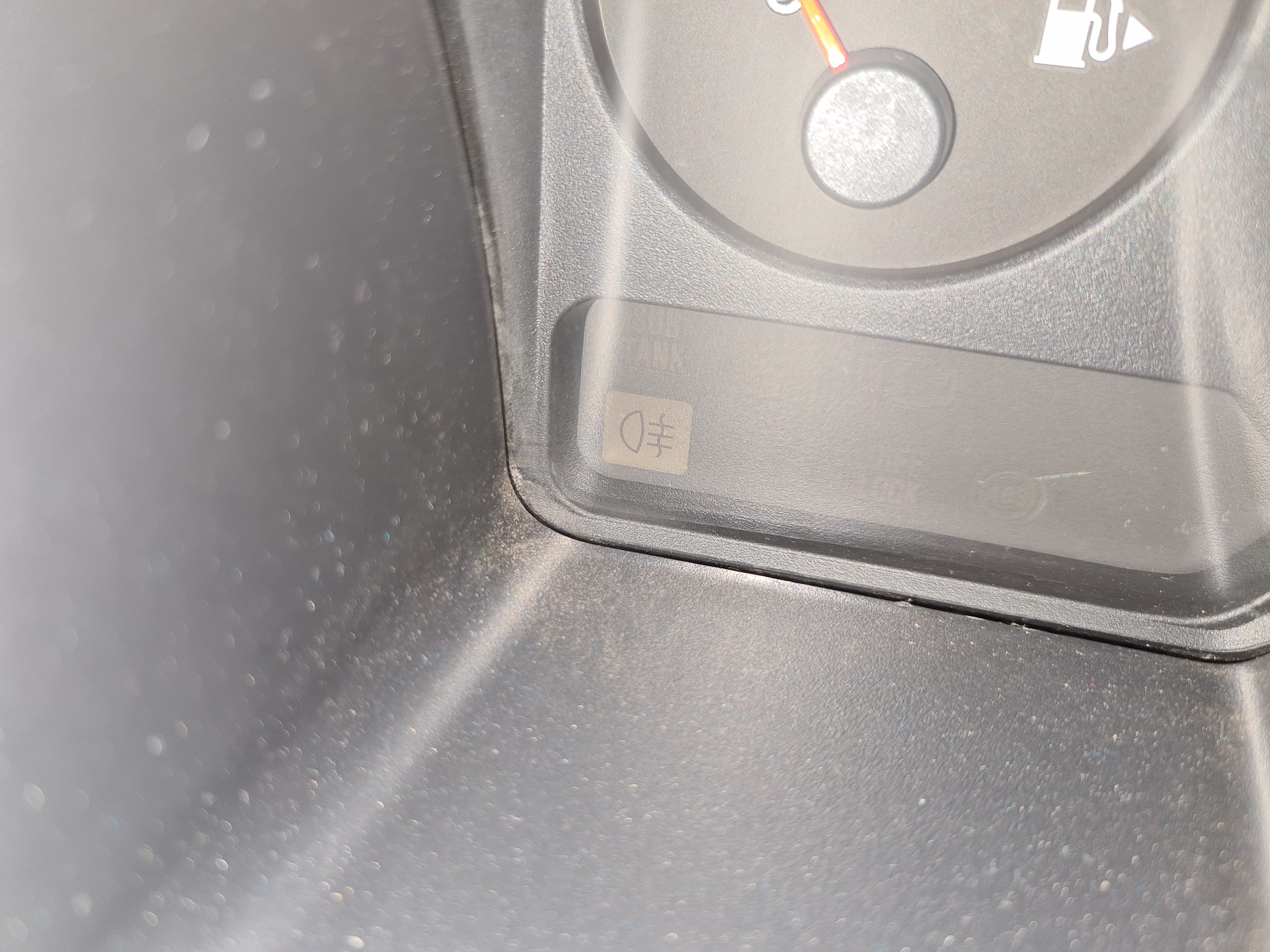

Hi Guys
My dash fog light indicator is not switching on, is it fuse related?
If so does anyone know which fuse i should be replacing. I am having difficulty finding it
Tks
Rahul

Hi Spike I always thought I had one. Do you know what this is for? Just under sub tank.

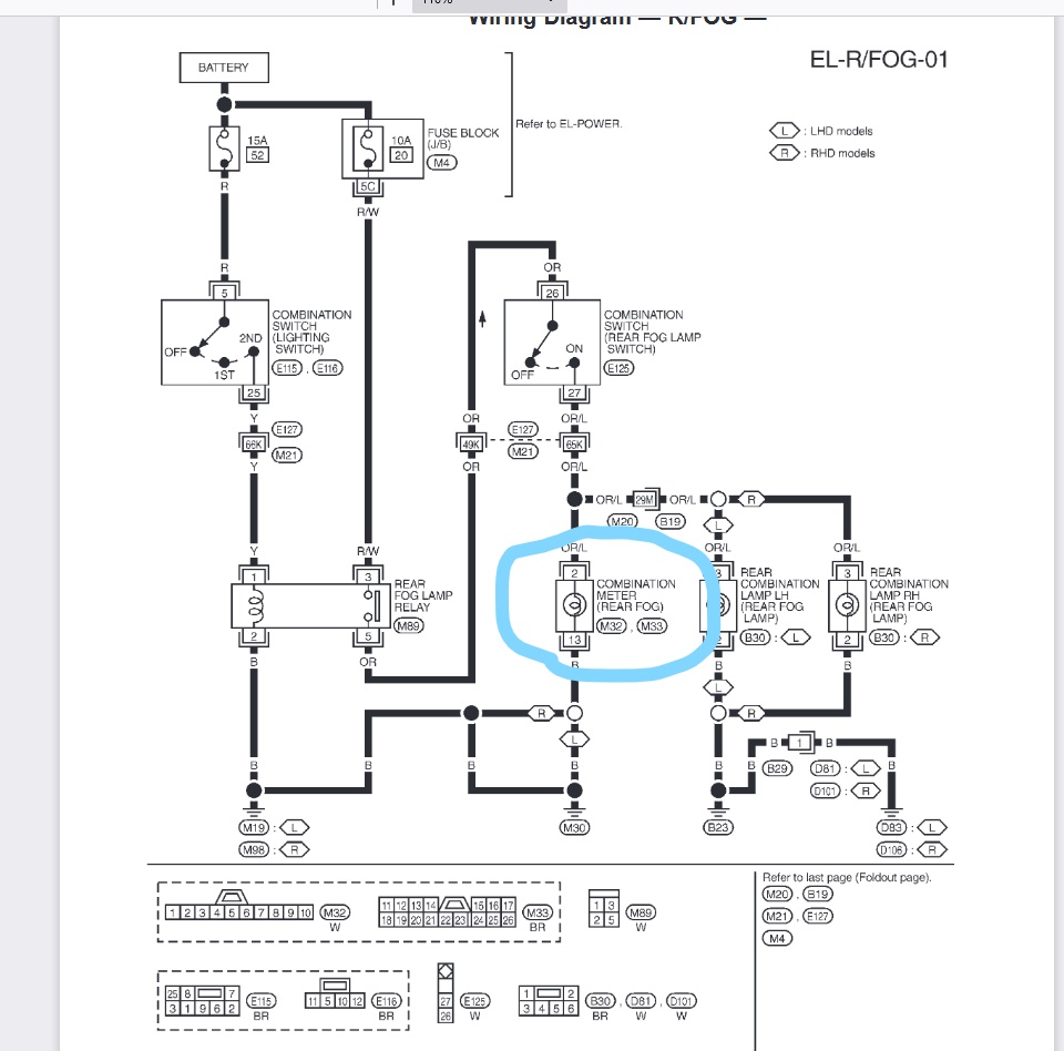

I just scratched through my (very complicated maze of) manuals and came across a page where apparently some models have a dash lamp for a rear fog lamp. Unable to help you further than though. It's out of my lane. Maybe check your taillights and see what's the story there and if you have rear fog lamps
