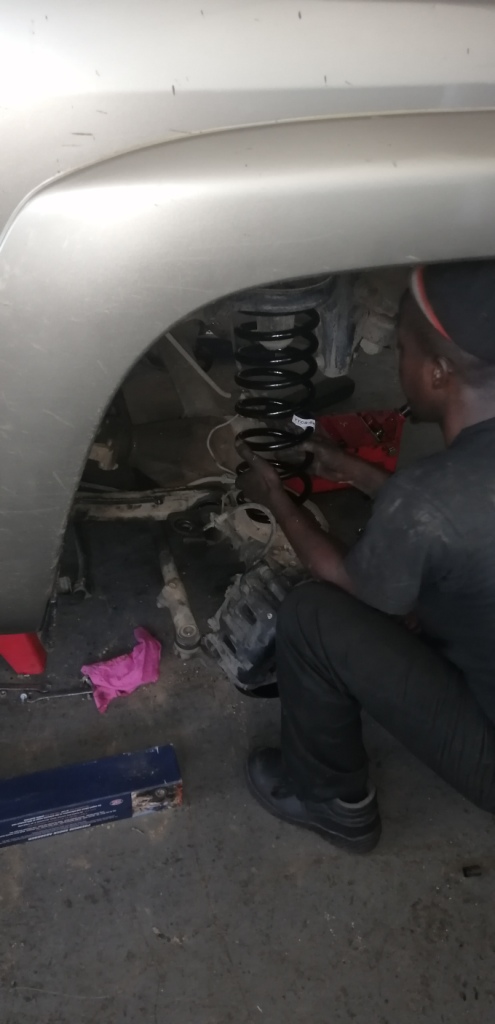

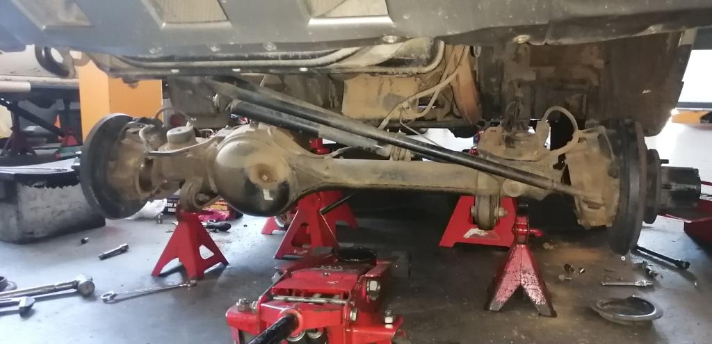

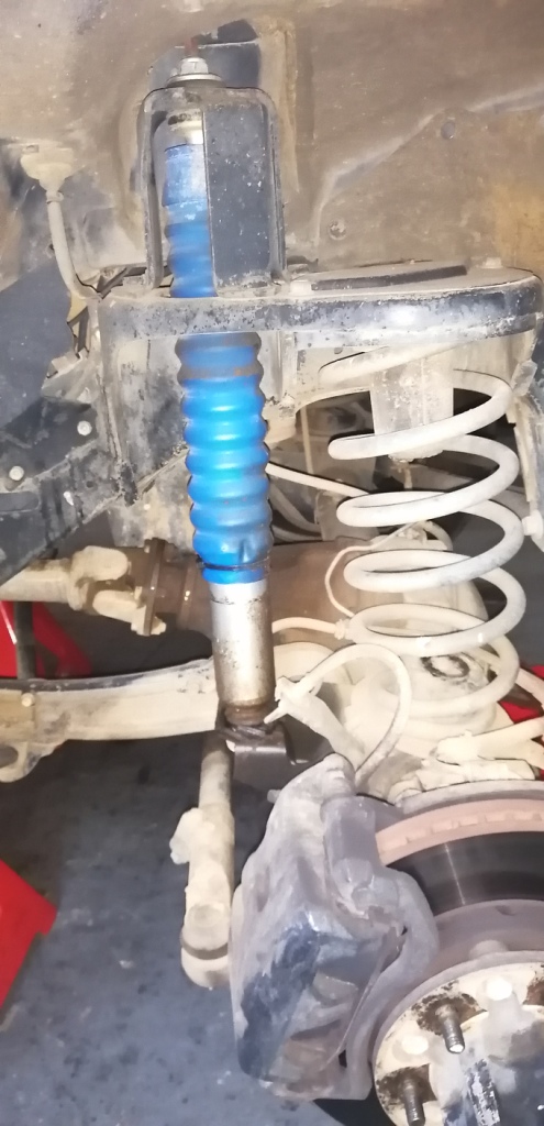

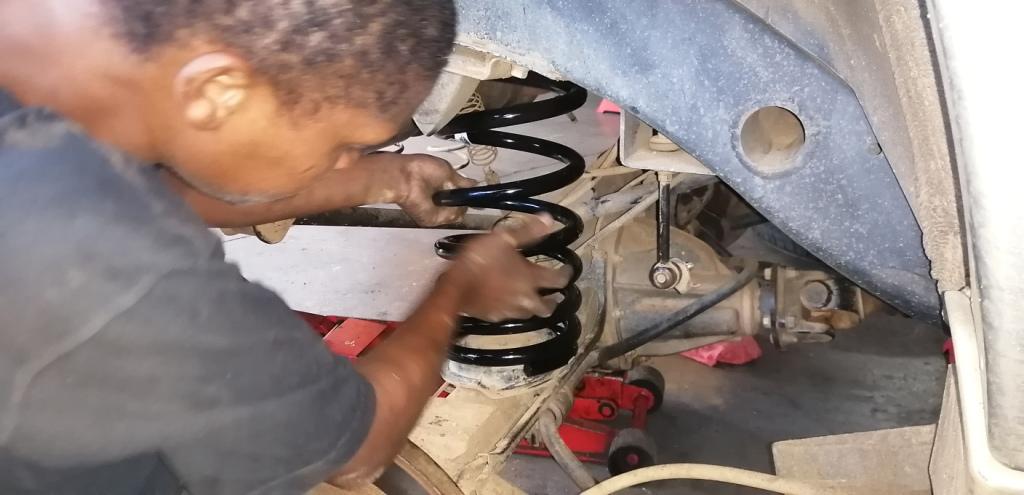

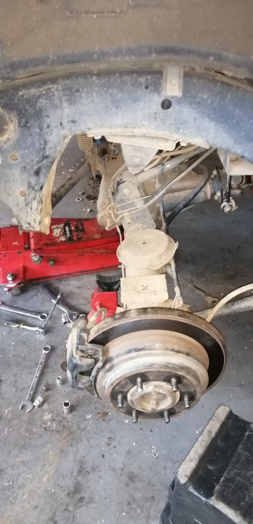

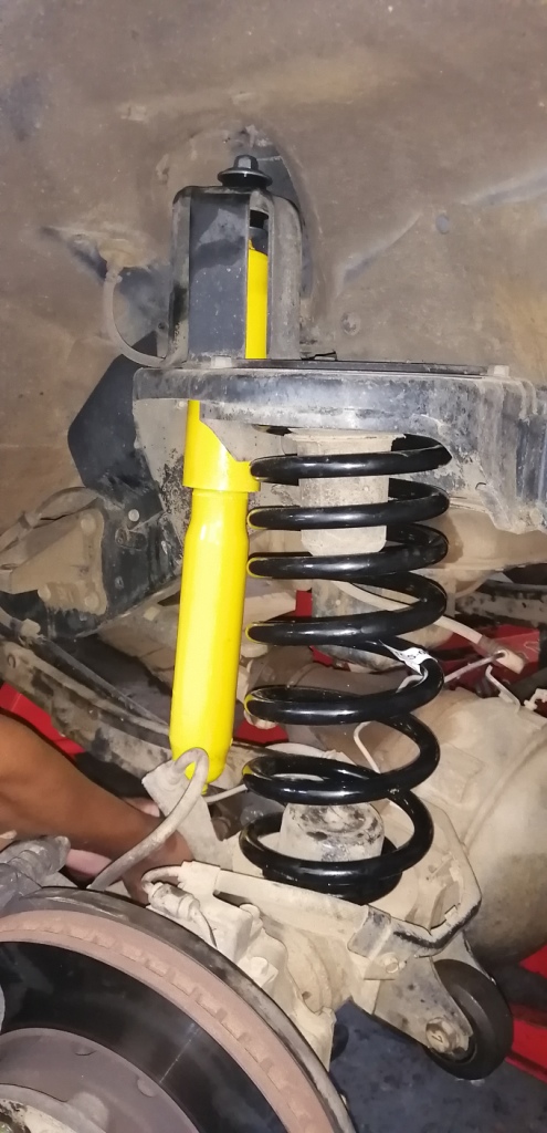

I had a 2" Terrain Tamer kit fitted yesterday
I selected the expanded body shocks, and on Marinus' advice, 50kg/40mm springs for the front, and 300kg/50mm springs for the rear, with a view to not being oversprung
I don't have many extras fitted, I don't plan on fitting much more, but if I put a bumper on the front in future the springs are easy enough to change
The fitment centre kindly allowed me to photograph the process
It's not often I get to see my car without its bits, so it was interesting and a learned a fair bit

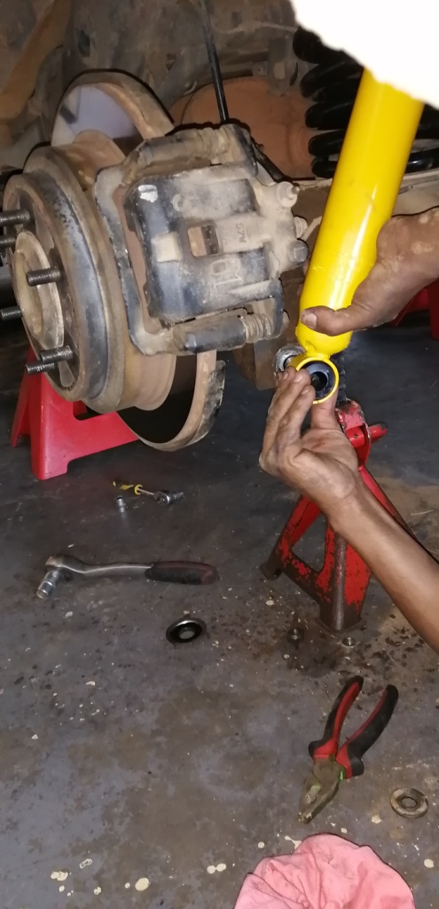

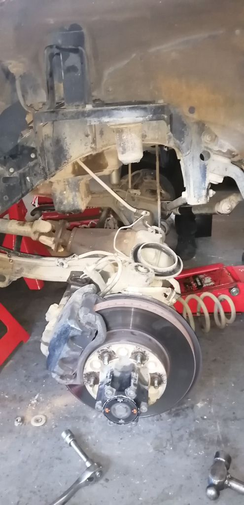

Basically what they did was disconnect the axles completely: sway bar, brake lines, shocks (obviously), and some other bits
This allowed the axles to drop down far enough so that the springs could be removed without having to compress them

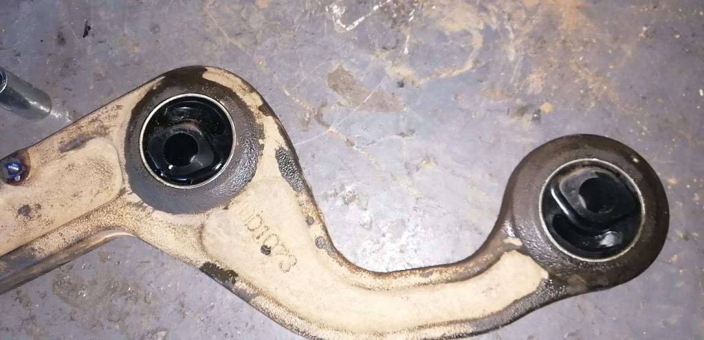

The trailing arms had to come out to fit the caster correction bushes
They installed PC's bashplates at the same time
Here are some highlights, and a link to all the photos i took:
https://photos.app.goo.gl/chirVrys2ePnFvRb7

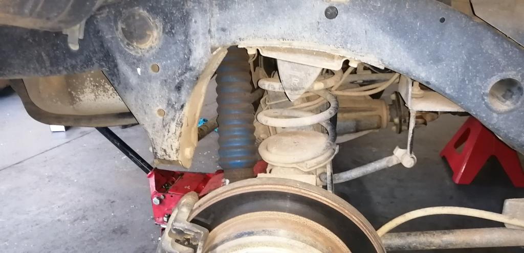

Looks like your front bump stops are poked. You will need to replace them some time. ...

Unkredible wrote: 15 Apr 2021 14:51 Looks like your front bump stops are poked. You will need to replace them some time. ...
:redface:
but thank you sir, without this i wouldn't have realised - only just seen what they are supposed to look like
my balletjies are off, both sides

Nice job Adrian. Pity, it would have been so much easier to replace those bump stops as part of the job.

Peter Connan wrote: 15 Apr 2021 19:54 Nice job Adrian. Pity, it would have been so much easier to replace those bump stops as part of the job.
ignorance is curable, i'm getting there slowly

Just one question to the guys who know!
Should one also put a 2"spacer between chassis and bump stop or can the new shocks handle the full compression of the lift?
Posts: 6168
Has thanked: 1141 times
Been thanked: 1049 times
Re: 2" Terrain Tamer suspension
All the 2" lift kits I know of are designed to work with the standard bump stops.
I can't promise that it's true across the board but I would be surprised if it isn't.
For reference, to work with standard bump stops, front shoucks should be no longer than 315mm shoulder-to-shoulder, and rears no longer than about 410mm eye-to-eye.

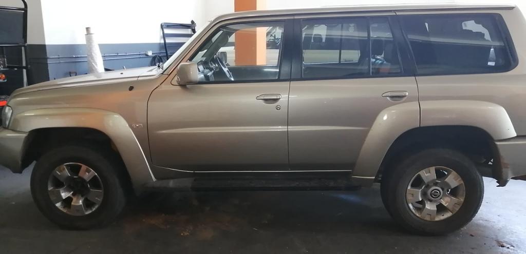

Steele wrote: 18 Apr 2021 18:01 Nice, keen to hear some feedback once you have more experience driving with it.
Given that my previous shocks were so bad, it is seriously like driving a different car
I had an opportunity this weekend to drive it on some rough track and gravel road, and it handled it fine
just the extra 2" gives a vastly different viewpoint too, i.m.o
It's a bit shaky going downhill while braking at highway speeds - i have new brake pads, so i'm not sure if that has anything to do with the new suspension, or if its the brake pads bedding in
The shakes are worse when cornering at the same time is involved

Bump stops are R800 each at Nissan
I've read that the 80 series cruiser rear bump stops work well as an alternative - these are R1500 each
