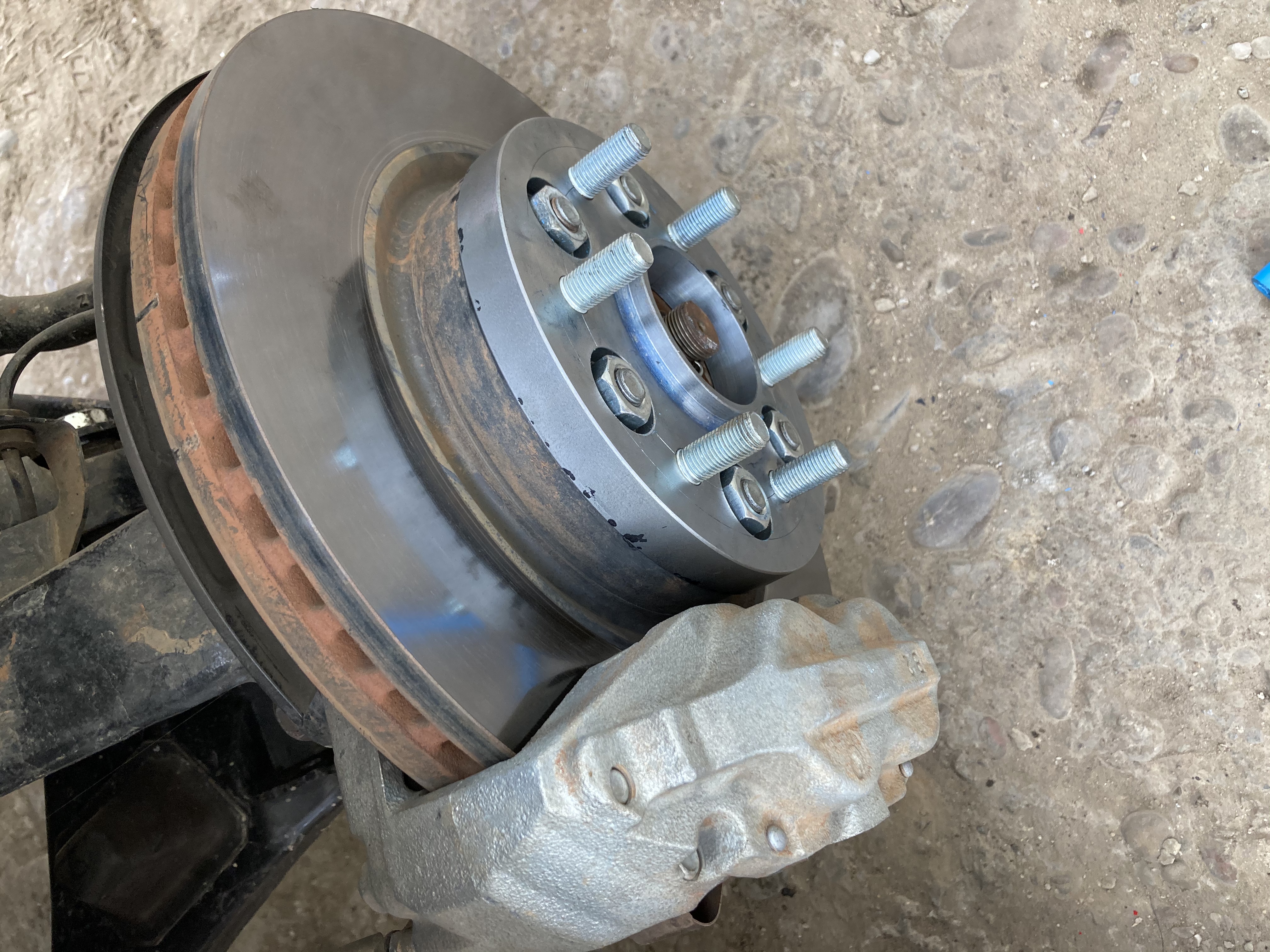

Re: Y62 with 35” Tyres
Hi all,
Thanks for all advice and support. Spacers done with spigot. 20mm bolted onto existing studs with new studs for wheel attachment. Full turning circle achieved. Next to just anodise spacers for good looks and anti rust. I am quite chuffed.
Hi Mark.
Much better using these custom spacers with their own studs.
Just make sure the original studs and bolts are not protruding past the wheel spacer mating surface (it looks like they are in the pic - might be an optical illusion). As you need the wheel mating surface to site hard up against the spacer surface with no interference whatsoever, which im sure you already know . (obviously)
