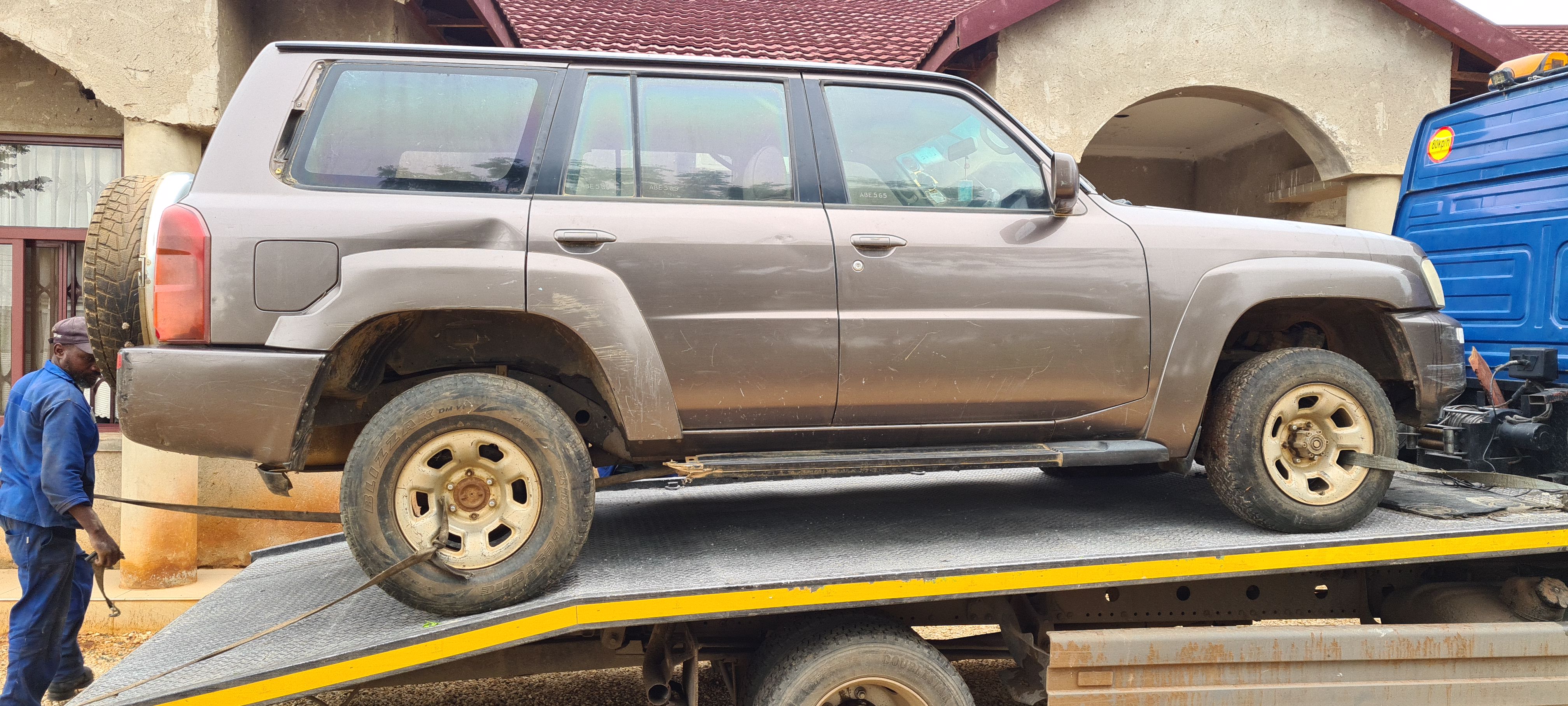

Thanks guys sounds a bit complicated . I think I may just attempt to tidy up and convert existing td42 body into dual cab and try tidy up interior as it is trash , dash is also blistered badly.
I also have access to a single cab body but like the idea of double cab.
- IMG-20201126-WA0005.jpeg (1.46 MiB) Viewed 7767 times

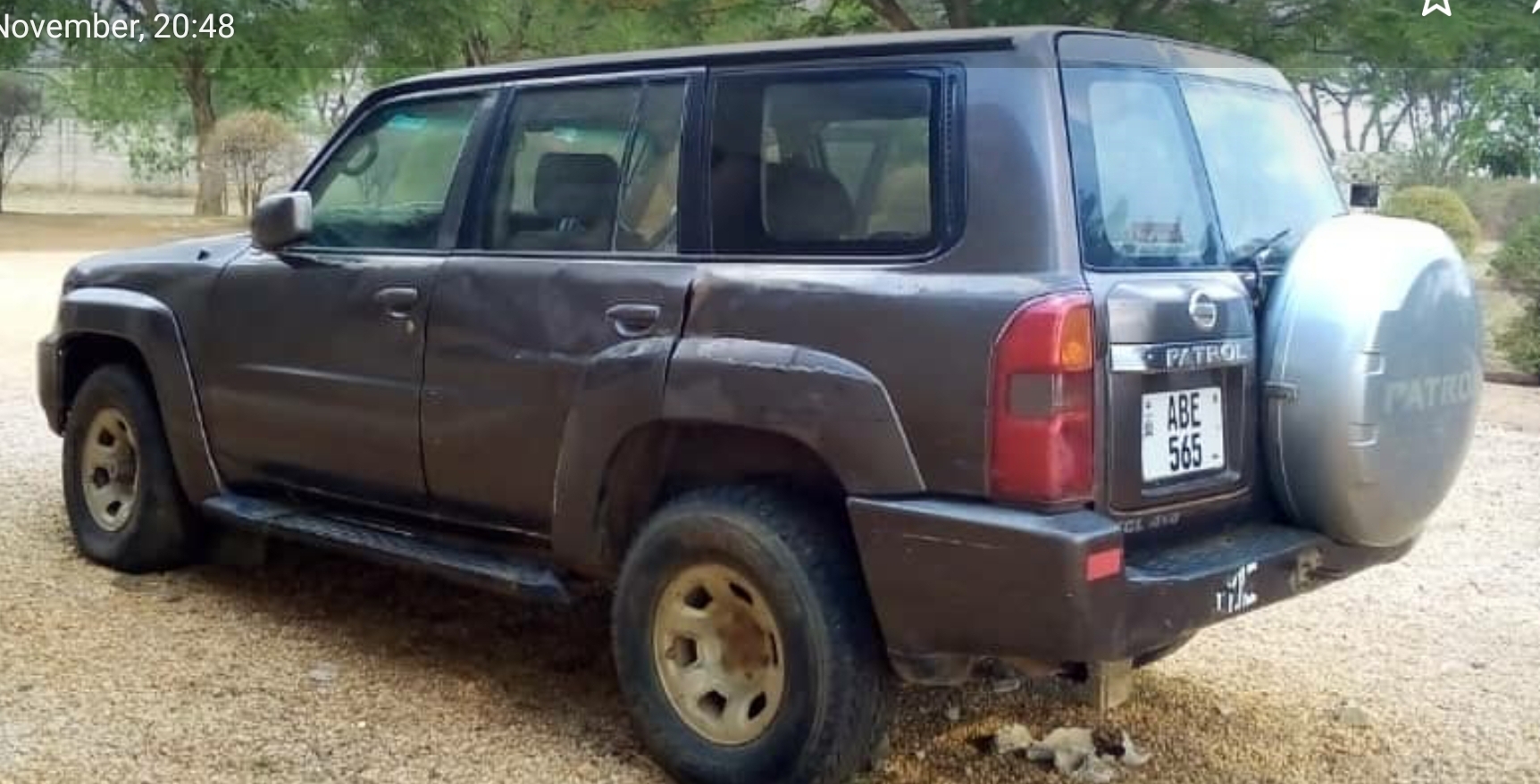

Re: Tb48 and auto box out - Td42 and manual box in
Pic of other side
- Screenshot_20201212-093336_WhatsApp.jpg (707.9 KiB) Viewed 7767 times
