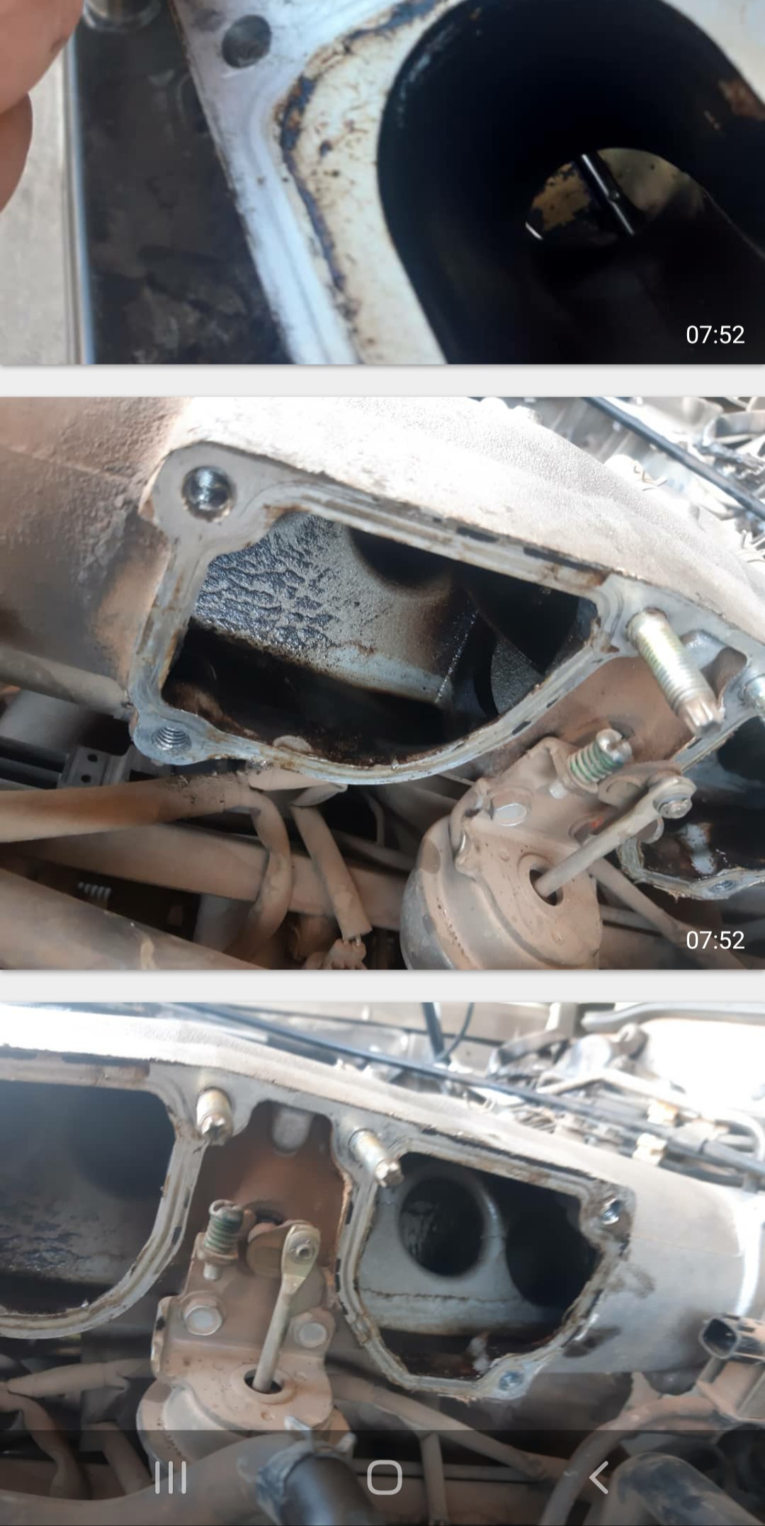

Re: 2005 Y61 tb48 auto smoking
Hi all found problem there is oil in the intake as well as alot of sludge, so will replace bearings and rings , seals and gaskets etc
Is it using a measurable amount of oil?
If not, why not just install a catch can?
