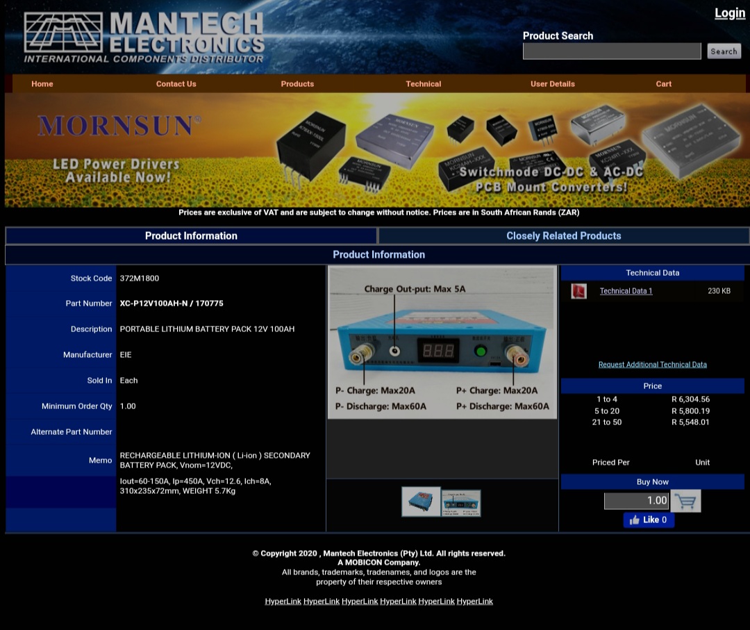

Re: Looking for LiFeP04 Battery
Thanks hugejp, I didn't find them on my original google search, but I am happy you sent the link.
It seems that the 12 100ah lithium is like 73mm wide and only weighs 5.7kg
And it basically costs the same as an AGM.
Crazy.
I will just contact them to make sure my dc/dc charger is compatible.
Is there a dc to dc charger you would recommend for Lithium?
Crazy.
- 20201018_205349.jpg (218.13 KiB) Viewed 5660 times
