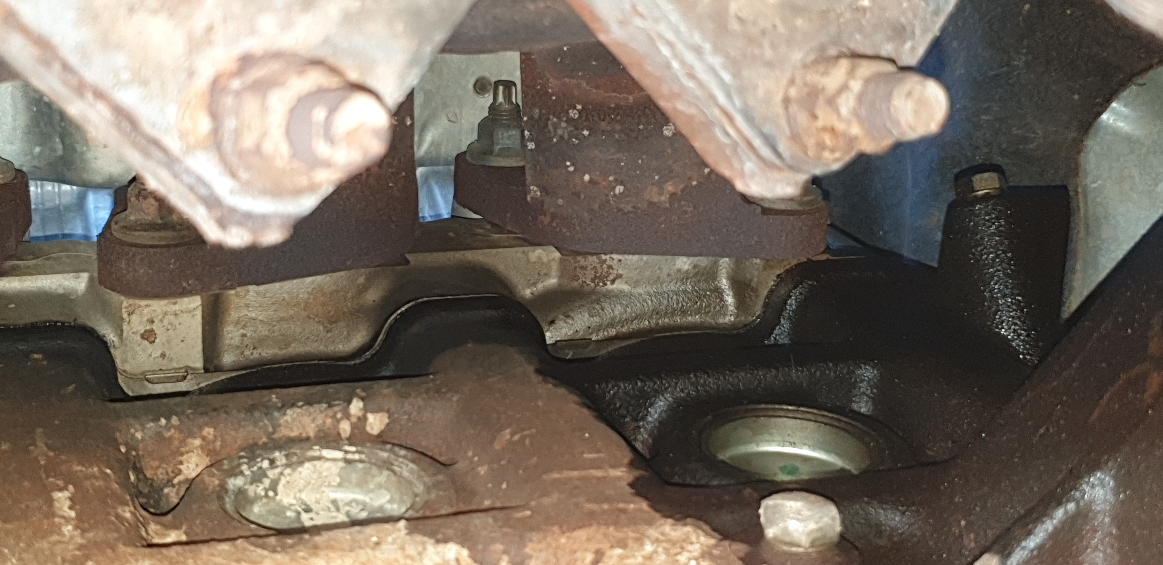

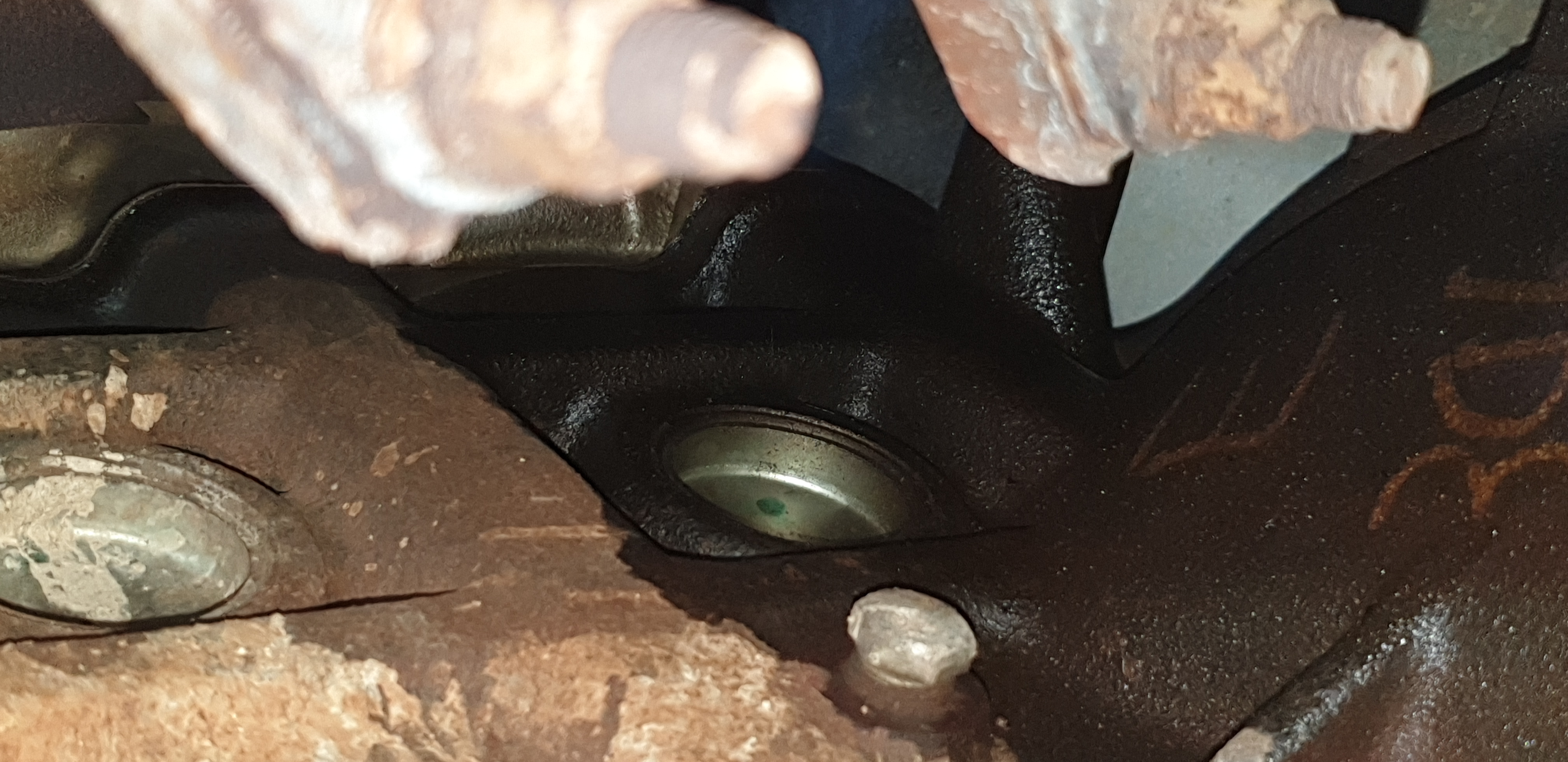

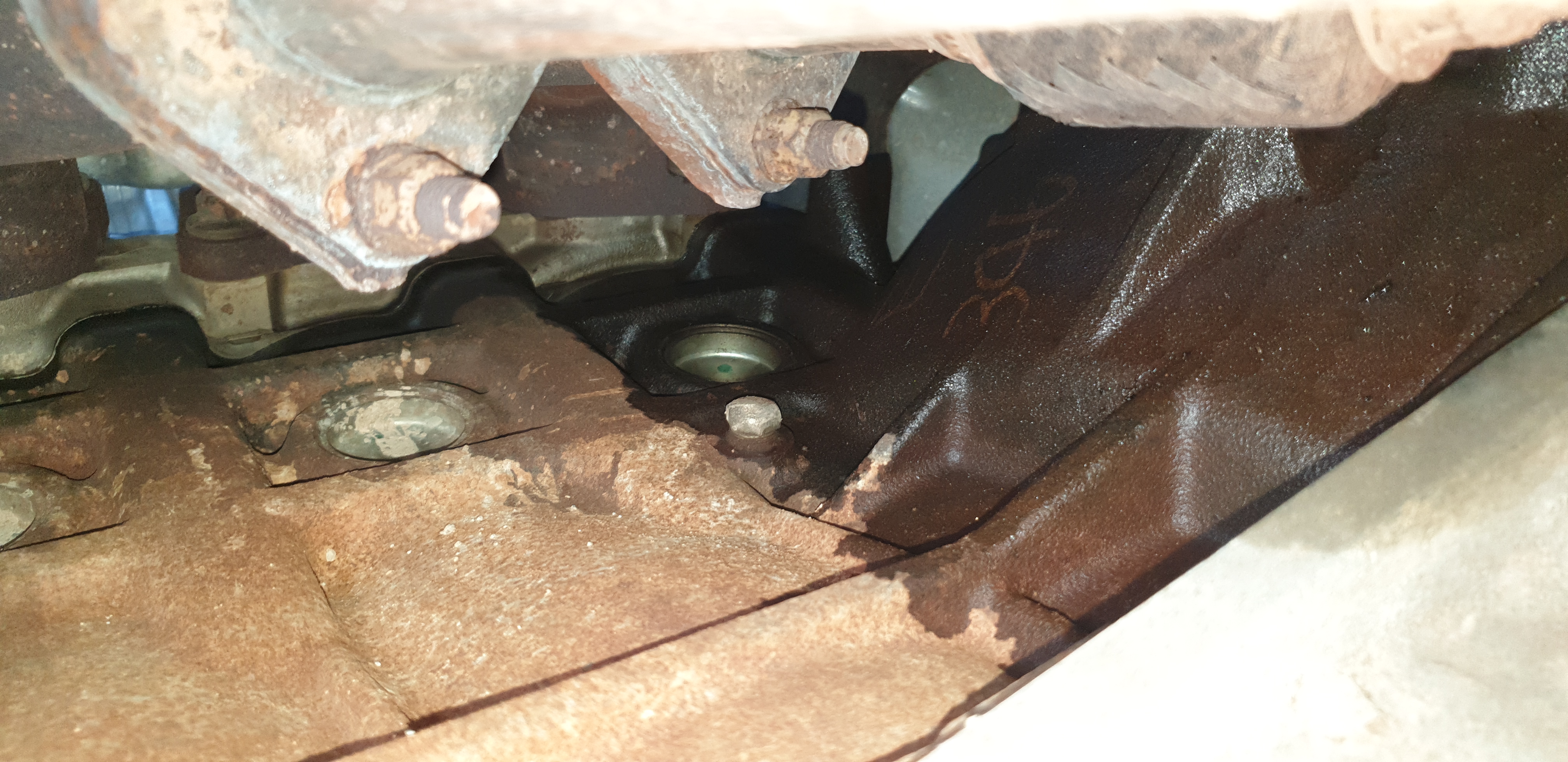

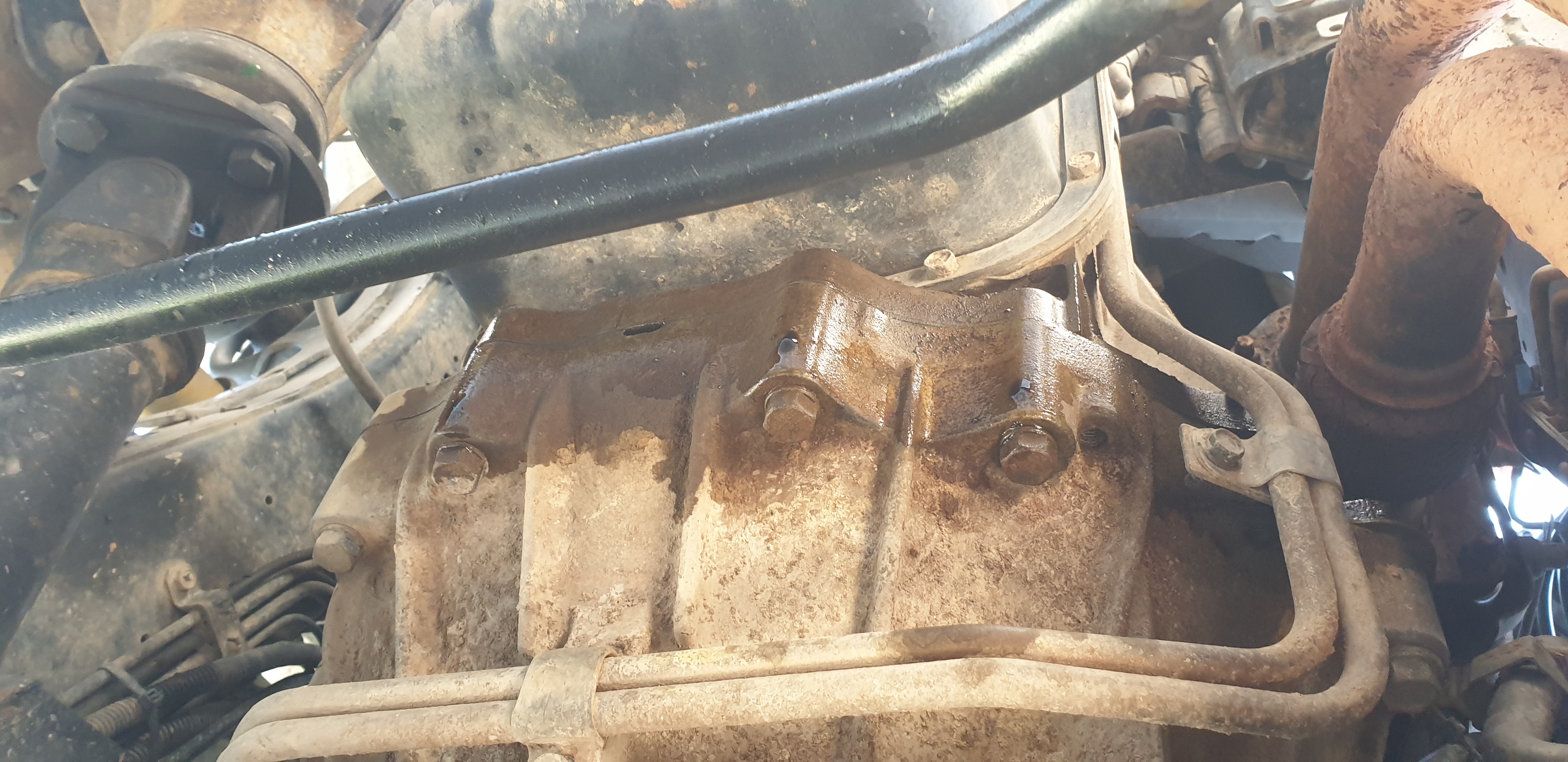

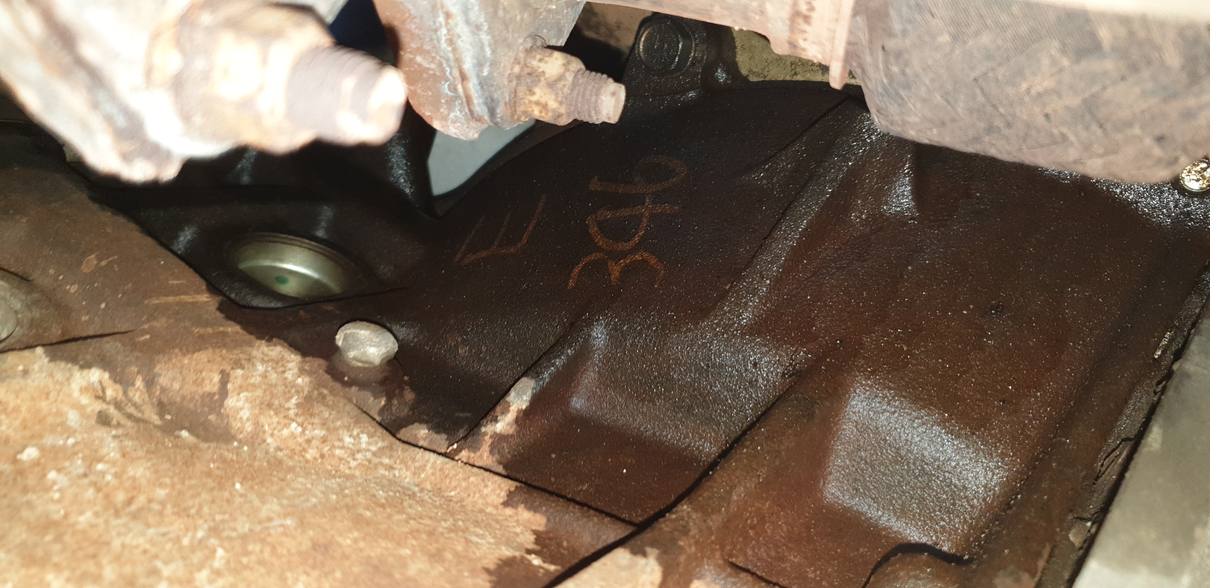

Hey Guys
I got under the Patrol this morning to do my regular checks of the drive train and noticed oil leaking from where the transmission and engine block join. Further investigation showed that it looks like the oil leak is coming from the cylinder head on the exhaust side. I suspect that the cylinder head gasket needs to be replaced. I would appreciate a few 2nd opinions as the Troll is due for its 135k service this coming Wednesday.

I would be concerned that the problem is more than just a gasket...

Oil leaks are mostly originating more to tthe front of where it is visually apparent. Check the cover at the timing gears in font

Rear main seal?
Re: Possible Cylinder Head Gasket Leak
give it a good wash and check again wthout wind blowing it arround

I was at Franz Fourie today and he took a look at my Troll and confirmed that the root cause of my issue is that my vehicle was overfilled with oil at it's last service 5,000 km ago. The oil is way above the "High" mark on my dipstick.
There is no oil in my radiator fluid, which eliminates a leaking gasket, and there is no smoke coming out of my exhaust so rings are fine.

Well.... not sorted yet.
Where is it pushing out of?
Maybe just the dipstick even?

Isn't the dipstick on the other side of the engine? Asking for a friend.
