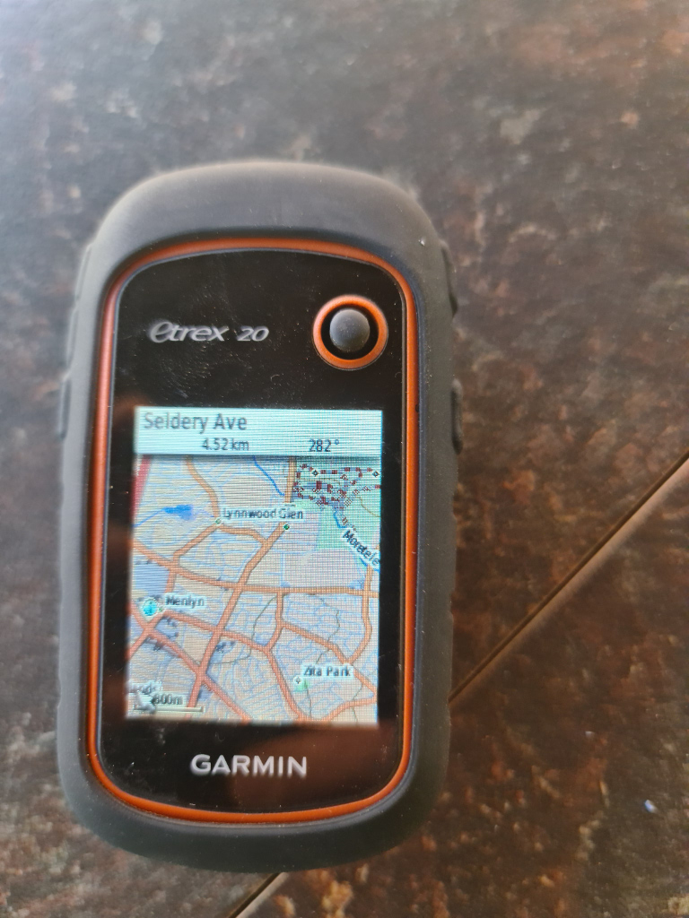

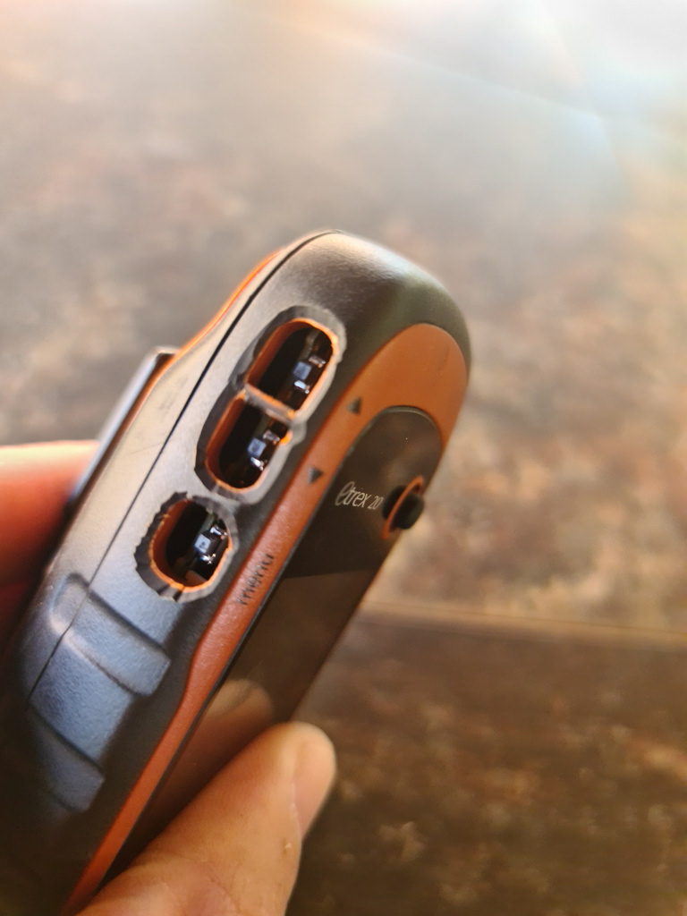

Since my trip to Nam last year, all the rubber buttons have started failing. So step 1, was removing them all. Easily accomplished with a craft knife... The first photo shows the GPS with rubber buttons intact. The second one, shows the rubber buttons removed, and one can see the actual electrical connections in the holes where the buttons used to be...

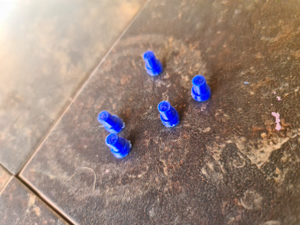

I also had a few 3D printed push buttons lying around from an electronic project housing I finsihed a few months ago.

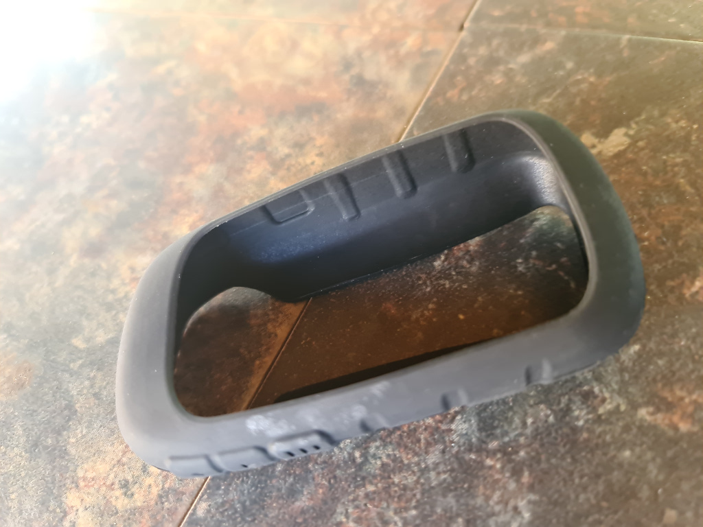

Finally, for the princely sum of R199, I ordered a protective cover for the Garmin eTrex20 from BidorBuy (this one - https://www.bidorbuy.co.za/item/4793866 ... Black.html).

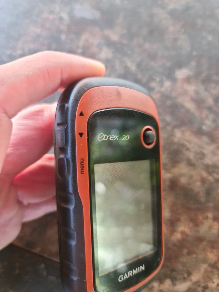

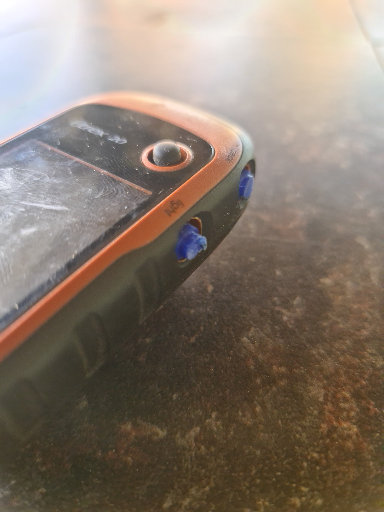

In any case, my 3D printed buttons were not 100% the correct size, but I chopped them down a little using my Dremel so that they fitted as so.
And voila - an operational GPS unit again.
Great - my unit has now lost it's IPX7 ingress rating, but I am not intending to get it wet for a bit. I'll replace it at some point when I can.
