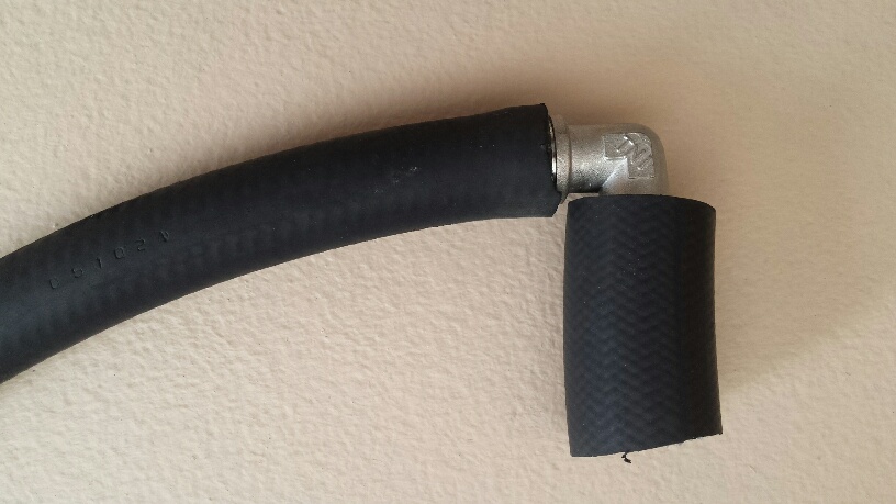

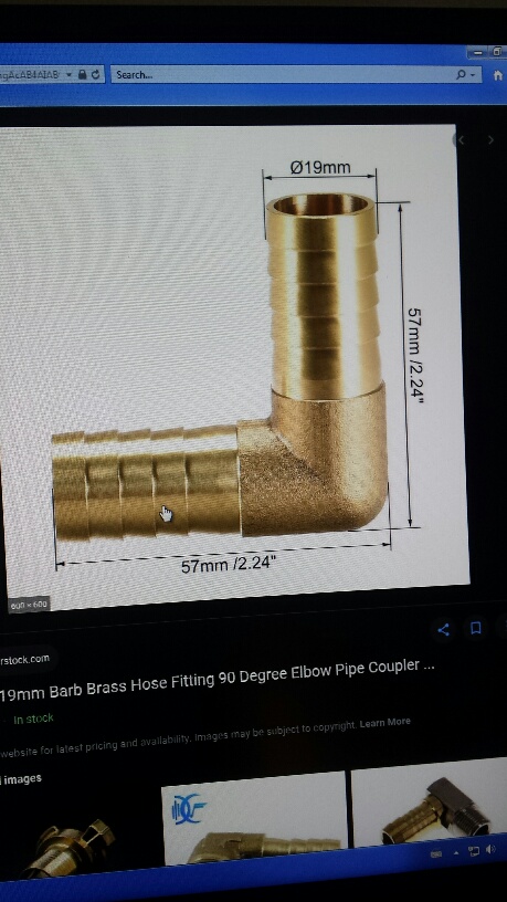

I am desperately trying to find 19mm(3/4 inch) brass or copper elbows as per attached image .First prize would be a reducer elbow from 1inch to 3/4 but I do not think you get them. Provent oil catchcan that I want to install has a 1inch outlet and it has become a nightmare to source 3/4 inch fittings and 1inch to 3/4 reducers, I also do not know if these exist .I would be grateful for any suggestions where to get these, import currently is not an option although they are freely available overseas.

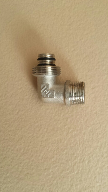

Dankie Malcolm,
Ek is toe builders toe met my pype en gaan kyk toe by plumbing(20mm in my kop het heel tyd verhoed dat ek daar kyk maar ek was dom want buite diameter van die konneksies kom by 1 duim) ek kry die konneksie wat sal werk , clamp area is klein maar konneksie draai in die 1 duim pyp in en hopelik sal die thread in die pyp wand sny en so beter grip gee.Wand is 5mm dik.
Weereens baie dankie want nou het ek die 90 grade en die reducer in een.

Re: I need help
Draai net baie PTFE (plumber's)tape oor daai threads, sodat die threads goed seel, maar dit behoort te werk. Die nou oppervlak kan dalk lol, die pyp kan maklik afkom as daar beweging is.
Daai plastiek pypies sal goed werk, plastiek is olie bestand, sal geen probleme daar gee nie, en die water se hitte sal max 120 grade word, daai plastiek sal eers hier by 200/220 grade sag word of smelt.
