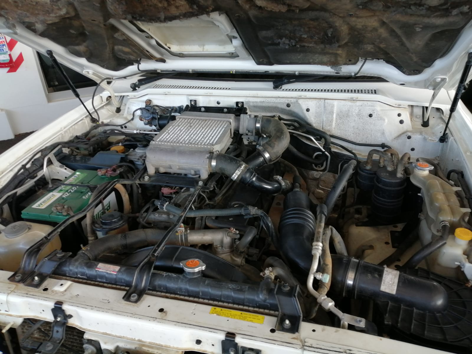

Hi There Guys
I am looking at buying my first Patrol and I am looking at a 4.2 pickup. The dealer says it is a 4.4 NA but I think it is a turbo (Only have pics as vehicle is faaaaaar away). Below is a pic of the engine. Can any of see what it is?
Cheers
Paul
Cheers
Paul

Dealer now confirmed it is a Turbo 4.2D

Thise factory turbo engines are probably the toughest version of the TD42 ever made.
