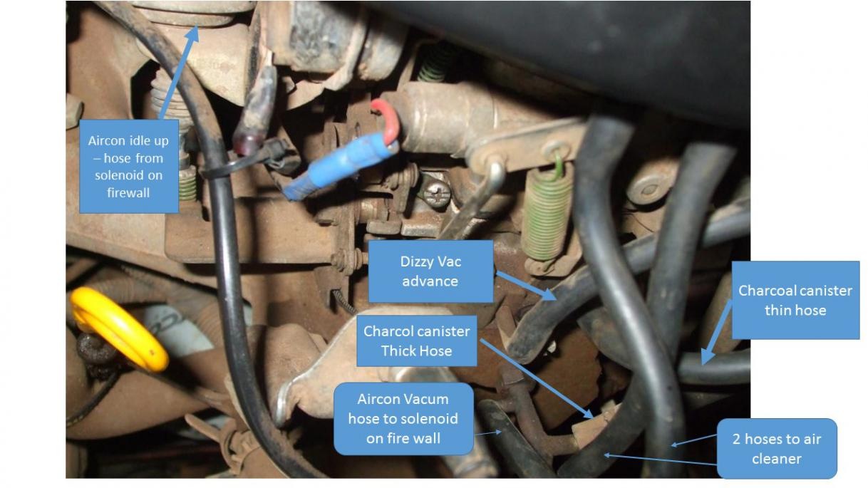

Good afternoon.
Can someone help me with the location of all the vacuum pipes on the carb. Car goes fine but over fuels on idle. I don't have the compensator on the car and never had issues but the pipes came off and now it's a ballsup.

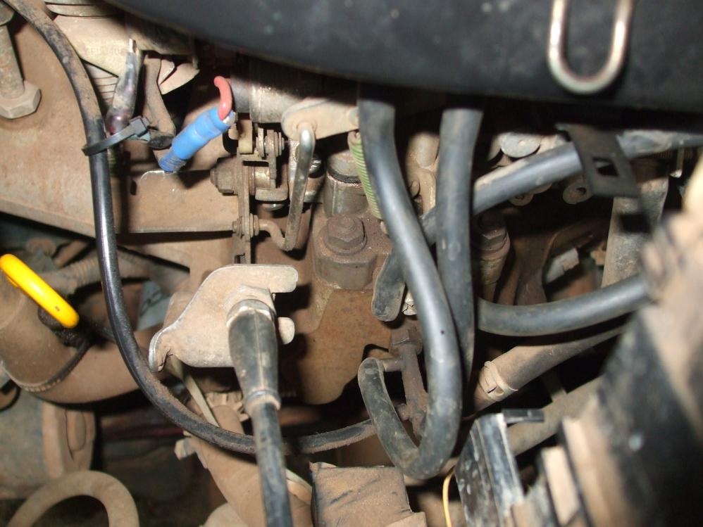

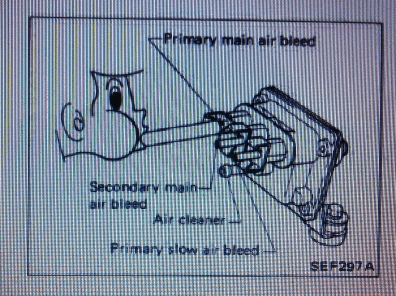

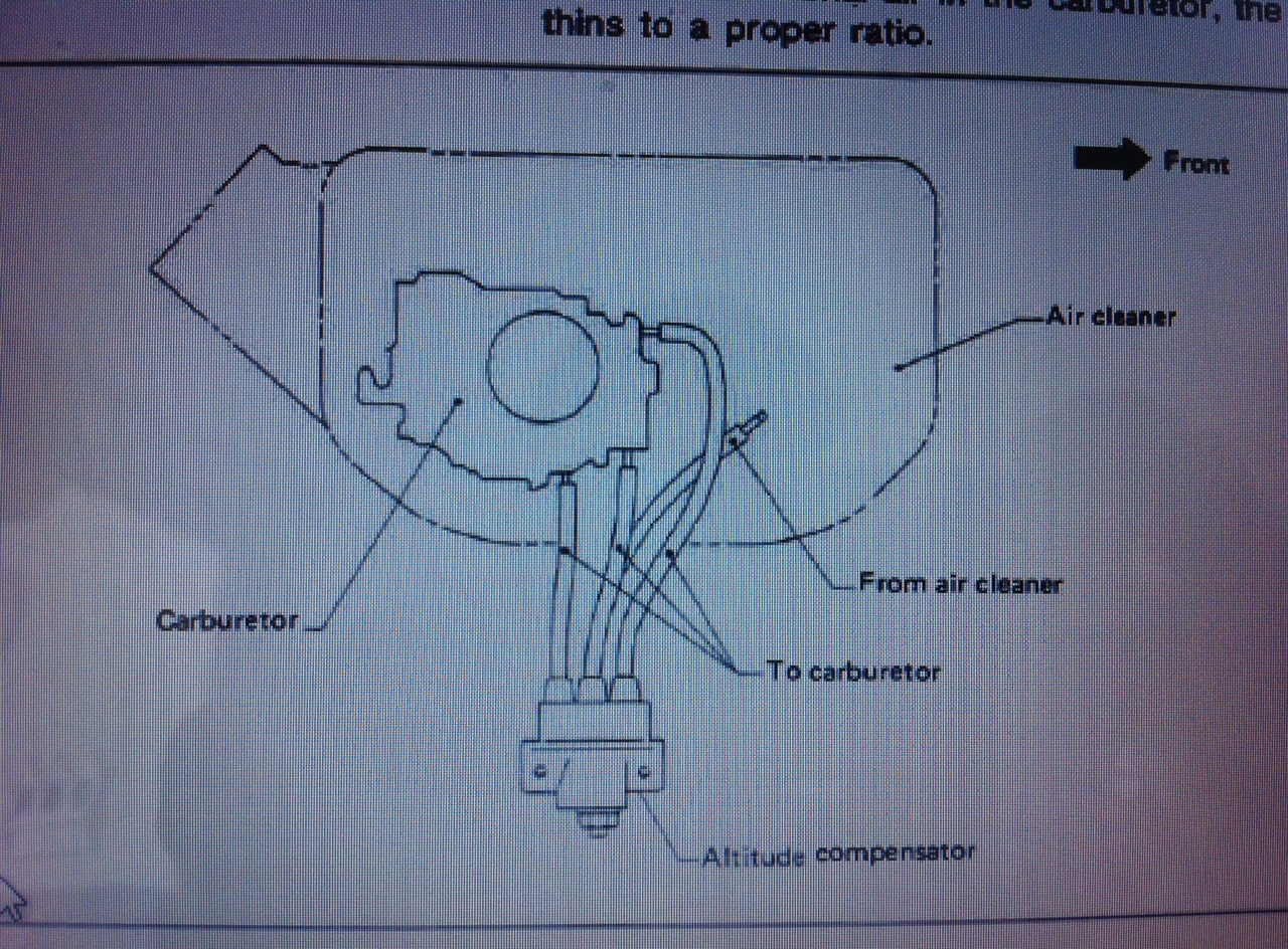

Re: Carburetor vacuum issue
Hope this helps?.....the dirty engine is not mine!!
- image.jpeg (158.18 KiB) Viewed 5297 times
- image.jpeg (162.1 KiB) Viewed 5297 times
- image.jpeg (760.74 KiB) Viewed 5297 times
- image.jpeg (757.76 KiB) Viewed 5297 times

Hi DanielDaniel wrote:Sure I can help with photos and diagrams.....just have to find them
Thanks it will really help I've got a workshop manual but I can't find anything about the setup without the compensaton valve.
