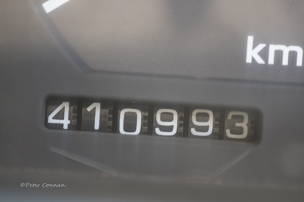

The car is now on 411k km.
Now the astute among you will realize that the difference is only about 38k km. Which is not much. However, I have to admit that I am a lazy bugger, and only rotated these twice in their life, which is not the way to treat muddies. I guess a decent rotating schedule could have squeezed another 5k out of them. In fact, I guess I can squeeze another 5k out of them on the road, but they will be pretty useless off-road past this point.

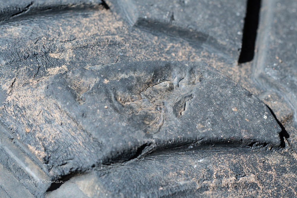

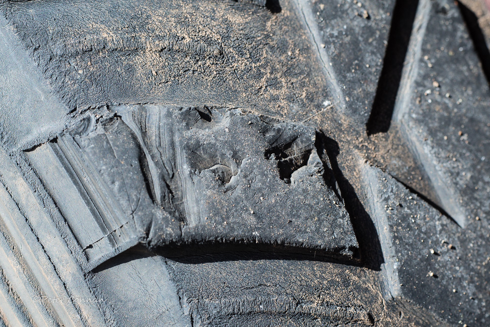

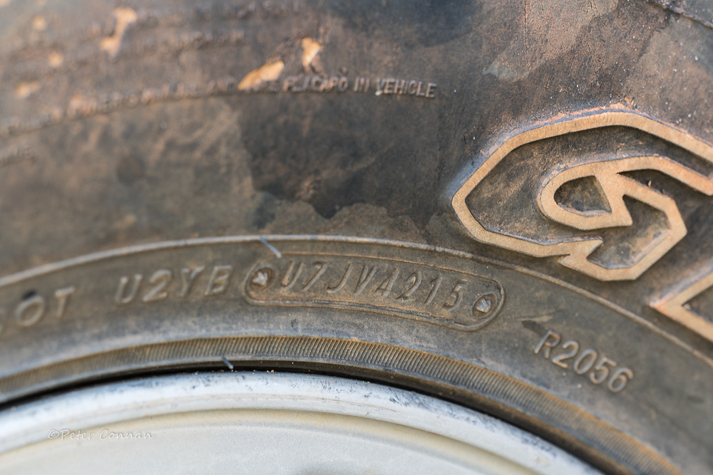

Now onto damage. Here towards the end (they are now just less than 5 years old, having been made in week 42 0f 2015 if I read the date stamp right),
they have begun to look pretty badly abused.
On one tire, an entire tread block has been torn off:

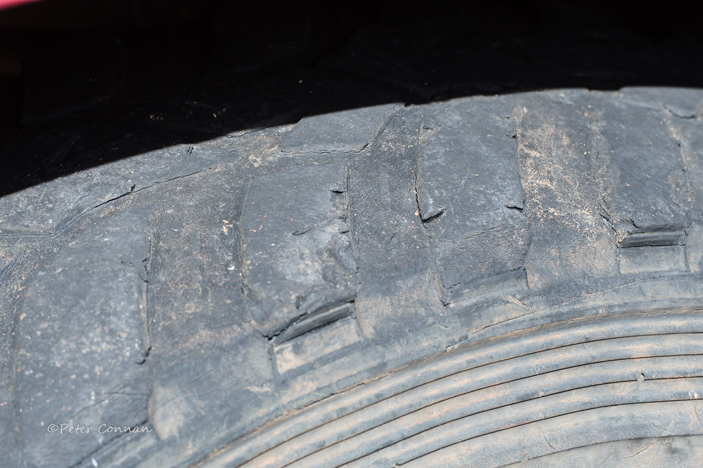

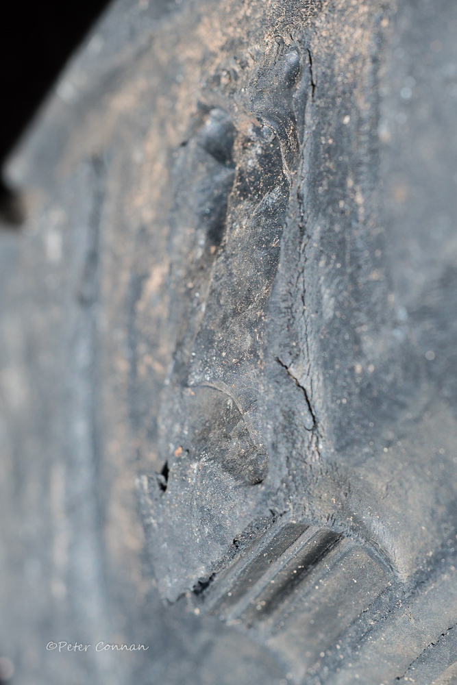

However, the spare tire (which was taken out of rotation probably 10k km ago) shows much less damage although still being the most worn:
(note the clear heel-and-toe wear on that one due to me not rotating them frequently enough).

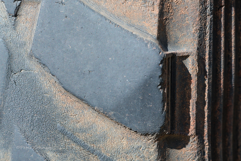

After the first couple of tough trails, there was almost no tearing present, and they were looking really good. It's really only during the last few months that they have started tearing up like this.
