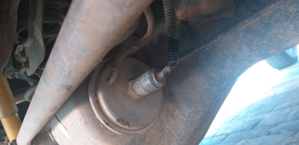

K...…...….First of all Guys I have basically zero mechanical etc etc know-how, but this is what I've done just now, may be of help/interest to some, may even have some entertainment value
First I crawled under Greens, a mission in itself. And checked all the difflock thingies, pipes etc etc, all looks perfect there.
Pulled on that blue "plug", but gave up the battle very soon.
- 20200204_110513.jpg (120.38 KiB) Viewed 4813 times

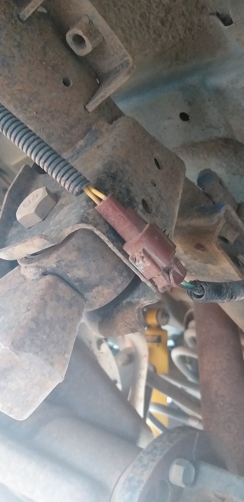

Followed the Black Draad, and unplugged it.
Went for a spin, and (so far) the Difflock light is off. Even took a quick spin on a plaaspad, and no lights, only safety belt. But I didn't wear it, so I'm comfortable with that 1 liggie on
Looks like a dirty plug, hopefully it is.
Will use it for a couple more days and check if that light stays off.
- 20200204_111344.jpg (140.71 KiB) Viewed 4812 times

Oh yes forgot to add - If I engage DL, even with that plug removed, it definitely kicks in (the solenoid??), but why?? Or is that disconnected plug only a "telltale" one, to show if DL is activated or not (meaning, it only "works" with the dashboard DL Light).???

The mechanics of the diff lock work on the air vacuum ( the other little rubber pipe to the left of your photo of the goodie on the diff) so even if you unplug the wires it should in my opinion work. The wires I think are only for the dash light and overspeed chime when in low range and diff lock is engaged.
Make sure those rubber pipes are sealing properly around the steel in and out pipes both in the engine bay and on the diff. It may be holding vacuum and just not having enough to hold it in off position (I really am guessing here).
I cannot see it as being a dirty switch or plug as it should be in the off position and no current running through those wires until switched on in the cab.
My bet is a leaky pipe, even with a tiny almost unnoticeable hole in it.

I believe the light is only a tell-tale, and that the swith only operates the light.
By the way, if the problem persists, i have been told that that switch is the reverse light switch from a 1400 bakkie.

The Difflock activates and disengages perfectly, so no issues there, so I think (hope) that ……….. so even if you unplug the wires it should in my opinion work. The wires I think are only for the dash light and overspeed chime when in low range and diff lock is engaged.……...this is all good
Have been using the car up and down the whole day, and that Difflock liggie stays off now (with that wire unplugged).
If I engage DL though, it clicks in, but the telltale light flickers - understandably.
I'll see if it goes on/off normally tomorrow, after I cleaned with Spanjaard and connected it again

If the diff lock light flickers, then it usually means that the dog gear in not fully engaged. a little forward motion and left/right turning will usually allow the dog to slip into place properly, then the light will remain on till you disengage ( which sometimes also requires a little forward or backward motion and left /right movement to get a full disengage)

Thanks riscter, yes mine works 100% (when that plug is connected obviously). The light flickers now when I engage DL because the plug is out.ricster wrote: ↑05 Feb 2020 08:30 If the diff lock light flickers, then it usually means that the dog gear in not fully engaged. a little forward motion and left/right turning will usually allow the dog to slip into place properly, then the light will remain on till you disengage ( which sometimes also requires a little forward or backward motion and left /right movement to get a full disengage)
I'll use the Trol a couple more days to just make VERY sure the light stays off (with plug out), to be certain it IS the plug,and will then clean and re-connect it. I'm actually 99% sure it IS that plug now - either the plug, or then the connection at the dial (but I doubt it).
That intermittent flicker of the light was usually only at speeds above 90 or so - funny.

I also think that the switch might be a little faulty at the diff. hopefully a good clean will have it sorted out quickly
