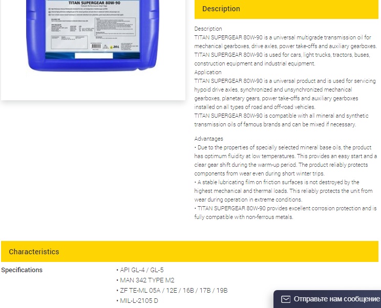

Howzit Guys.
I've checked the manual in the library, would like to post pictures of the available oil that i want to put in the diffs and transfer case.
Please advise on what i can use and not.
- supergear 80w90.jpg (115.68 KiB) Viewed 11457 times

Note that on the super gear it states Gl4, would that be suitable for transfer aswell as diffs ?

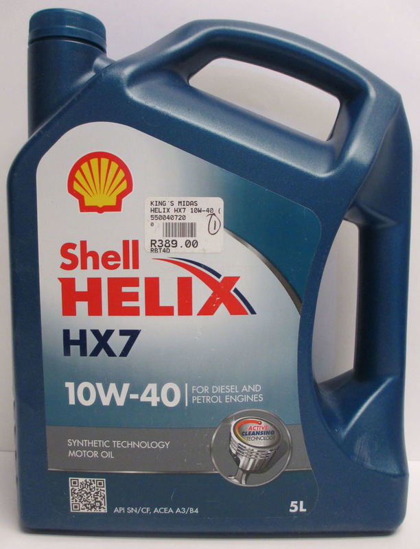

Are you sure this vehicle has been running on HX7 all along? I run my Patrol and my Pathfinder on HX3, both therefore running on mineral oil.

I have spoken to expert oil guys about the synthetic vs mineral oil and if they mix or not. Aparantly its a myth that you cannot swith over. I have switched over on previous vehicles I had with no drama.
Shell HX7 is actually a blens oil and is a mix of symthetic and mineral oil........ so think it prooves the point as well.
Depending on what engine you have, what Anthony said is quite important as the precombustion chamber engine (like the Patrol TD42 and the Ranger 2.5) is not suited to run a full synthetic oil.

Francois, Castrol se produkte: https://applications.castrol.com/oilsel ... 2007-2010)
Fuchs: https://www.fuchs.com/se/en/products/se ... l-chooser/
Engine TB48DE
Capacity:
Capacity 6,8 litre
Use:
Normal
Intervals:
Change 10000 km/ 6 months
Products:
TITAN GT1 FLEX 23 SAE 5W-30
TITAN GT1 PRO C-3 SAE 5W-30 (XTL-Technology)
TITAN GT1 PRO FLEX SAE 5W-30 (XTL-Technology)
Differential, front H233B
Capacity:
Capacity 5,4 litre
Use:
Normal
Intervals:
Check 20000 km/ 12 months
Change 60000 km/ 36 months
Products:
TITAN SINTOPOID SAE 75W-90
TITAN SINTOPOID LS SAE 75W-90
TITAN SUPERGEAR MC SAE 80W-90
Transmission, automatic RE5R05A 5/1
Capacity:
Capacity 10,4-10,7 litre
Use:
Normal
Intervals:
Check 12 months/ 30000 km
Products:
TITAN ATF 4400
Shell: https://www.shell.com/motorist/find-the ... XdFY1Z1S2M

I was an avid Delo 400 supporter and user for the iron Maiden for many years, but one service a few years back I couldn't get any Delo 400, so saw the Shell HX7 as shown on the pics above by Tapie, and mine runs smooth and without any more oil consumption than usual. No rattle and hum noise change either. I have also had no issues with a flickering oil light.
I really hope this is a good oil for the TD42, as I've done over 50 000Km on the stuff....
Oh and I service every 5000 Km both oil and filters (2 x big ones)
