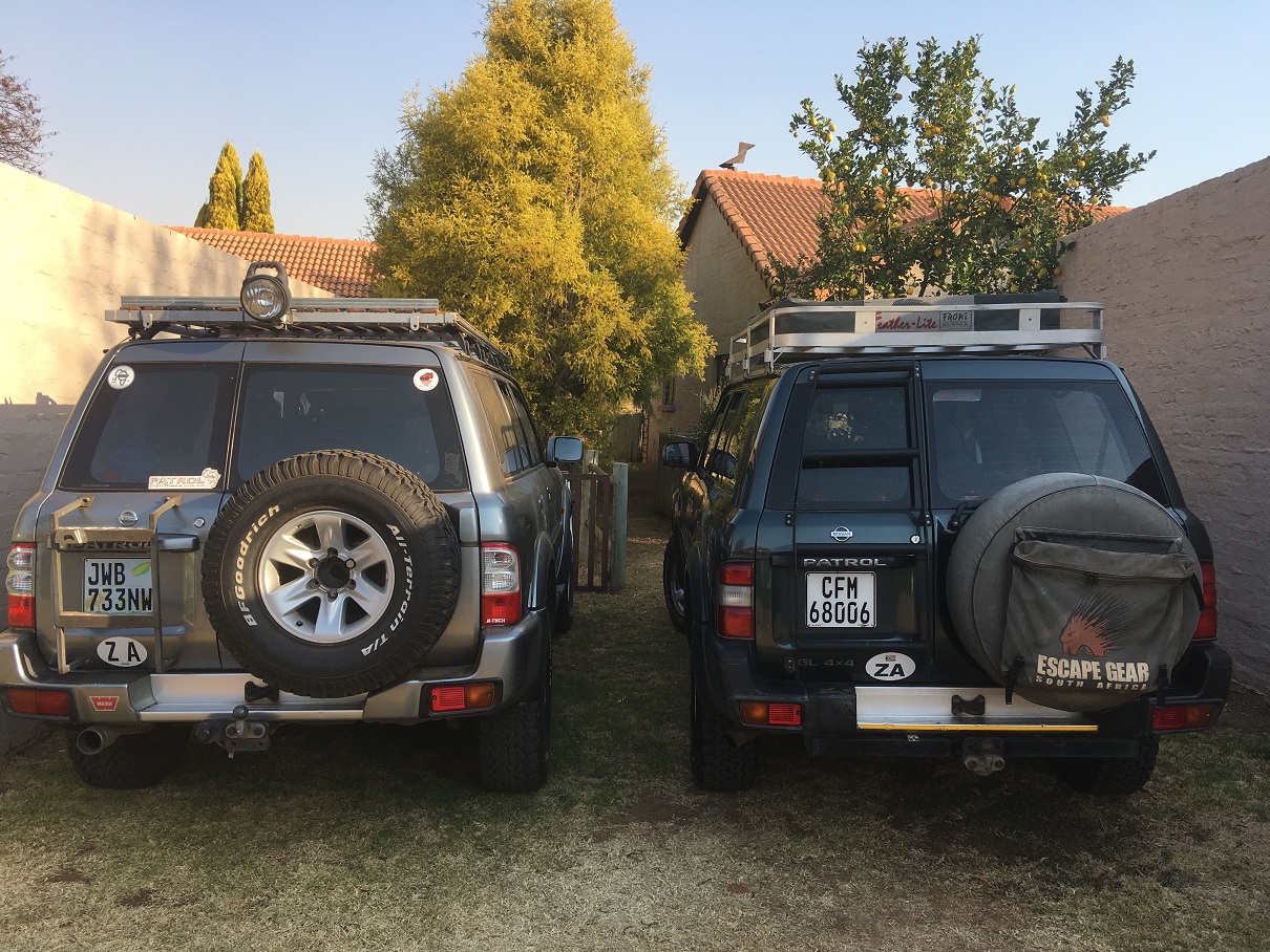

The 285s are quite a bit wider, but personally I think theyre the perfect fit. Below is a photo of the 285s on the 4.8 on the left, and the 265s on the diesel on the right. Not a great photo, but if you zoom in you can get an idea of the width difference.
