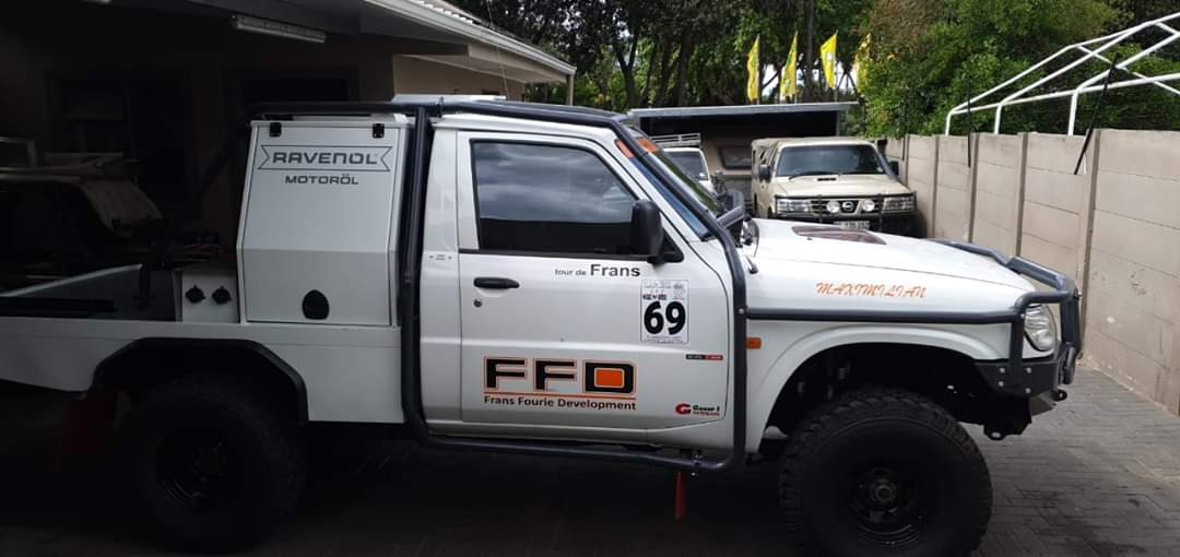

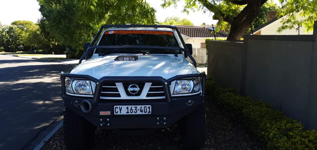

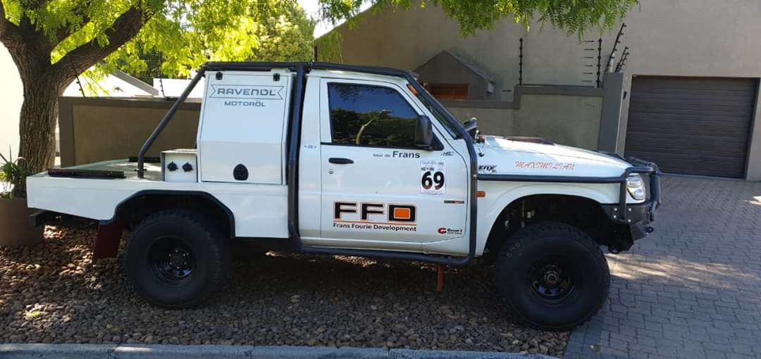

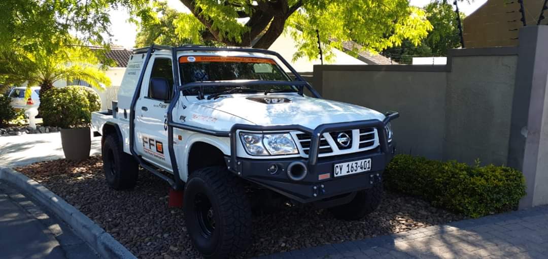

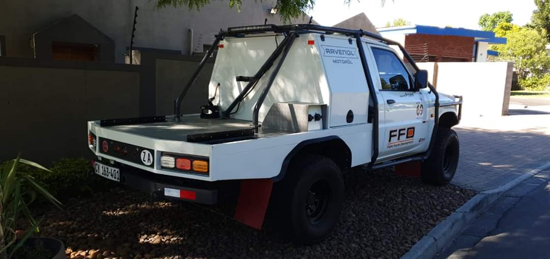

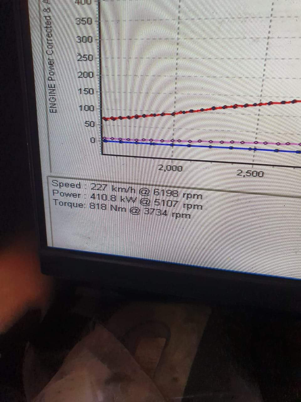

Then you will all agree, it’s no wonder that Frans Fourie (aka Tour de Frans) loves his 2009 Nissan Patrol Pickup with its 4.2 litre turbo diesel Y61 engine. There’s a lot to enjoy in this car built for the Namib dunes and camping in the wilderness – its awesome chassis (3 inch fox racing suspension) drive-train and comfortable cab, big wheels and huge power. Frans took the load bin off and had a flatbed built by C&A Productions and fitted an external roll cage. The front bar was built by BURNCO. The rest he did himself. The front axle is fitted with an air locker and the rear standard with its own limited slip differential. Drive-shafts, side-shafts and CV’s are all stock. He converted a 6.2L LS3 in to the frame with the standard transmission. Frans modified the engine with some stronger internals. The engine produces 320kW and 605Nm’s of torque. Then there's a little button Frans likes to push and the power then jumps to 410kW and 818Nm😁
