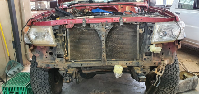

I will post some pics of how my front looked like when the bull bar was removed. Needless to say it was blocked with all the stuff in front.

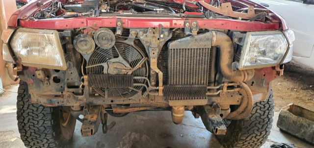

As you can see it was too full and it must have affected the airflow. Below is a picture of how it looked when everything was off.

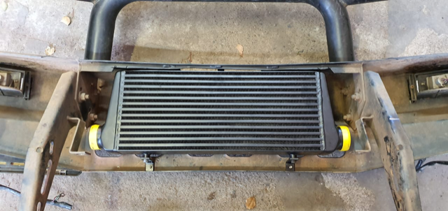

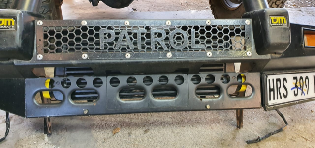

Extra holes was drilled into the bull bar for more airflow and the intercooler was mounted in the bull bar. Leaving about 300 mm between the radiator and intercooler.

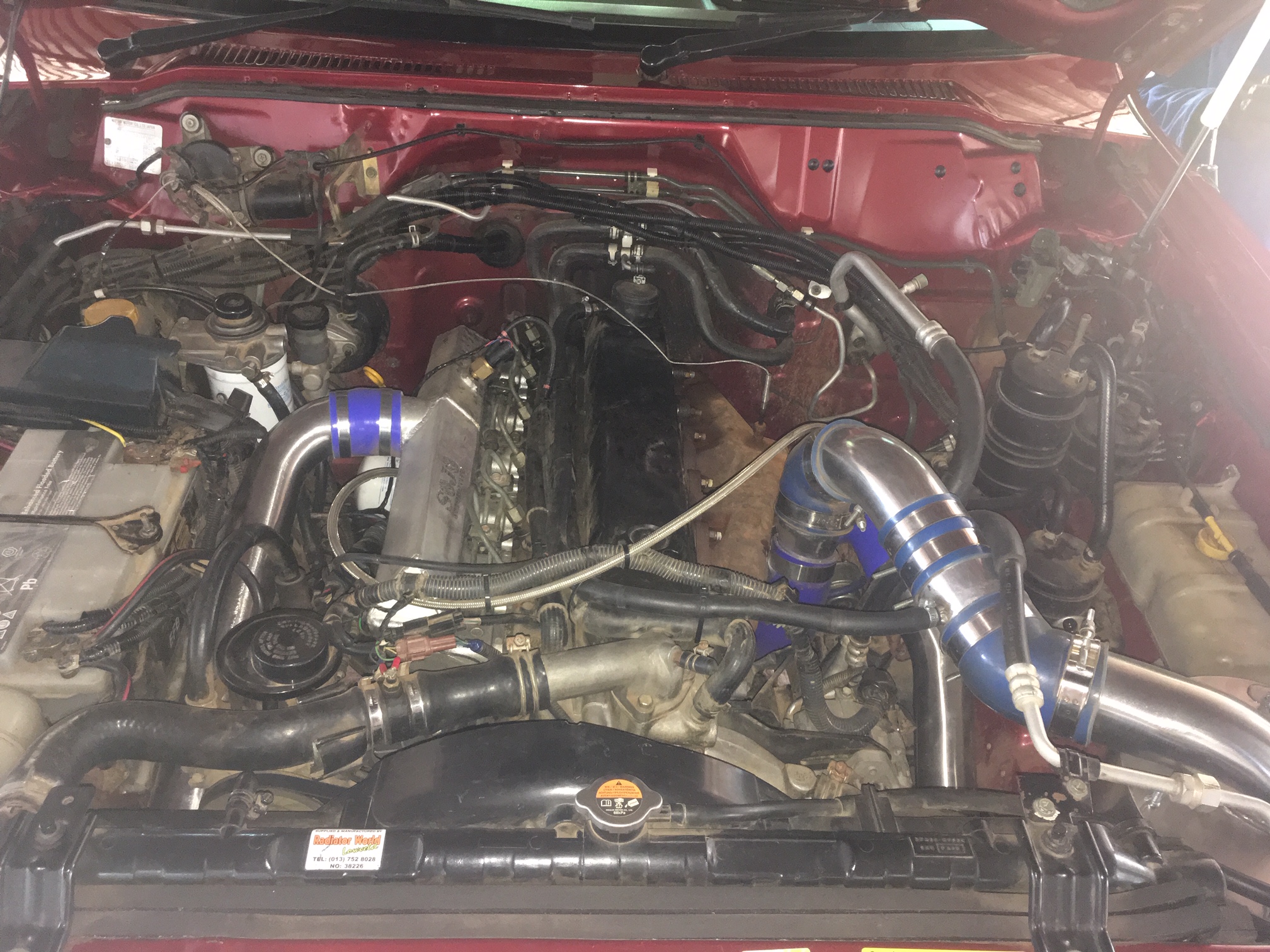

Michael's own design air intake manifold was fitted with a air filter box.
I got the car last Wednesday and drove down from PTA to Schoemanskloof. I was very surprised to drive the whole way 120 -130Km/hr and i could not get the EGT's over 500 and the water temps didnt once go past 91 degrees.
