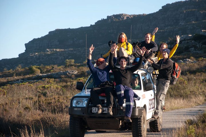

I reckon you can pretty much load anything on there provided you adjust your driving. This photo was a ton of weight on a heavy steel cantilever rack on a flimsy fibreglass canopy during a training exercise and no harm done
Sardonic Fattist
