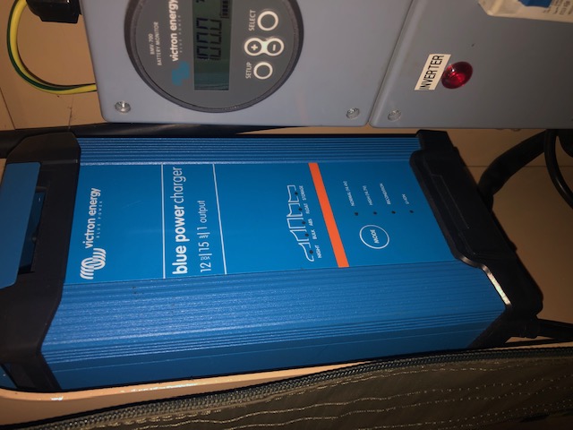

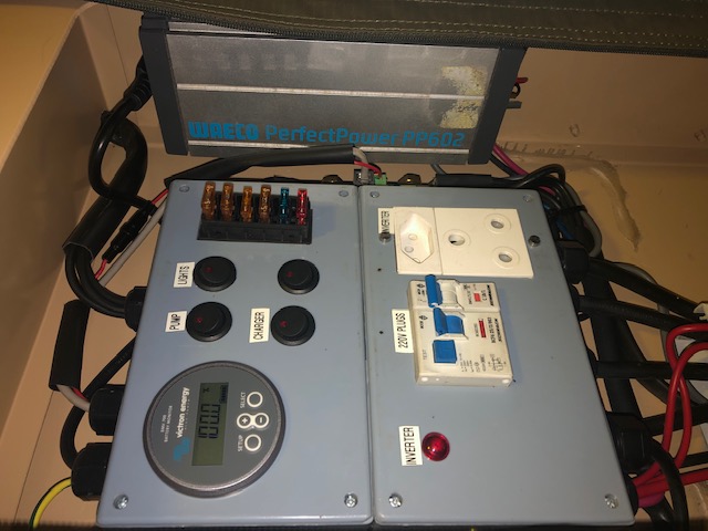

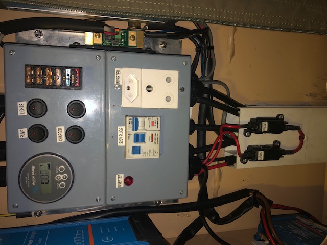

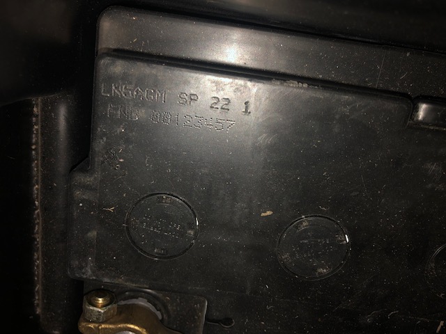

OK I chatted to Tinus and this is my Bushlapa set up.
I have two AGM 105 batteries in the Rooimier and all the electronics were redone using Victron hardware - pics attached I hope!
My Disco has two 30amp HCDP chargers - one charging to the Rooimier via a BH plug - the other for the battery box (I have a NL in the car) for the small 32 lit Engel.
Plus a direct BH plug to run the portable compressor directly connected to the charging battery with a fuse.
Sooo The Patrol is now the chosen retirement /photography vehicle (its been a very difficult choice!) so I need advice - do I remove the two HCDP 30amp chargers from the Disco and fit them to the Patrol - I don't have a monitor in the car to check charging, but the battery box has an indicator on the side (by the way I have not bought a battery for the box yet!).
The Rooimier has a 120 solar panel fixed to the roof and I have bought a semi flexible 100w China job to plug into the BH I had fitted at the back of the van with a 6m lead to put in the sun.
I need a couple of Hella connections in the car and a BH or two as we plan to do some fairly long solo (Rob and Jan) trips into Southern AfrIca taking mainly landscapes and a bit of wildlife.
My auto electrician is pretty sharp, but any/ all advice will help as I want it right the first time.
My Disco drawer system will fit it looks like (a Front Runner), and I need to almost design a reverse single draw system for the photo gear - I don't mind removing the second row of seats or remove one half of them.

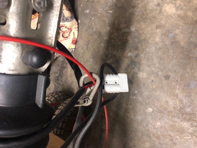

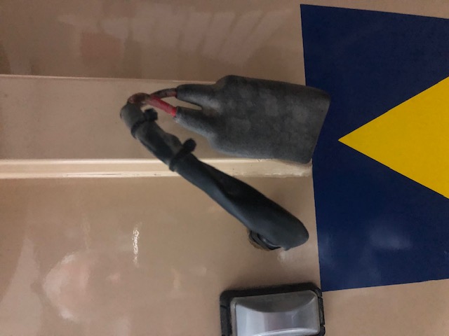

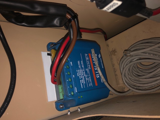

Re: Charging caravan batteries
Sorry more images!
The BH on the pic connects the 100w solar panel to the system.
The pic of the battery is from the top as they are a mission to remove!
The BH is the charging from the 30amp HCDP from the Disco.
Rob imho there is no dc charger in there other than the solar one ....def aggregated glas mat batteries so you would want to change above 14.7 at least
I would put the charging senter in the caravan and then just connect the bh to the car to much volt drop from the front .
What voltage is the hcdp putting out ?
The ctec is great with this ...but lets see what you measure
T
