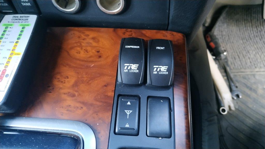

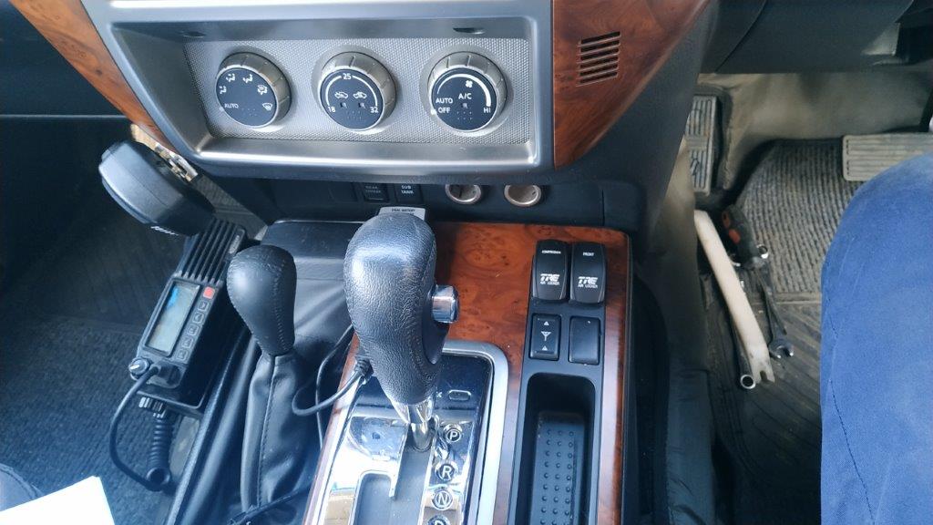

I fitted a TRE front locker to DawidT's 4.8 auto. Very nice piece of kit.
I also did a transmission oil replacement, new fuel pump and fuel filter.
I also fitted a new head unit with GPS
Here's the pics:
Locker switches 1.jpg (69.74 KiB) Viewed 8770 times
Locker switches 2.jpg (91.57 KiB) Viewed 8770 times

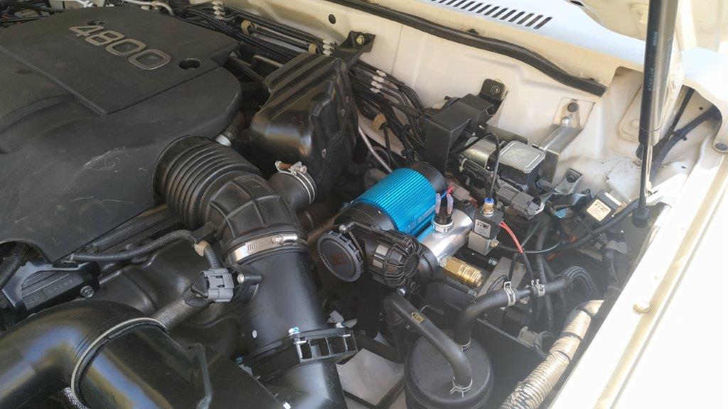

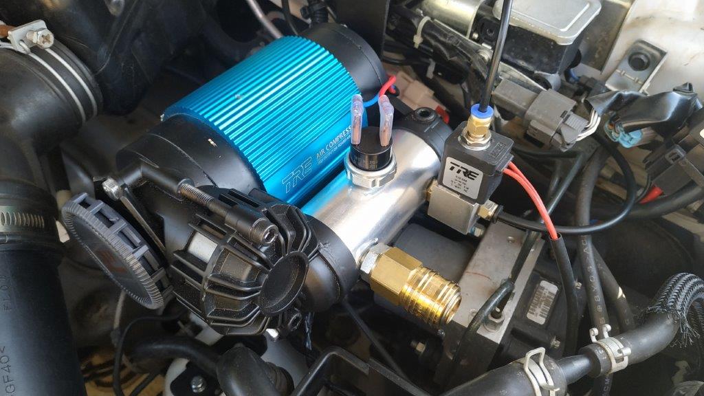

I made a custom bracket to mount the locker compressor
Locker compressor 1.jpg (100.5 KiB) Viewed 8770 times
Also added a quick release coupler for an air hose for pumping tyres
Locker compressor 2.jpg (90.14 KiB) Viewed 8770 times

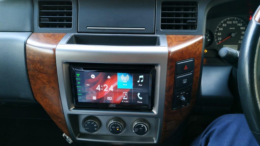

A really nice little JVC head unit
JVC Head unit.jpg (79.94 KiB) Viewed 8770 times

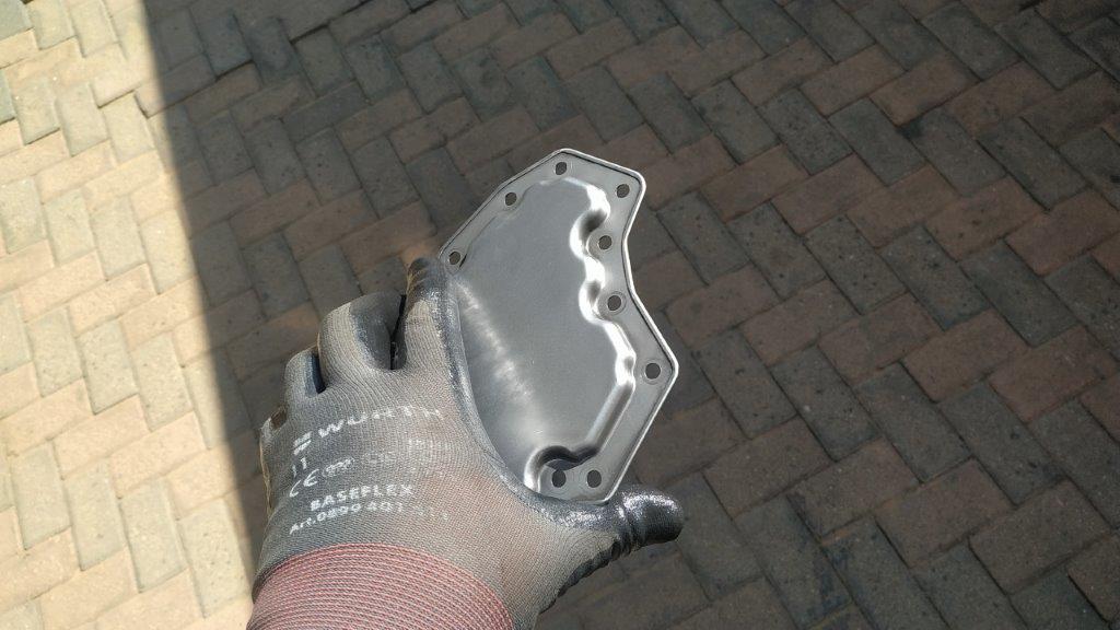

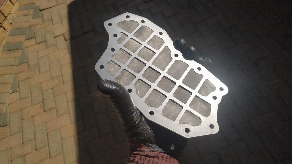

Part of the transmission oil change I remove the transmission sump, clean it and clean the filter.
Trans oil pan.jpg (83.04 KiB) Viewed 8770 times
Trans filter 1.jpg (81.49 KiB) Viewed 8770 times
Trans filter 2.jpg (68.18 KiB) Viewed 8770 times

Was the auto box filter clogged up? If so, how bad?
How many litres of oil came out? 6 to 7 litres?

Just some info, the Patrol has less than 80 000km on the clock. Most of this driving was done towing an off road caravan and doing off road work. The gearbox oil change was more preventative work. The fuel pump was also changed - great improvement on power.
The front locker was about R13k (Tinus is this correct?) to buy, excluding the installation done by Anthony. Will try it the next couple of weeks as we are leaving for Botswana and Namibia today :blonde:
Re: DawidT 4.8 TRE Front locker (and other stuff)
Jip thats the hole thing compressor harness all in
