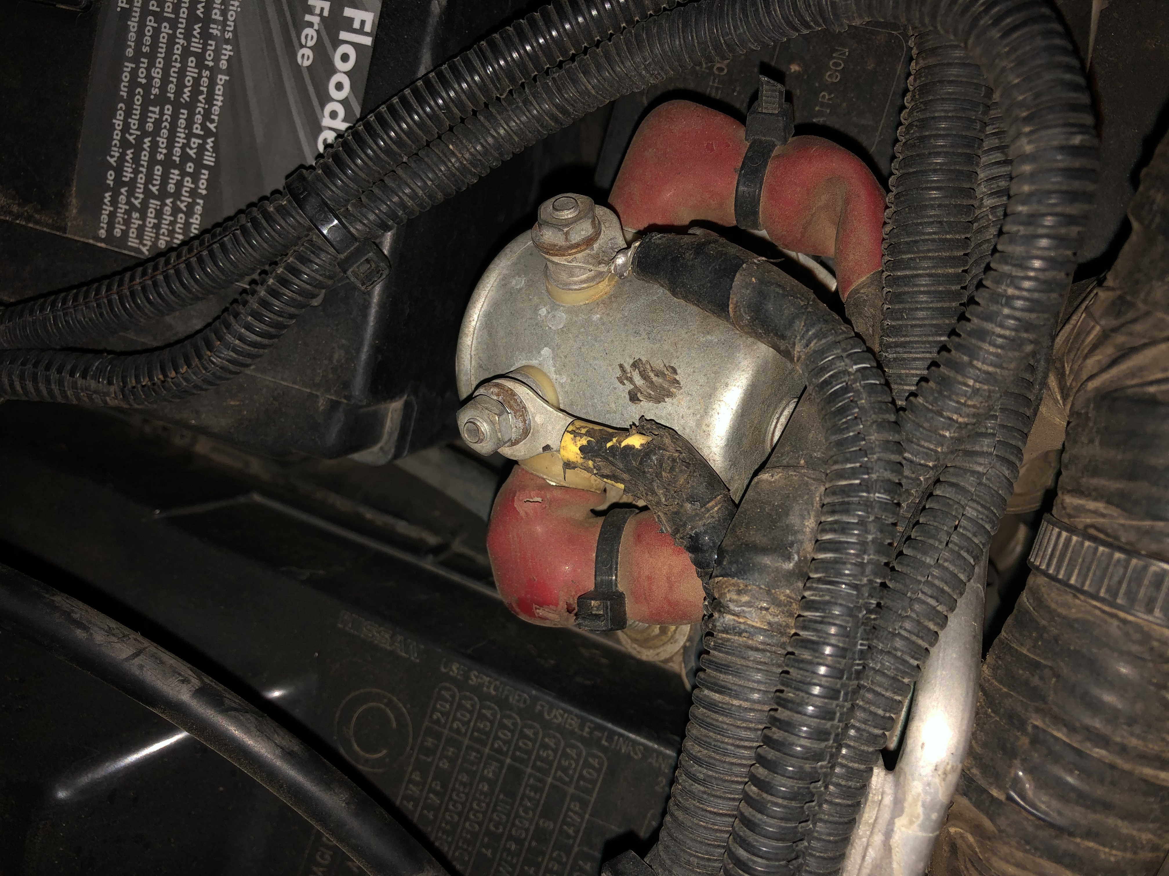

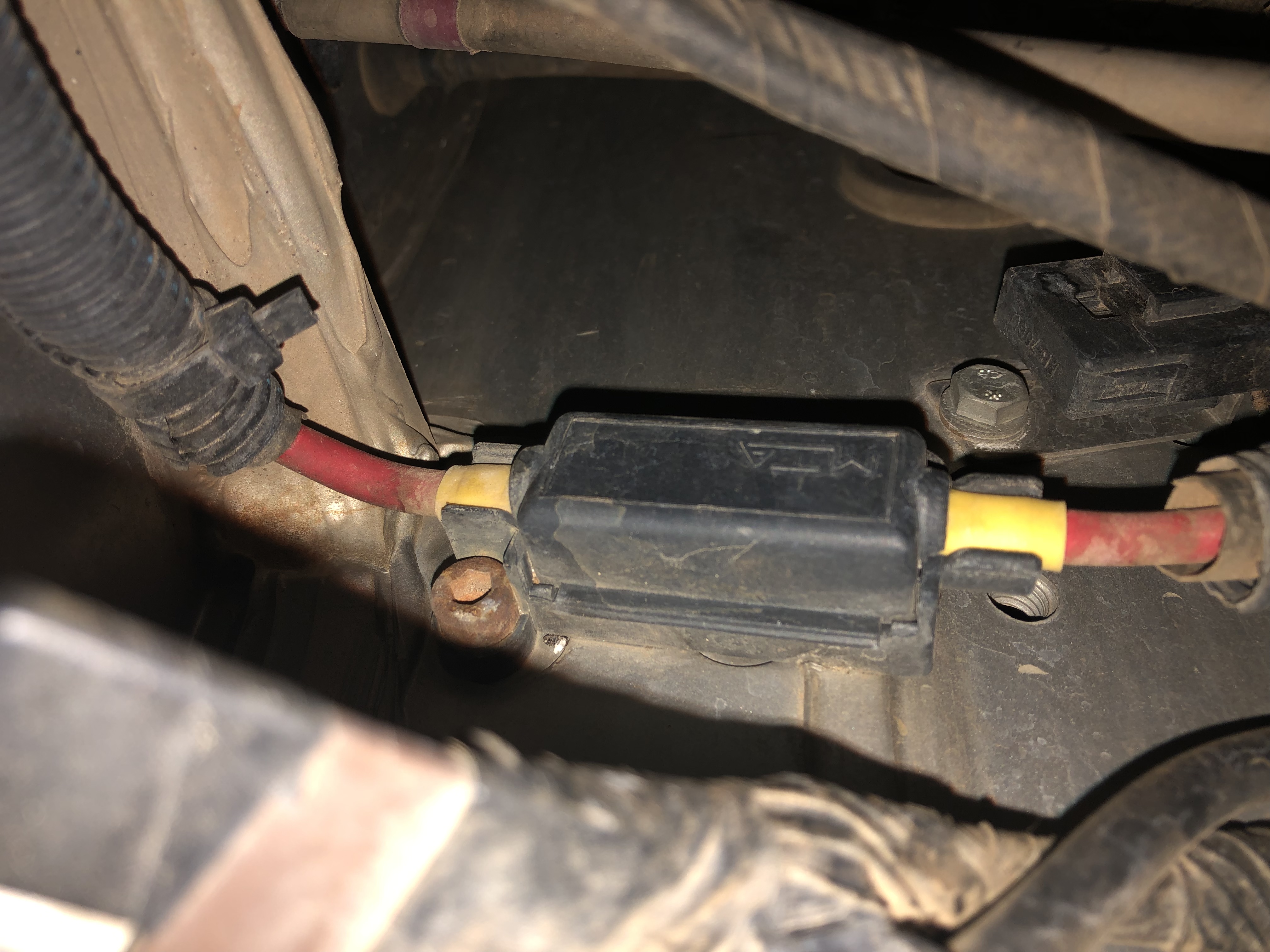

Great thanks. It seems there a solenoid and the fuse fitted. Also traced the wite to another harison plug hiding in the boot.
It seems it will be a easy setup from hereon.
So will this sytem prevent the car battery from being drained when car is switched off?
Love my Car more and more :woo:

The fuse is good, but take that solenoid and throw it as far as you can. Those things waste power when they get old.
The setup of the charging system in the caravan must be such that it either only accepts power when the car's engine is running, or if there is more than 12.8 Volt available. Either way will protect the car's battery.
