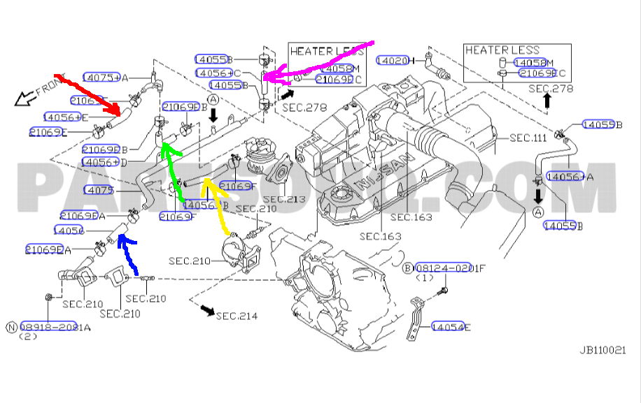

In any case, on the 2nd January, I lost the first pipe. In this case, it was the first pipe running underneath the engine cover (highlighted red in the image below), which is the one side of the throttle assembly and oil cooler bits.

Yesterday, I lost more pipes. The pipes which failed catastrophically, was the 90 degree pipe running down to the oil cooler (green). I also noticed that the pipe running from the thermostat housing to the metal heater return pipe (blue), was also dodgy. And it appears as this may have also been leaking as a result of the coolant spray patterns on the block next to it.
Thankfully, this occurred in Brits, and the Madman CLD picked it up. Motor was still 100% in normal temperature range when I shut it off. Was just driving out of Brits, when the alarm went off. Stopped at the garage just outside town and noticed the truck was losing water. I let everything cool, refilled and bled, and drove back to home, whereafter the whole process of replacing pipes actually started.
Replacing them is horrible, but possible. Just be prepared to speak a lot of foreign in the process. Apart from the 90 degree pipe running to the oil cooler, as well as the heater hoses on the back firewall, which can apparently only be obtained from the dealerships (or possibly Terrain Tamer as well), all pipes are very generic, and you can get them at any spares shop. Graham gave me an alternate part number for the oil cooler pipe - RH7013 or PH0001. It's a pipe which is a little longer on both ends, but the correct diameter, and the ends can just be trimmed off to the correct length.

I removed the battery, as well as the alternator so that I would have (barely) enough space to get at the various pipes from the drivers' side of the vehicle. After this, I carefully removed all the hose clamps on the pipes. After some attempts at getting the pipes off, I ended up getting some advice (thanks both Peter Connan and Graham) and used a Stanley knife to cut the pipe length ways where it attacked to the steel connectors. After this, the hoses came off relatively easily.
After getting all the pipes I required (all those marked highlighted in the image), new jubilee clamps and trimming the pipes to the correct lengths, I started the process of reassembly.

Firstly, I removed the 12mm bolt holding the metal bit running to the throttle body and oil cooler (green in the image below) and removed that bit from it's normal position underneath the throttle body. And then I put the various pipes onto the thing with clamps loosely fastened.
Next, I removed the 2x 12mm bolts which hold the metal heater return pipe (red in the image below) to the inlet manifold. This would give enough room to install the new pipes. At this point, I firstly installed the long pipe running from the oil cooler to the heater return pipe (yellow in image 1).

I did not tighten the clamps too tightly, as I wanted some play for installing the pipe on the end of the heater return assembly (blue in image 1). Once these two pipes were on, I tightened the clamps on all the pipes.
Next, I maneuvered the other piece I had removed and partially connected "off-vehicle" (the green bit) into it's spot underneath the throttle. I first connected the pipe which runs up to the throttle assembly (purple in image 1), as it made the most sense to do it first - ie: so I could move the bit around a little. Next, I connected the thicker pipe (red in image 1). Finally, I connected the 90 degree pipe which runs to the oil cooler (green in image 1). Only at this point, did I tighten all the clamps on the pipes.

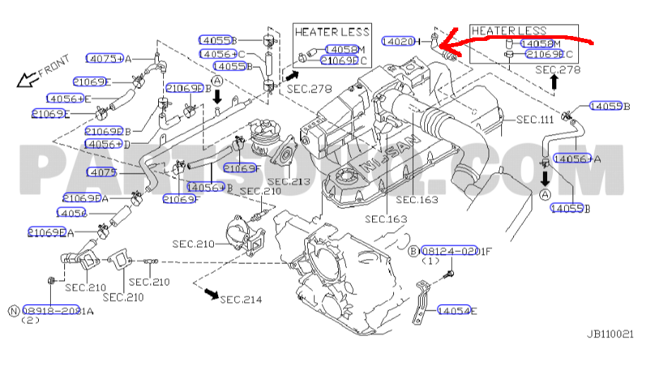

So, apart from the age of the pipes, the possible reason for the recent spate of burst pipes seems to have become apparent.
My truck went in for a service at G-Tech today - it is due for a service, but I also wanted Graham to go over my water pipe repairs. I've sort of become paranoid about it...
The metal pipe (highlighted in the image below) which connects the block to the heater hoses, seems to have a tiny, tiny leak in it. This is apparently, either corrosion or the solder which keeps the 90 degree pipe attached to the bolt having broken. In any case, this probably meant that despite things having been bled and similar, a tiny bit of air may have entered the cooling system, which may also mean that the pressure within the system was not perfect.
It's really a very small leak, as I've not been losing any water, maarnouwat. Ons kyk en sien hoe speel hy uit...
