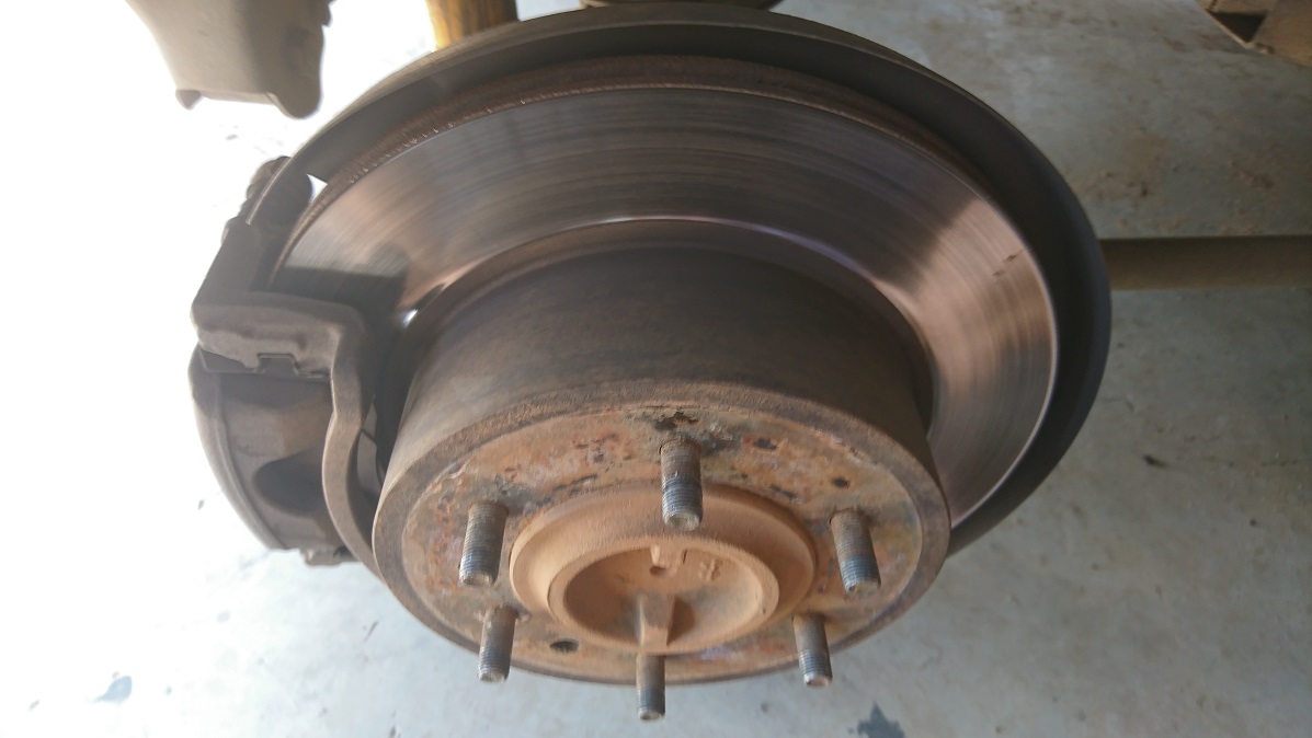

  • Loosen wheel nuts and jack up car and remove wheel
  • Remove complete brake caliper assembly
  • Spray Q20 where rotor seats onto hub ( this is optional as i only did this on the first side I did)
  • With the 2 pound hammer, I gently shocked the old rotor off

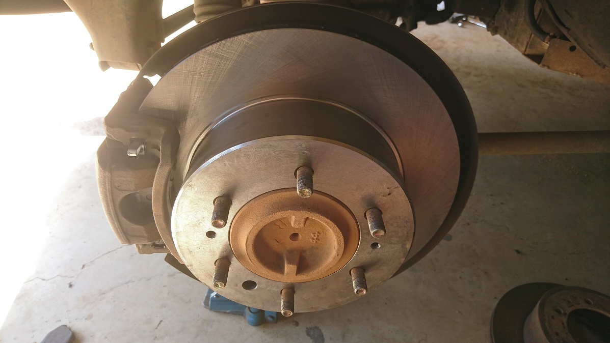

  • Clean the area and put the new rotor on.
  • Simply follow revers order to finish, and take your last sip of your drink
