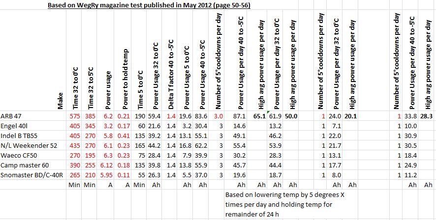

Here is a screenshot of the fridge power calculations:
As you can see, opening the fridge makes a huge difference to how much power one needs. It makes far more difference than increasing the temperature differential.
This goes a long way toward proving that the best way to conserve power is by careful planning of how you pack you fridge and keeping it closed as far as possible.

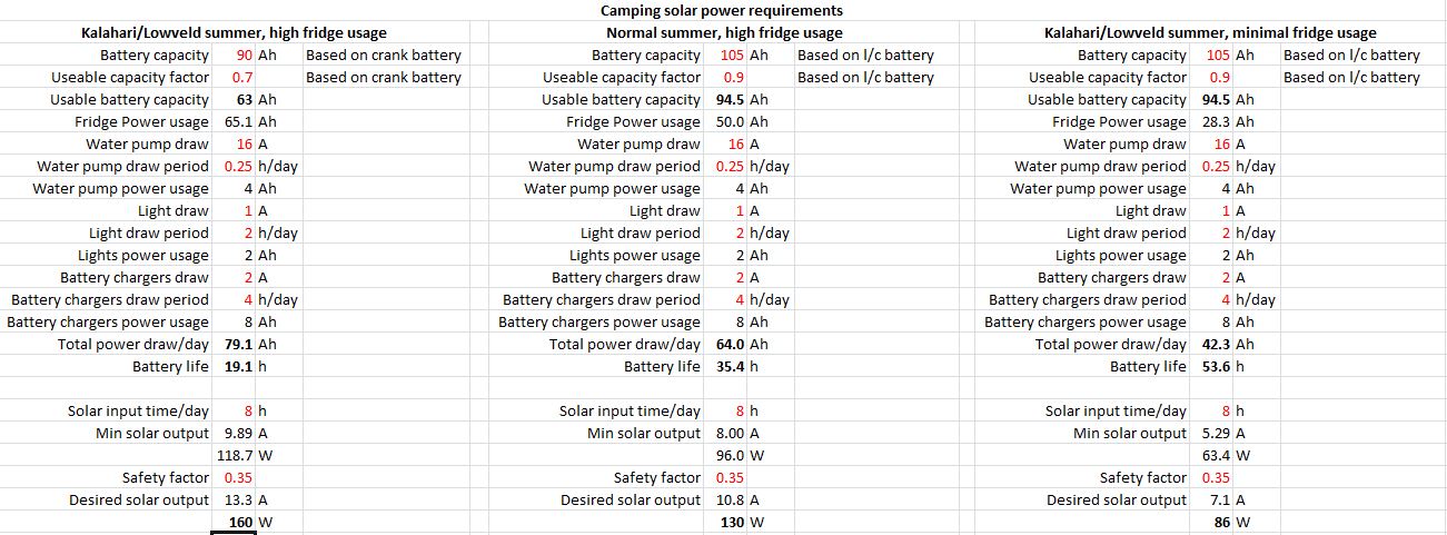

The reason I started doing calculations at all was because of a conversation with a friend about solar panels, and the ensuing desire to figure out how much solar panel one actually needs.
This is is thus an attempt to determine how much solar capacity I would need to be able to park my trailer effectively indefinitely and keep the electrical system going, but I also calculated how long the battery would last. For this, I also added a few other loads, being a little bit of water pumping, lights and some charging of batteries.
Here are the results of a couple of scenraios:

And here is the spreadsheet, if anybody wants to have their own fiddle:

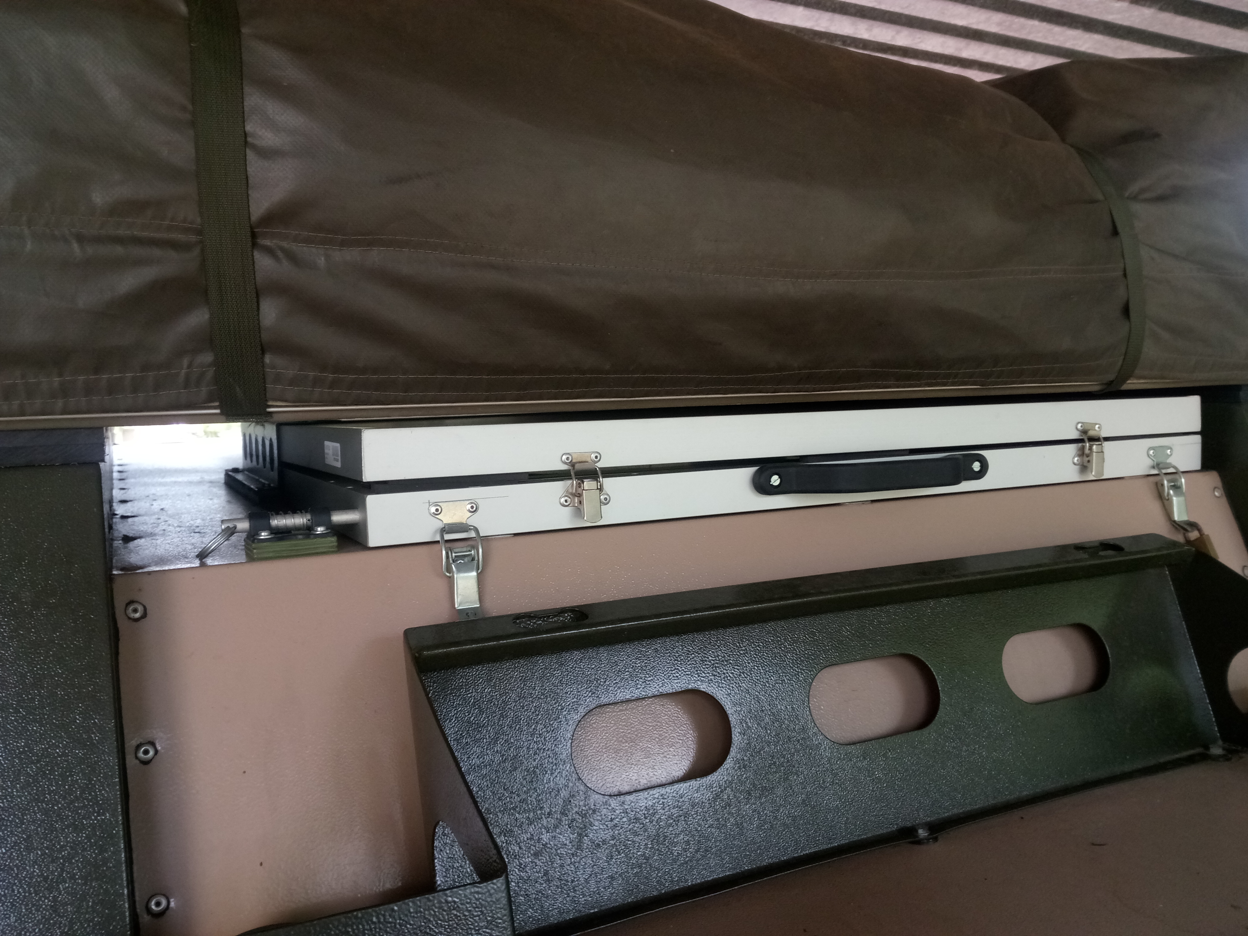

In the trailer I have 2 X 80 W panels that I hinged and fitted under the tent (had to raise the tent by 20 mm which was a mission and a half) connected via a CTek D250S to two 105 Ah deep cycle batteries (got them with the trailer but will change to AGM once they are kaput). This runs the pump, LED lighting and a double door Snomaster 76 l Expedition Series (thick insulation). This fridge is used purely as a deepfreeze, ice storage and for ice making. Ice is only made during the day on sunny days. At worst this fridge is opened 6 times a day. Under ideal conditions the panels give me 9 A and the fridge draws 5.5 A at it's worst so I am safe.

You will see in my calculation there is a safety factor of 0.35. This is to compensate for things like panel angle, dirt on the panel and the fact that that panels actually get less efficient at high temperatures. Oh, and a good long lead as well.
