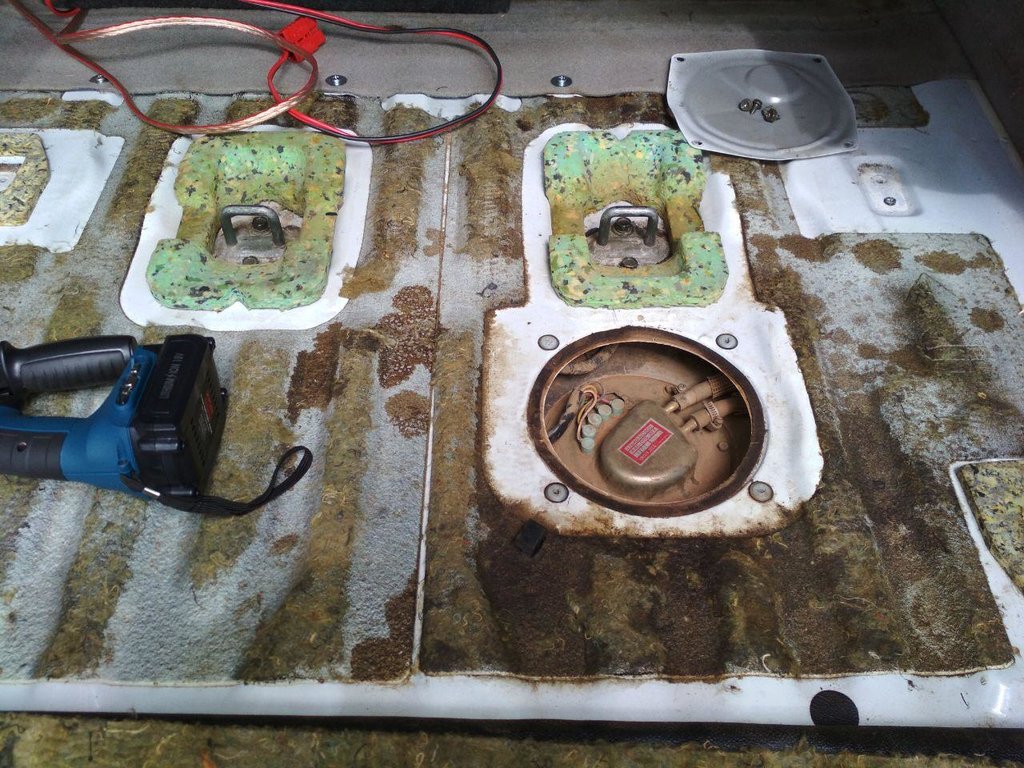

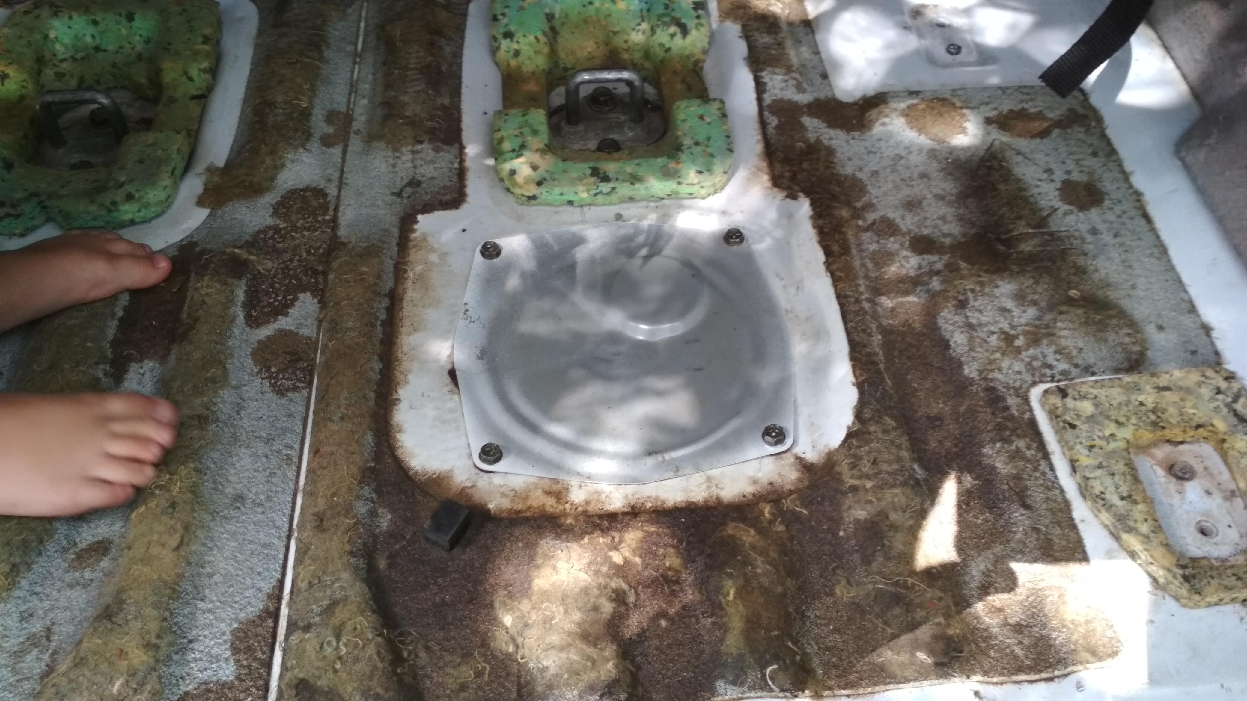

Fortunately there is an axcess cover in the rear load area. Lift the carpet, and look for a cover held on with three bolts. Remove the cover and you will see the tank's top cover.
Unplug the electrics seperate the hoses, remove the bolts and lift the cover. The fuel level sender and pump will come with it.

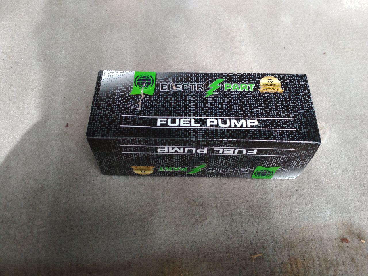

At Midas they had the Bosch in stock but it was much more expensive than I was led to believe at R770. Not a train smash but they took pity on my as the old man tagged along. He asked for the pensioners discount. The attendant zipped to the back and came back with another make, but identical model to the above and applied a generous discount. We walked out with a R350 3.8 bar pump.
The pump is labelled Electric Part EP38010A. Never heard of it, but it looks identical to the Bosch. It was a straight swap, with no rewiring or new lugs to worry about.

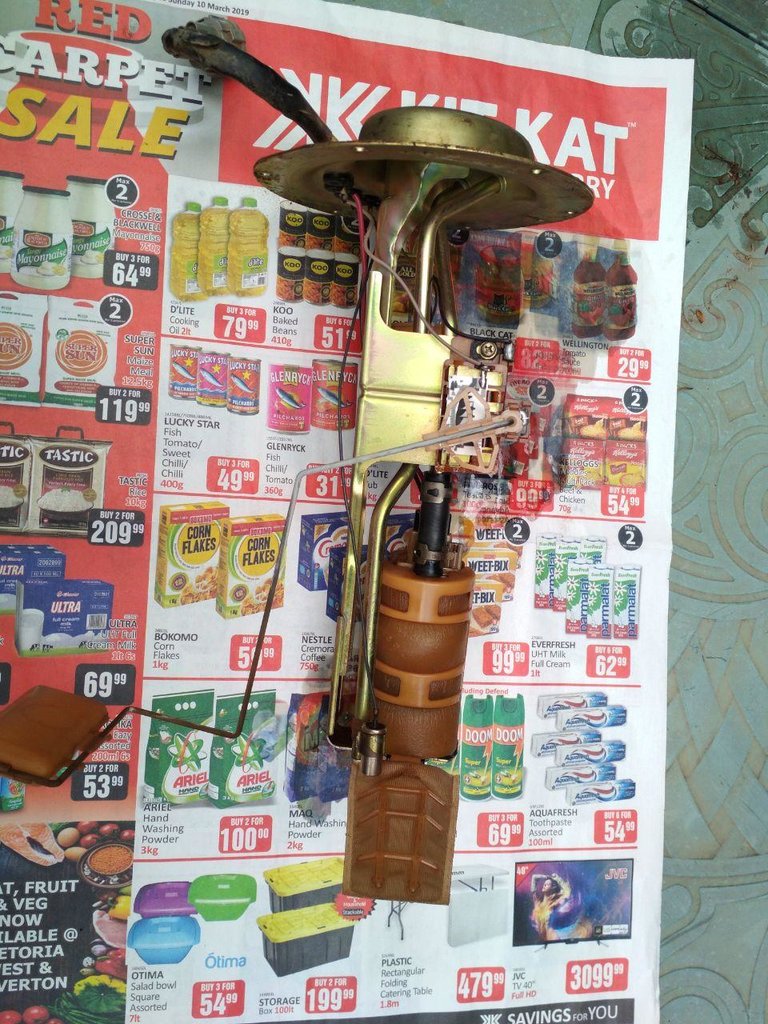

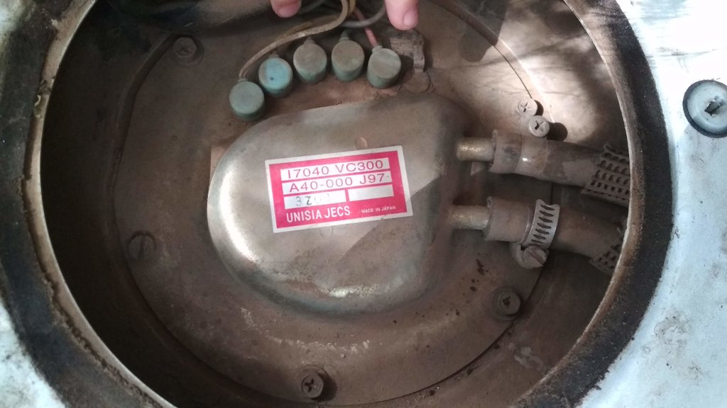

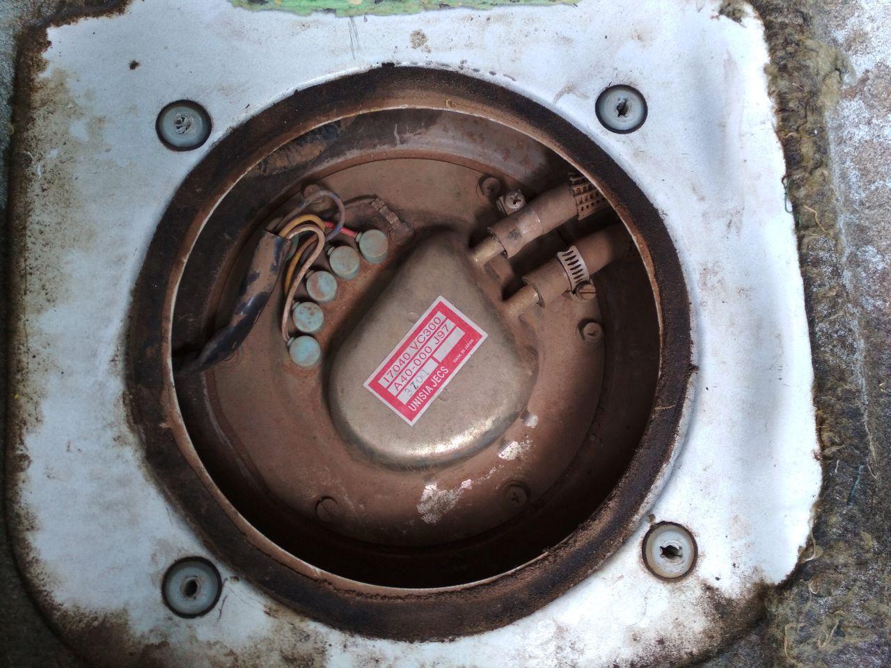

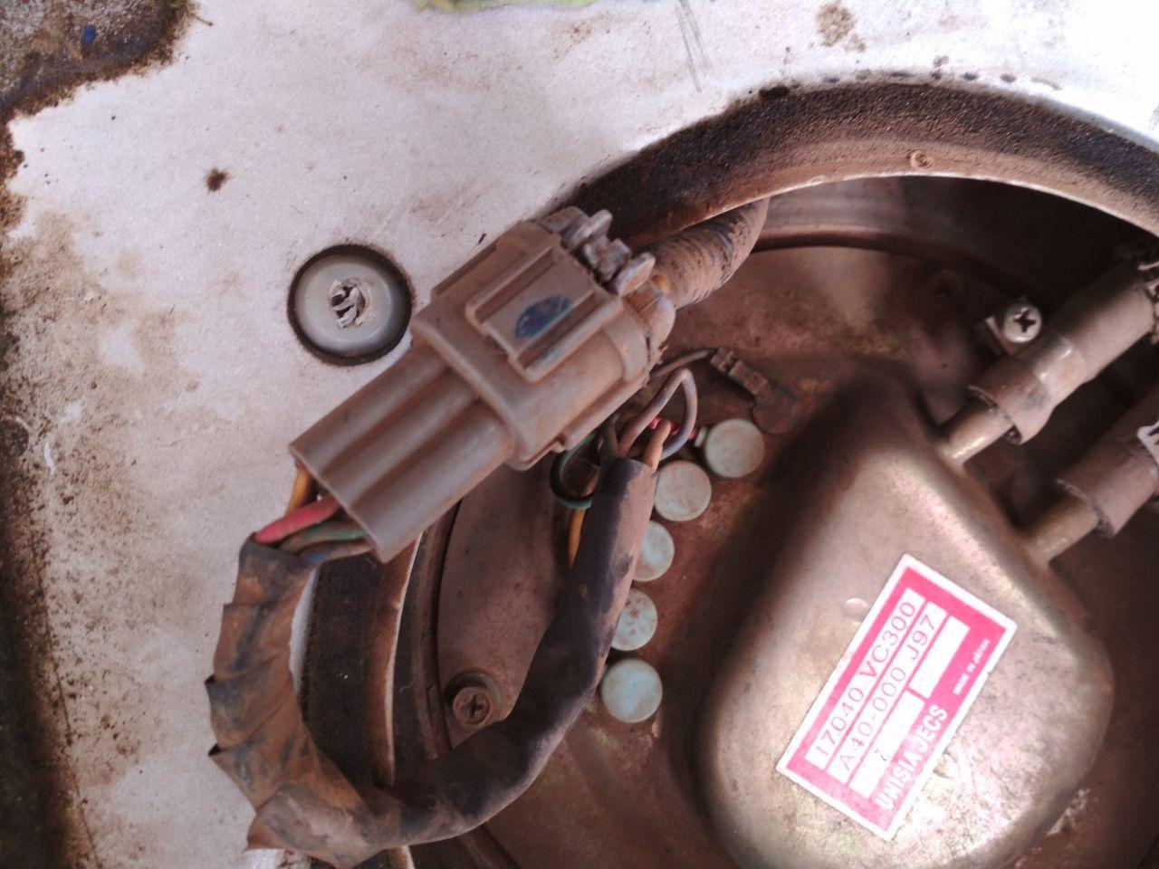

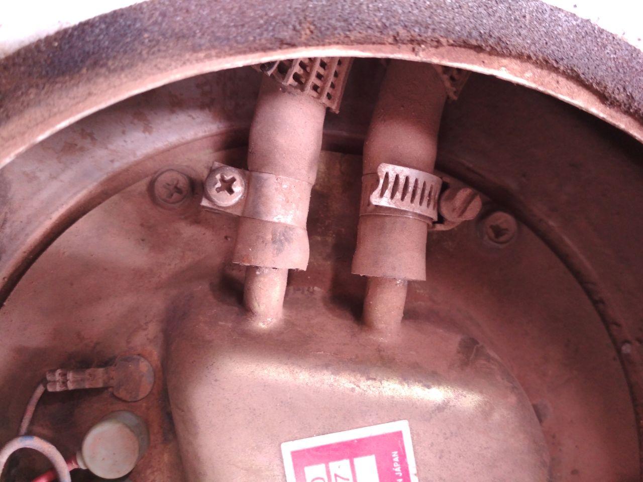

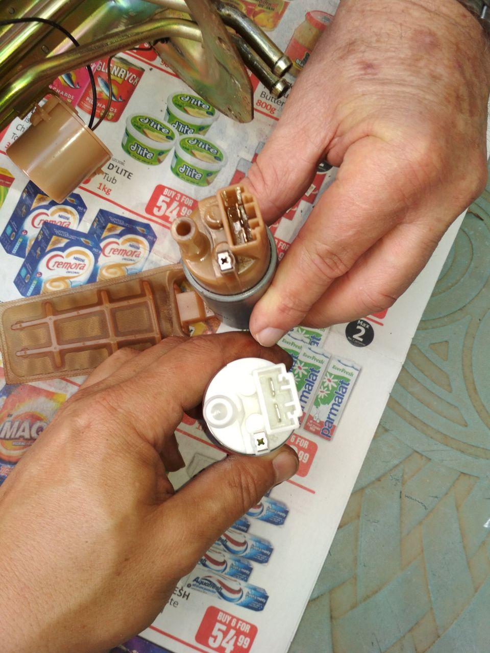

The carpet comes out with the tie downs removed. Removing the cover reveals the pump assembly with fuel lines and wiring. There is just one plug for the fuel pump and float. From this plug I could see the tank has been removed before. Someone struggled to disconnect it. If you're going to replace your pump, do not make the same mistake and disconnect the fuel lines before undoing the screws holding the pump assembly in place. If you do, and there is any pressure in the tank your precious fuel will come pouring out in large quantities. Undo the screws, and then remove the fuel lines. The pump assembly with pump and float. The electric parts box. The old pump is discoloured but looks exactly the same as the new one.
