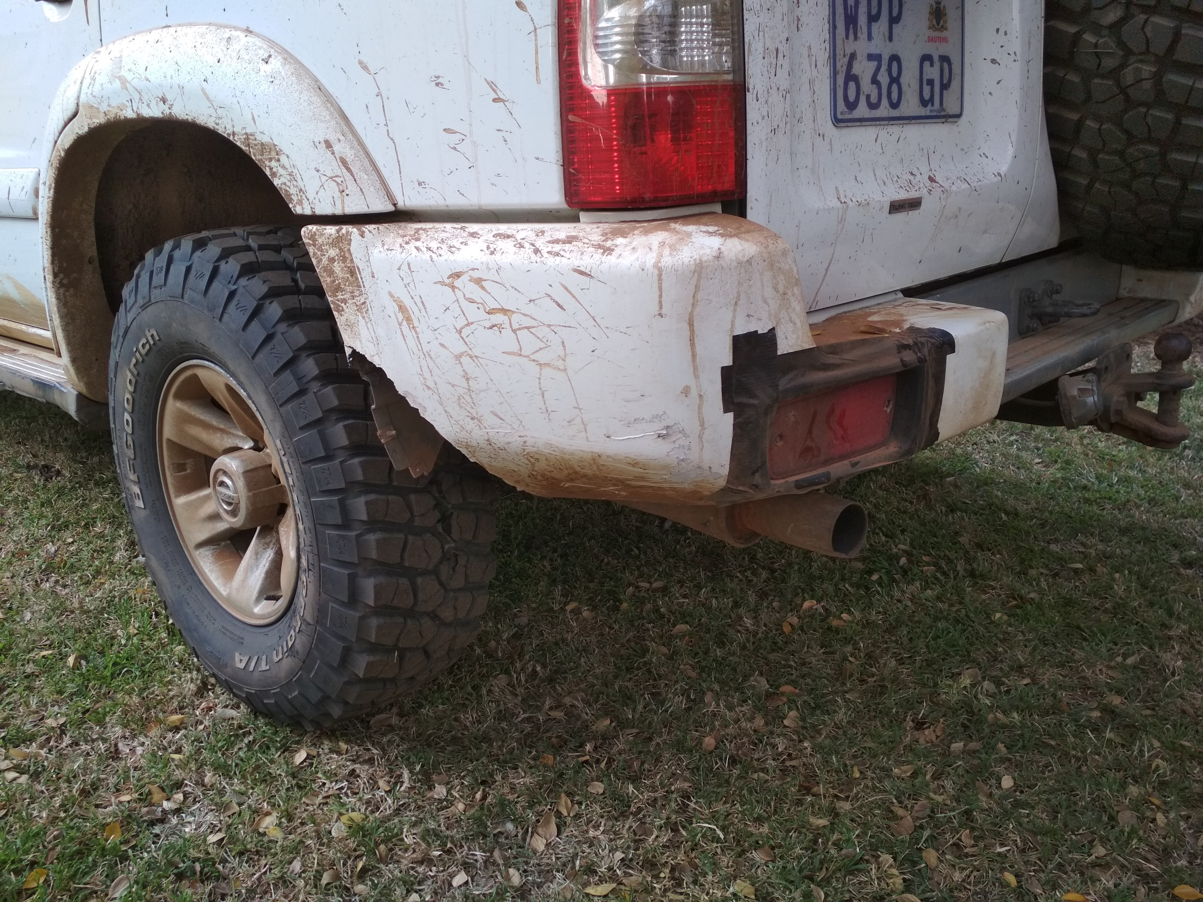

At this years Rust de Winter Jamboree my Patrol had a disagreement with a boulder during the decent. There were a few in fact.
The other side is a little bit better but not by much.
I toyed with the idea of fixing the bumper and a member of the forum even donated a set that I can clean up and respray. But I suspect I'l just rip the bumper off the first chance I get. I also considered building one but I just don't have the time.
What good options for a rear off road replacement bumper are available in travelling distance from Centurion? Read that as I can't pickle down to Cape Town for a Burnco bumper.
