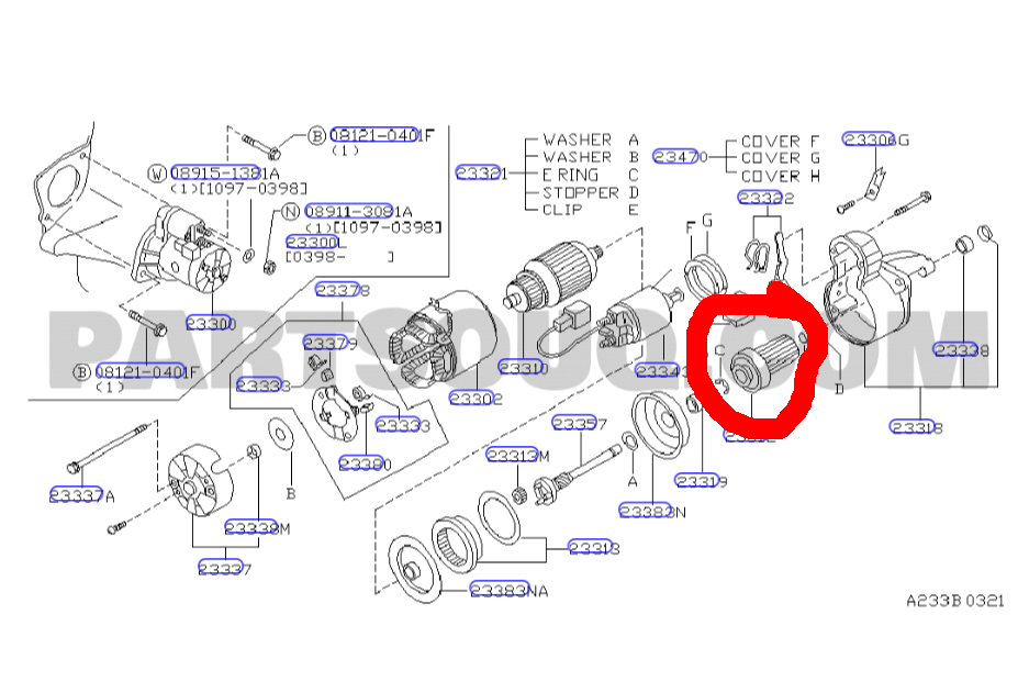

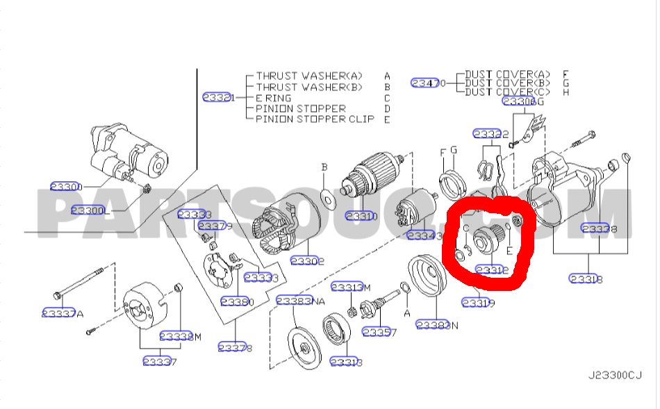

Images on PartSouq also indicate that the starter pinion gear on the 4.5 is considerably longer than the 4.8 (highlighted red on the images below).

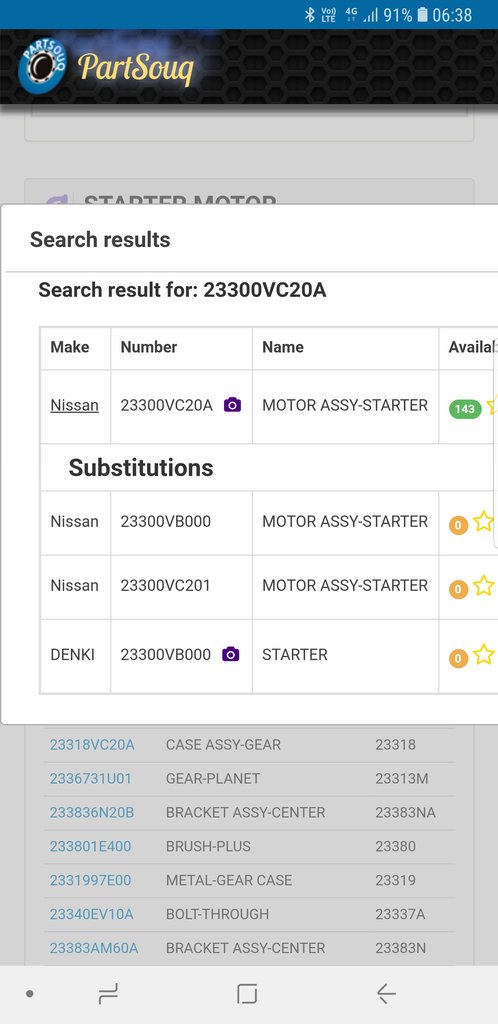

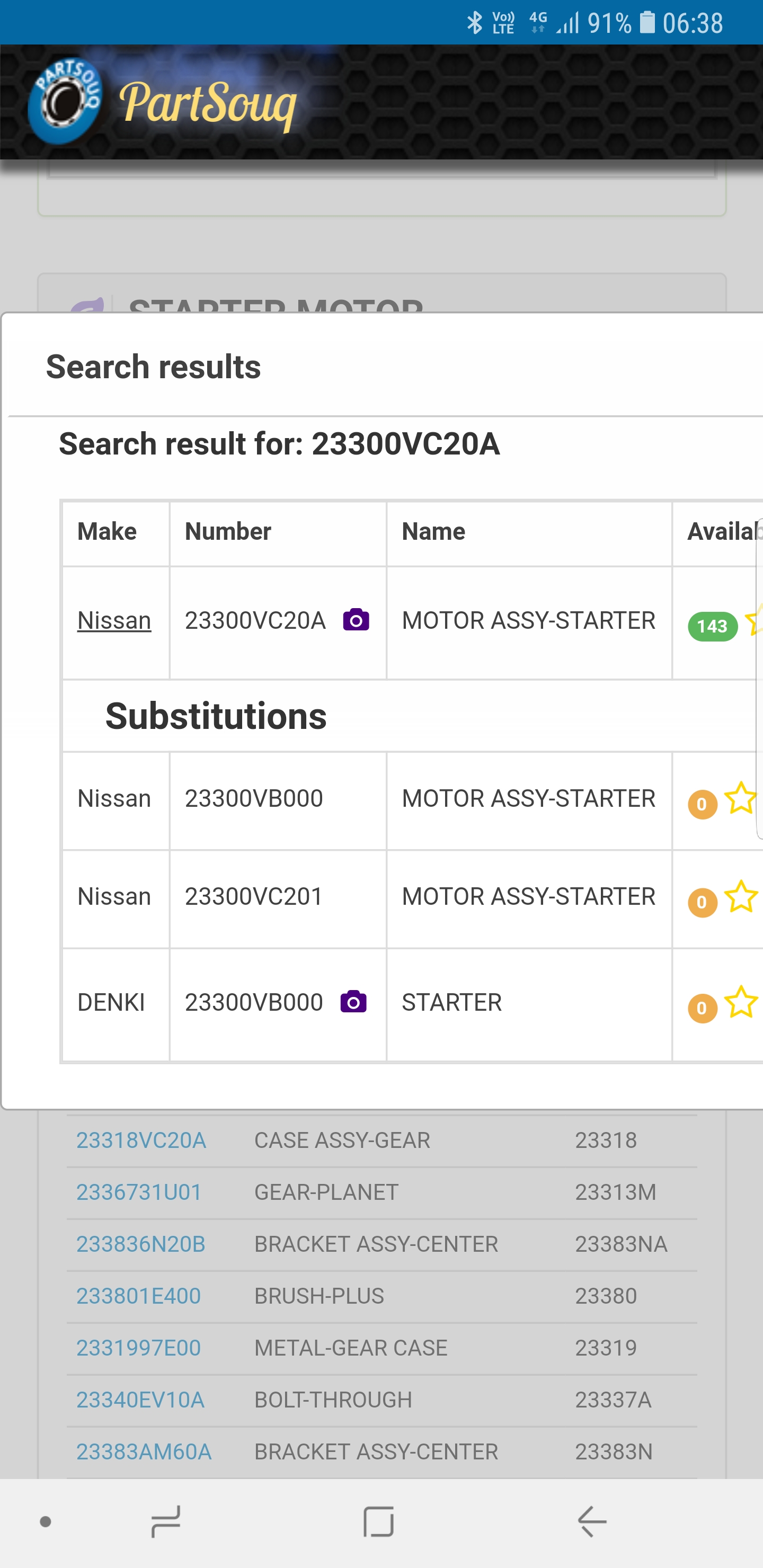

One other thing I just spotted. When using the VIN of a facelift 4.8 AT on Partsouq I get another part number.
But interestingly, it gives both your and JP's starter part numbers as substitutions........ so should work
