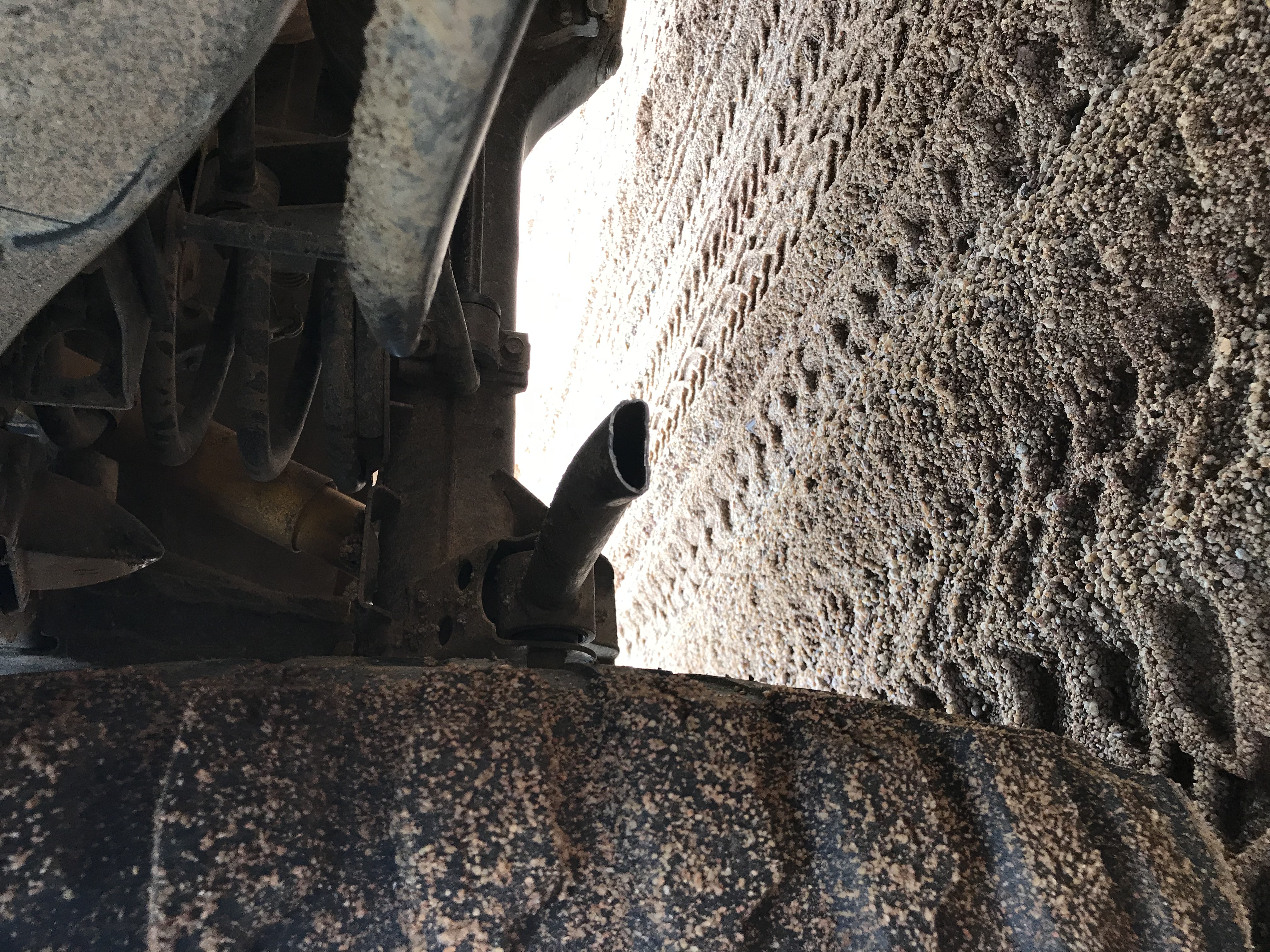

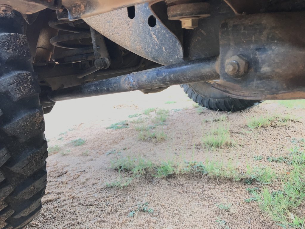

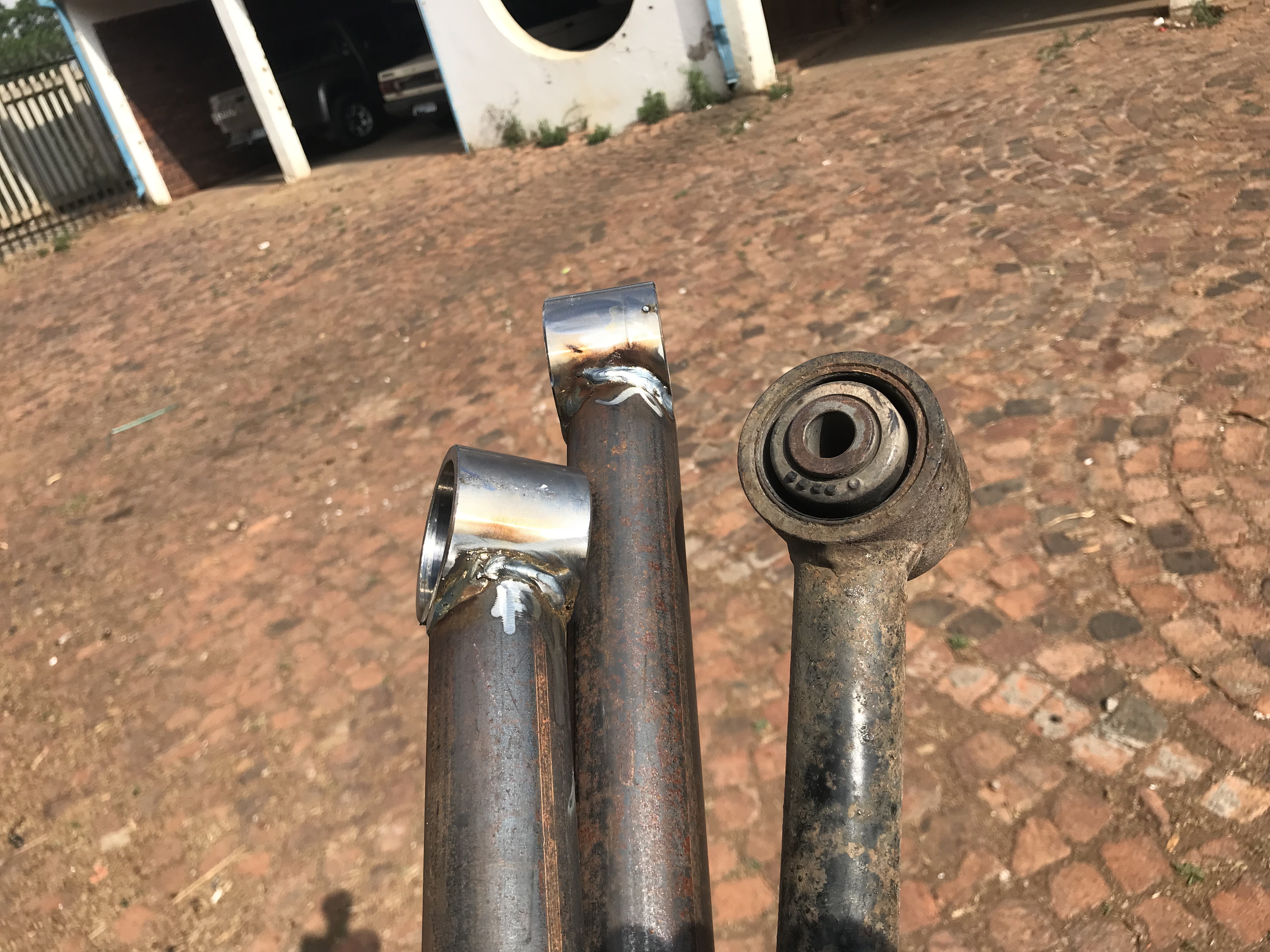

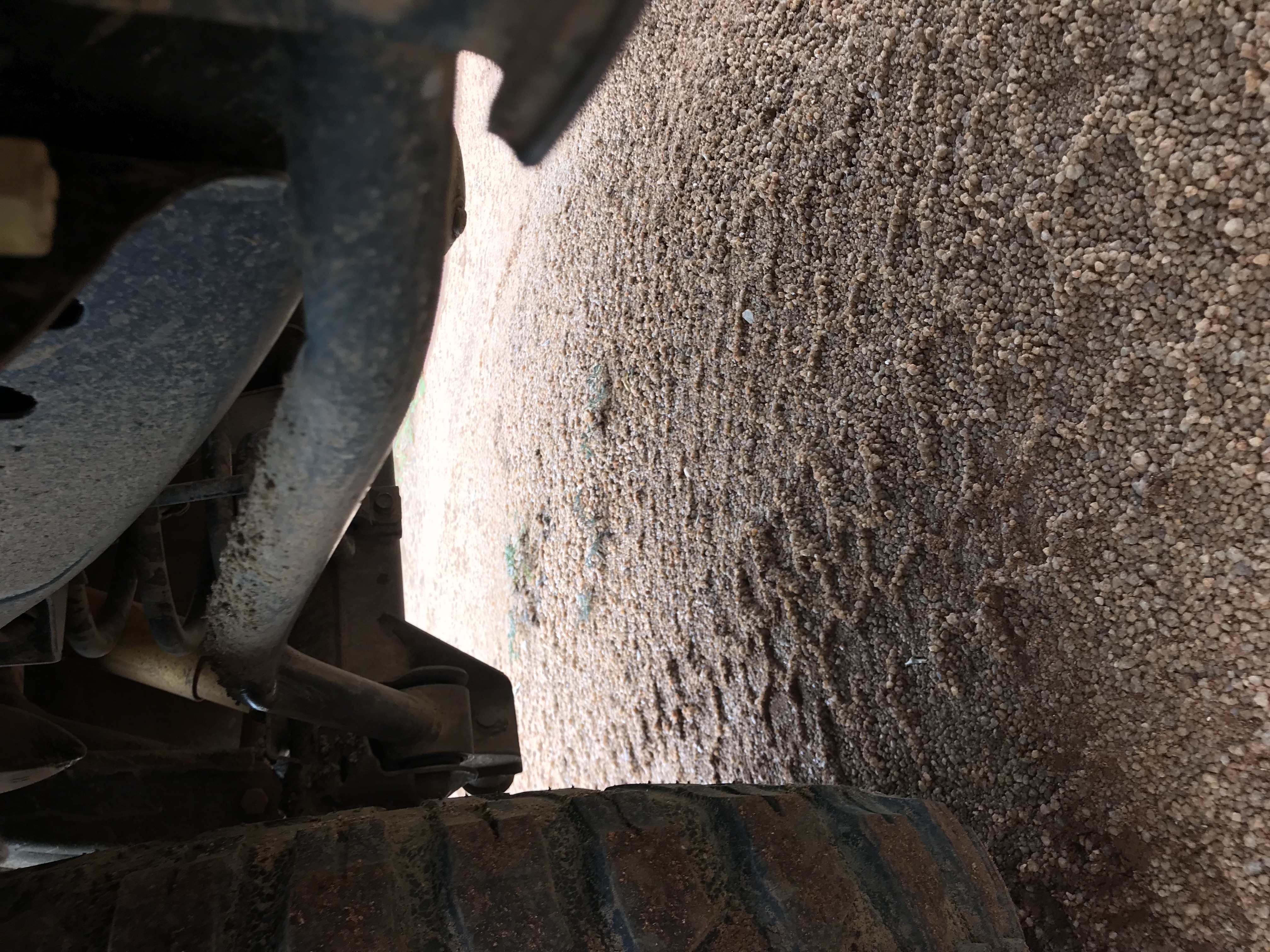

Almost a year ago I bent a rear Trailing arm on my GQ at Moegatle, trying to follow a pipe car on 37" :rolleyes:
I borrowed Oom Alex Fullard's shed and found some old pipes that fit together perfectly and fixed it just to get home...8 months later I have done 3 provinces, River trip and a trip to the Transkei towing 3 tonnes and it it still holding, luckily.

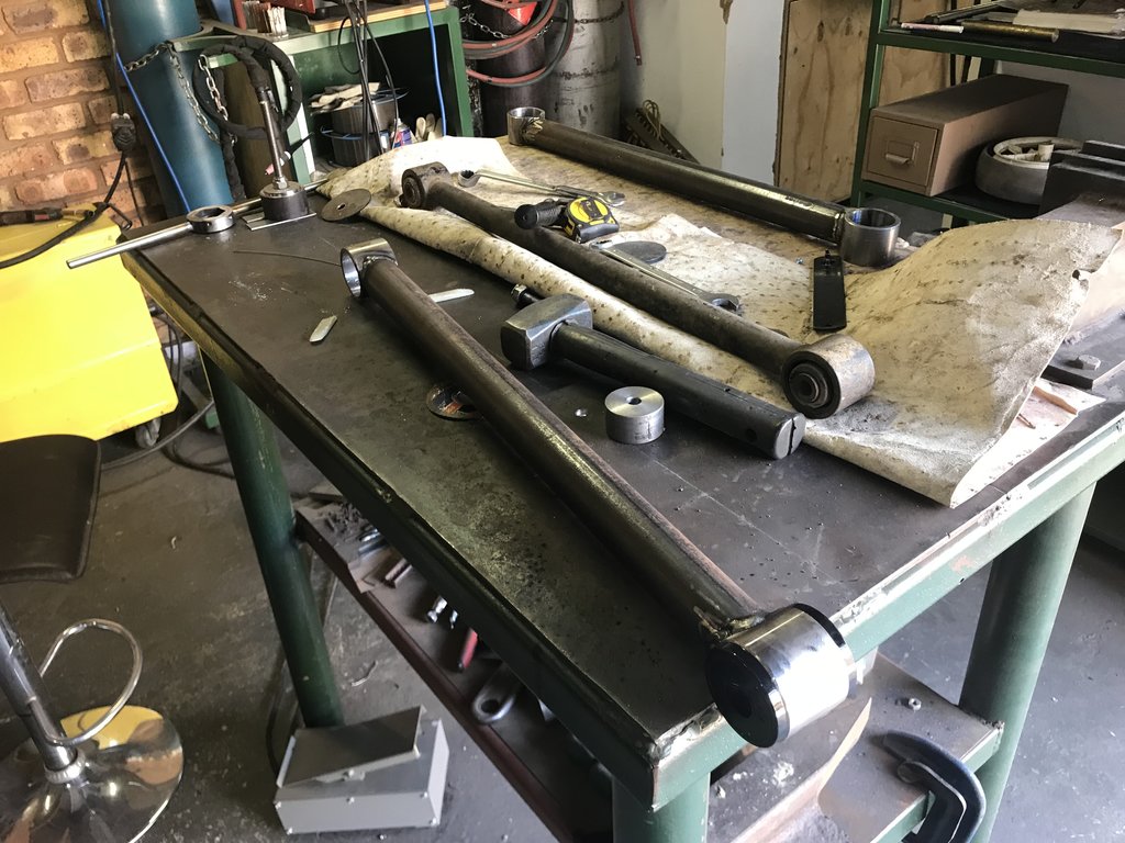

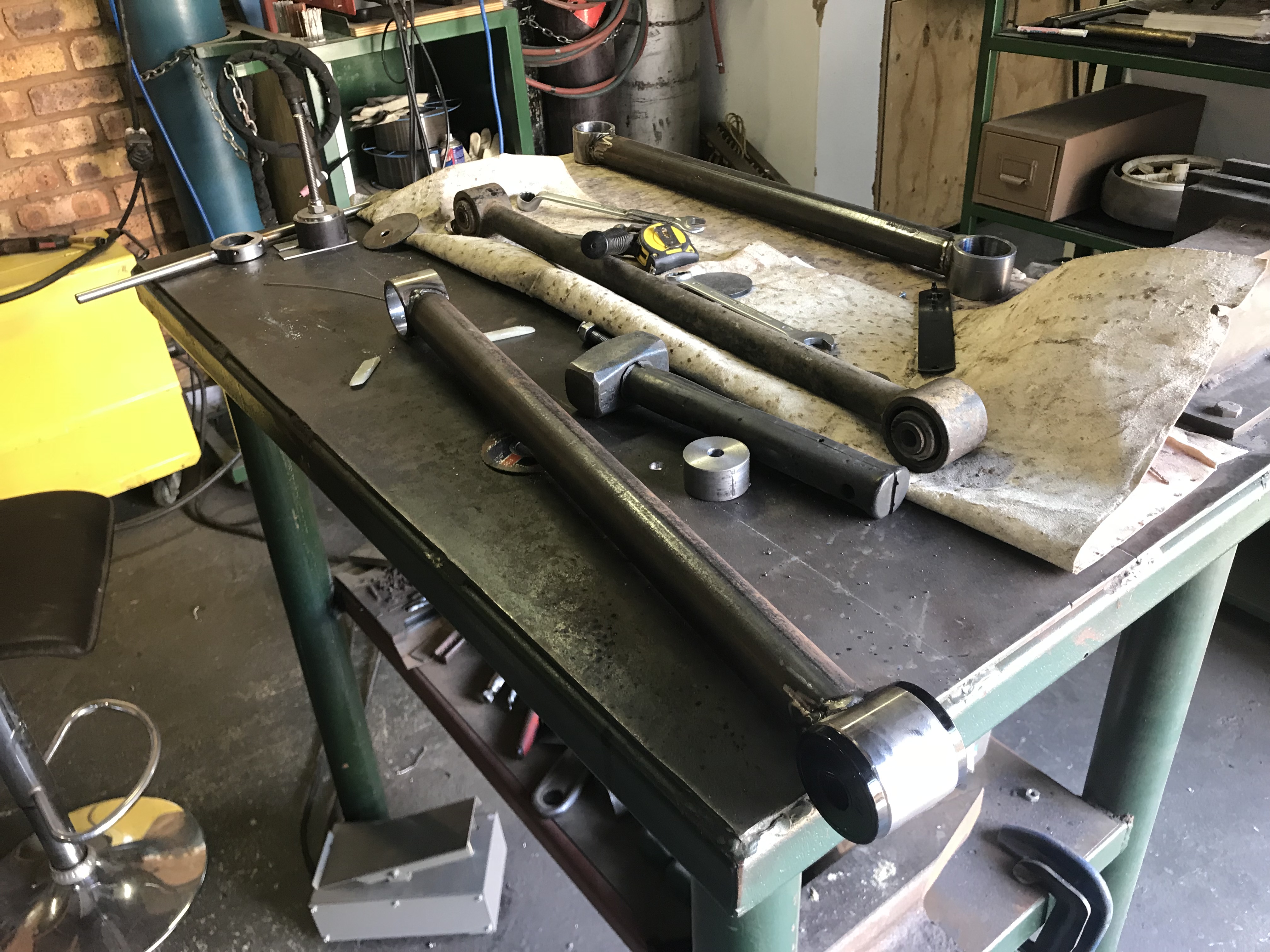

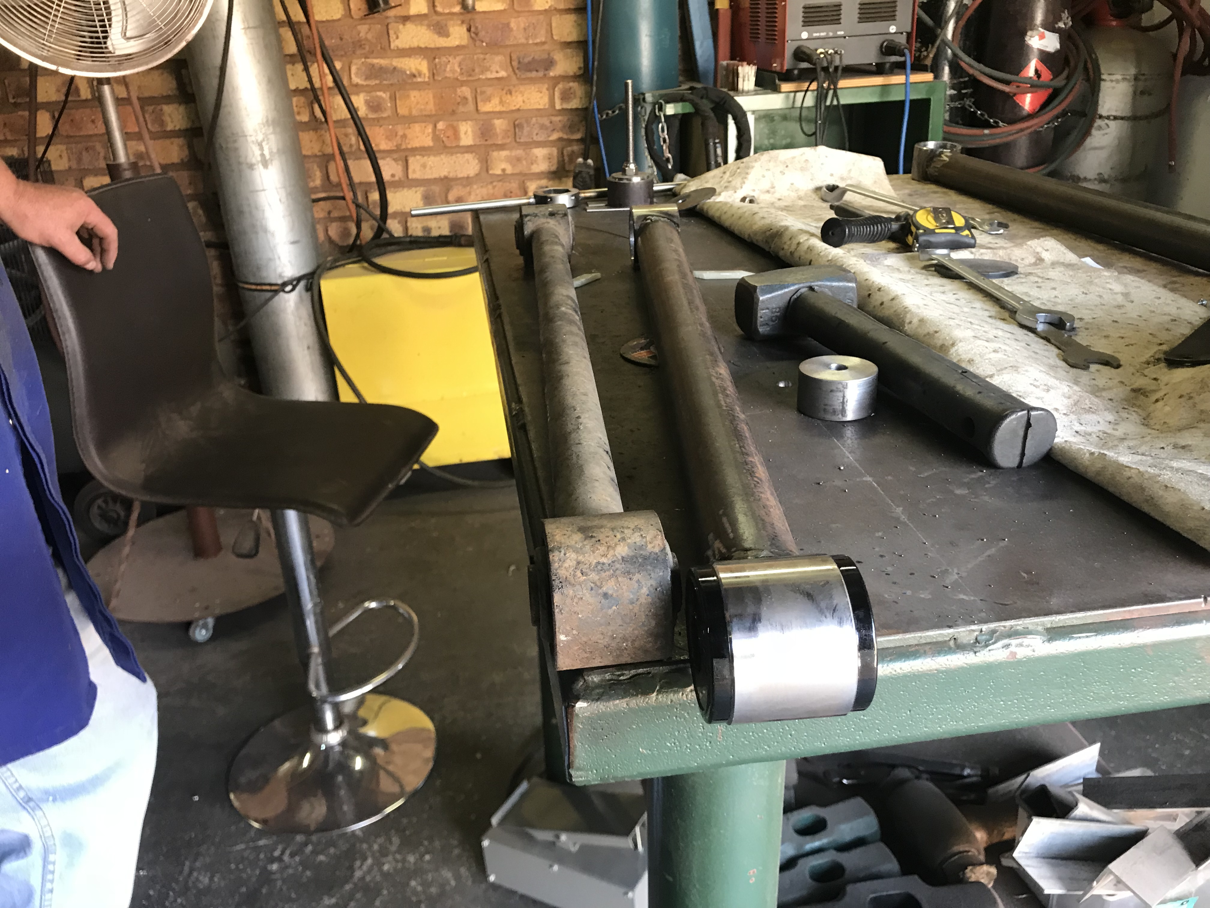

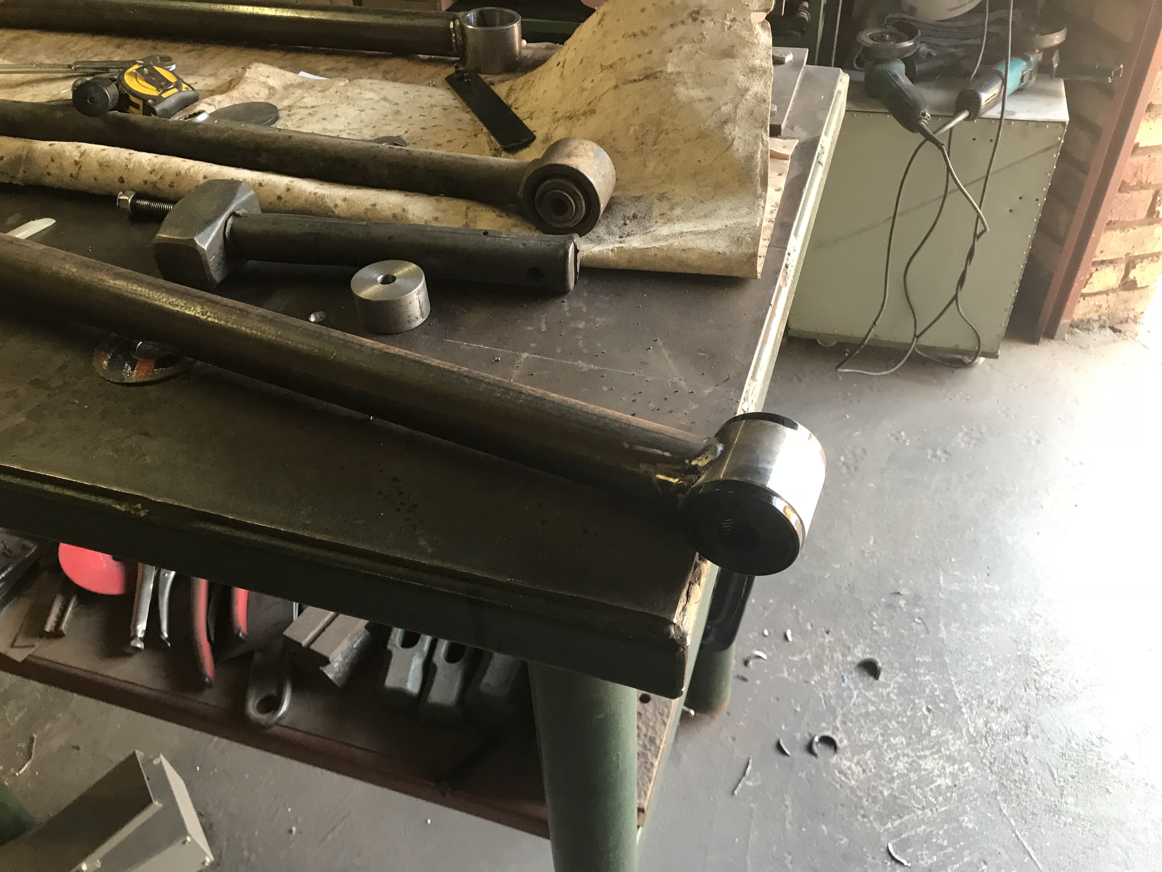

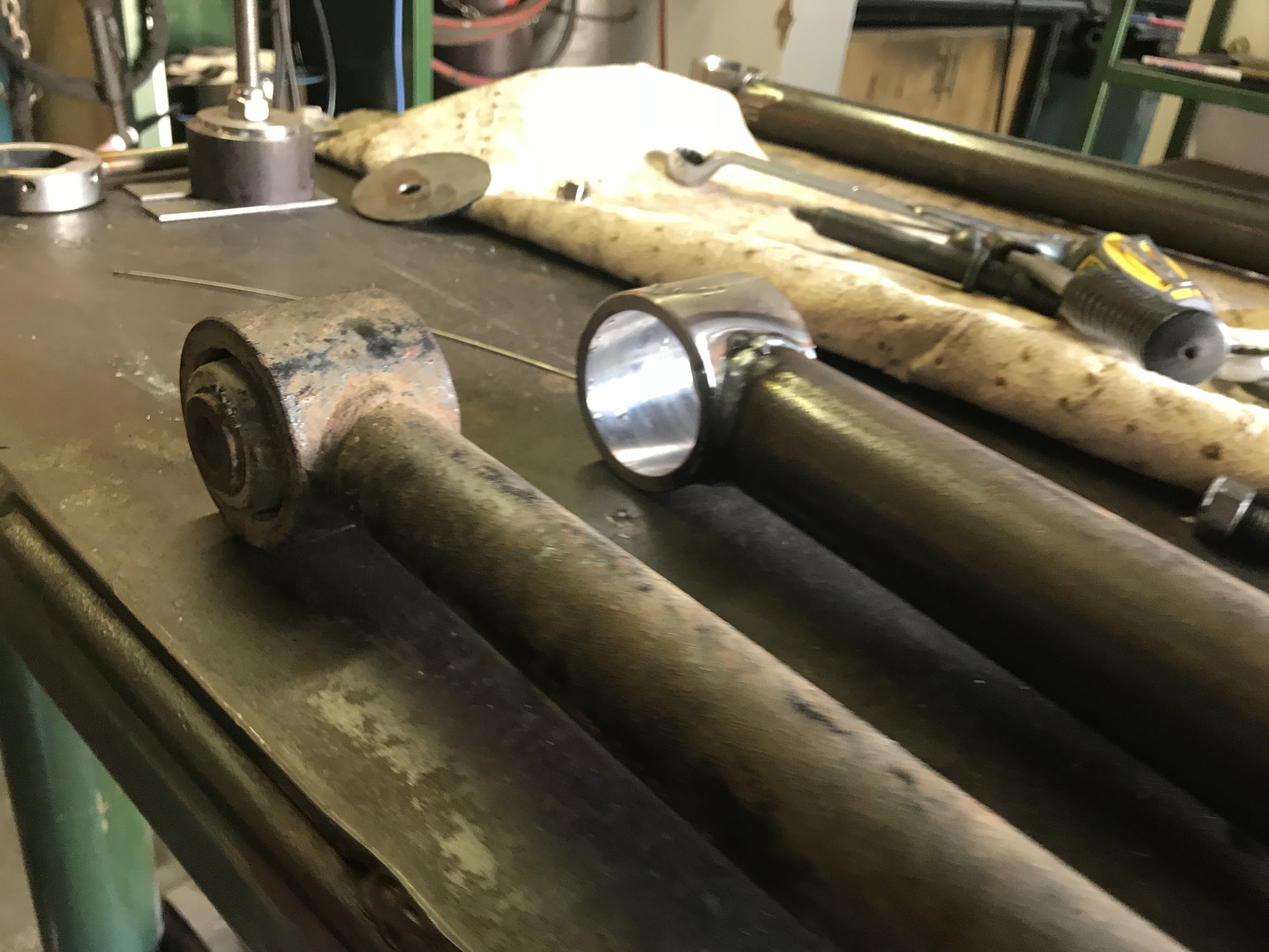

Finally got around to having some new and stronger arms made and putting some nice new terrain tamer bushes in and hopefully sorting out some wobbles as well.
It is R2200 per set if anyone would also like to correct probably the weakest point on a Patrol.
It is made out of 43 mm Outer Diameter Pipe with a 4mm wall thickness.

Na my episode met die panhord rod lyk dit na 'n goeie idee. Is die prys met of sonder die bushes? Wat is die wand dikte van die oorspronklike arms?
TijmenvdS
Posts: 307
Joined: 23 Nov 2016 06:25
Nickname: Tijmen
Chevrolet 1974 K10 402 V8
Has thanked: 32 times
Been thanked: 106 times
Re: The Bigger The Better Trailing arms
Post by TijmenvdS »
Die prys kom netso van die passer en draaier wat myne gemaak het. Ek het hom gevra of hy bereid sou wees om nog te maak as iemand op die forum ook wou hê, toe sê hy dat hy sommer n jig gemaak het. Ek is besig om al my suspention bushes te vervang so ongelukkig sluit dit nie in nie.
Oorsprik dink ek is maar n 30mm pyp met ek skat 1.5mm wall thickness.
As hy eers n duikie in het is die kort voor lank dan snap hy sommer.
Grahm sn het teen koos se klim gesnap
Myne het gebuig en later gesnap
Alex se shorty sn het gesnap by Hennops
Op 3 Provinsies het oom Corrie sn gebuig en gelukkig het hy dit huistoe gemaak.
As iemand sou belang stel sal ek gerus die man se besonderhede aan stuur, hy is in Silverton.
