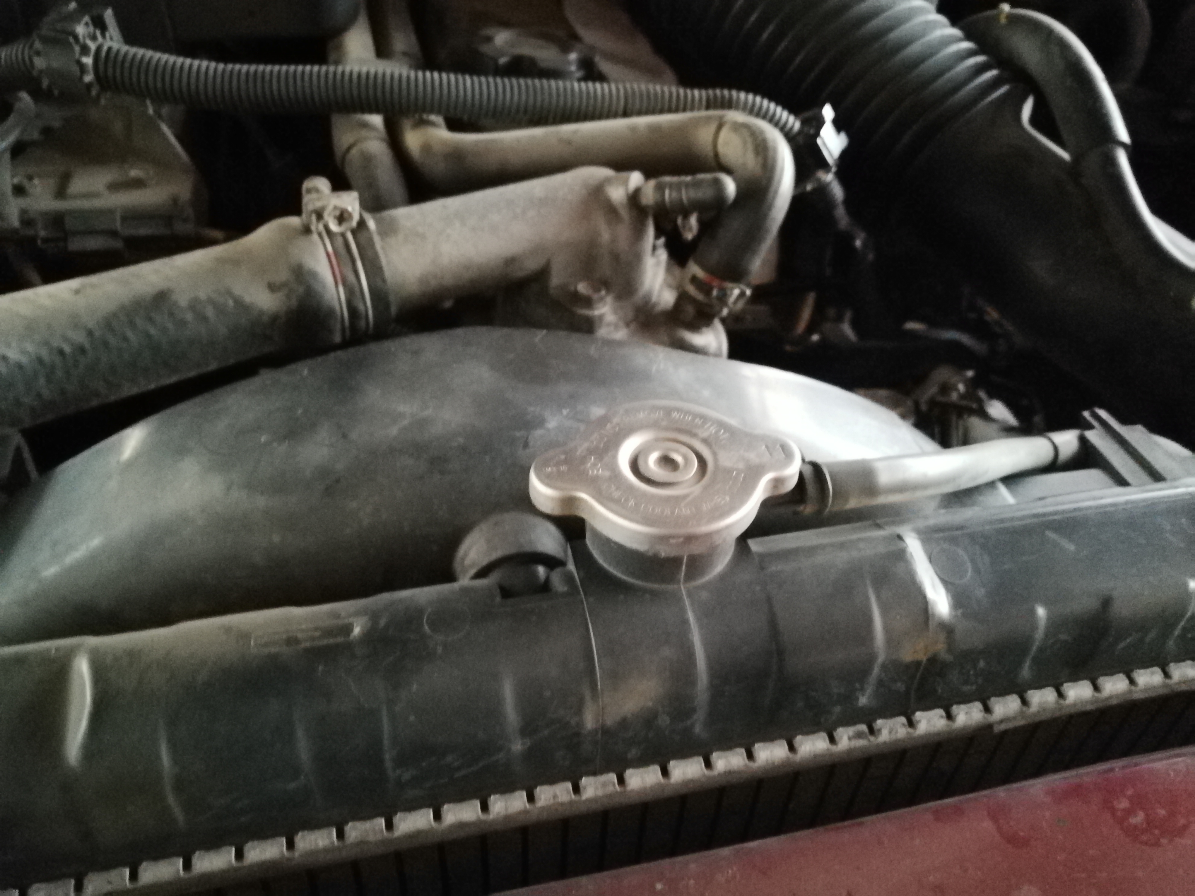

I have ordered a replacement cap, as normal in Bloemfontein you can get anything you want as long as you want it tomorrow or the day after.....
I am planning on doing coolant system flush anyway - that's what school holidays are for. I also spoke to Thinus Lotz and I am going to check for bubbles in the coolant later today to rule out head gasket failure....

I seriously doubt it is that serious. I think you may just have a small water leak. Is the radiator still the old original with the plastic top and bottom tank? It may be something as simple as the plastic giving up. Don't let Tinus scare the crap out of you with head gasket issues. If you are not overheating, then chances are that the head gasket is still fine.

If you are doing a coolant flush, I would whip out the radiator and send it in for a check at a reputable company. I use a great guy at Silverton radiators in Alberton.... but i think that is a bit far....hahaha.
Re: 2000 4.2d water leak sensor bottom right of radiator
Remember if they paint that ally radiator throw it away ....a new one is like 4k so dont spend the world fixing it ...i was under the impression the water comes out the overflow pipe...is that correct?

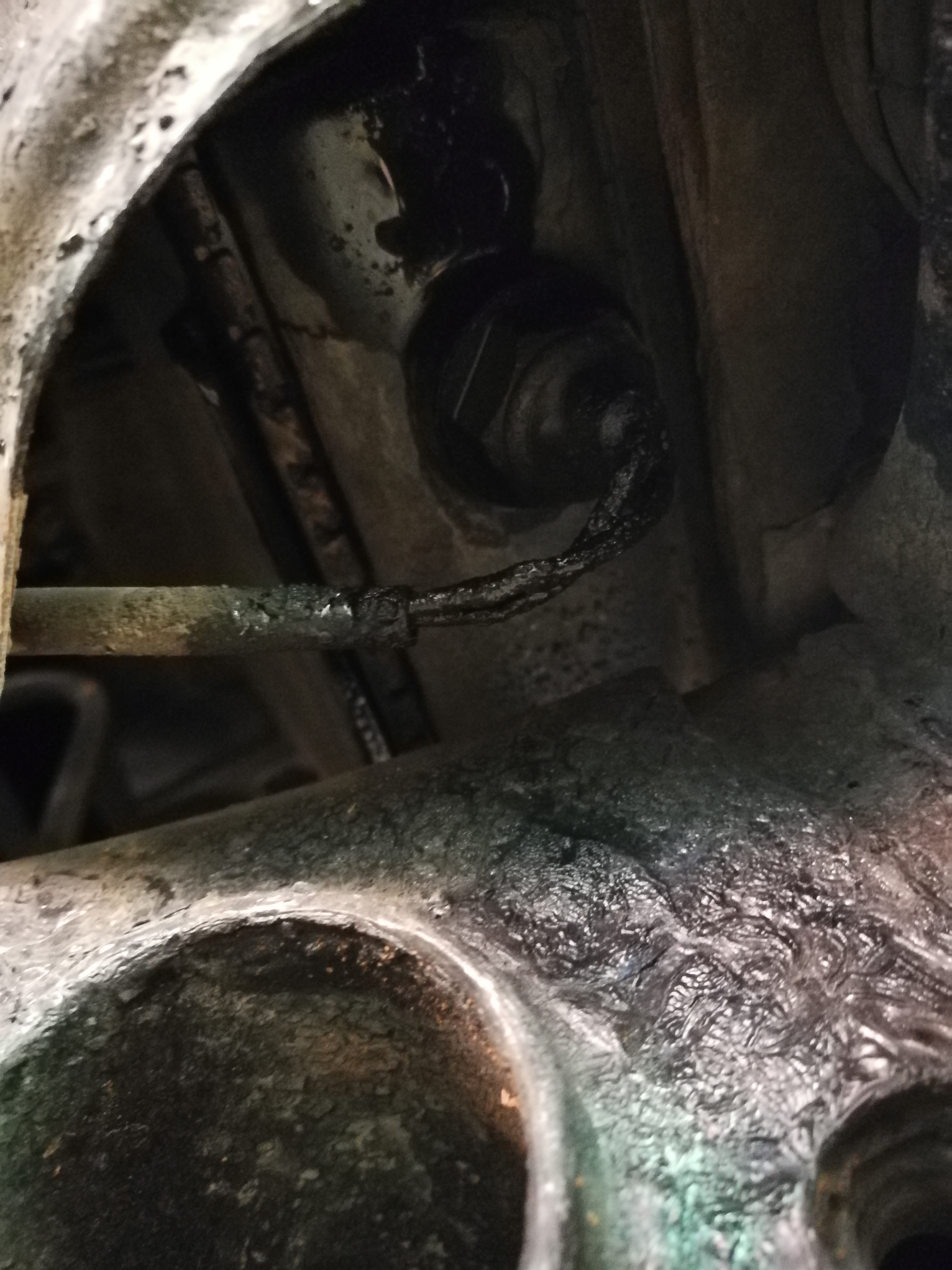

Driver side bottom of radiator at the sensor
Tinus was listening upside down.....hahahahahahahaha
