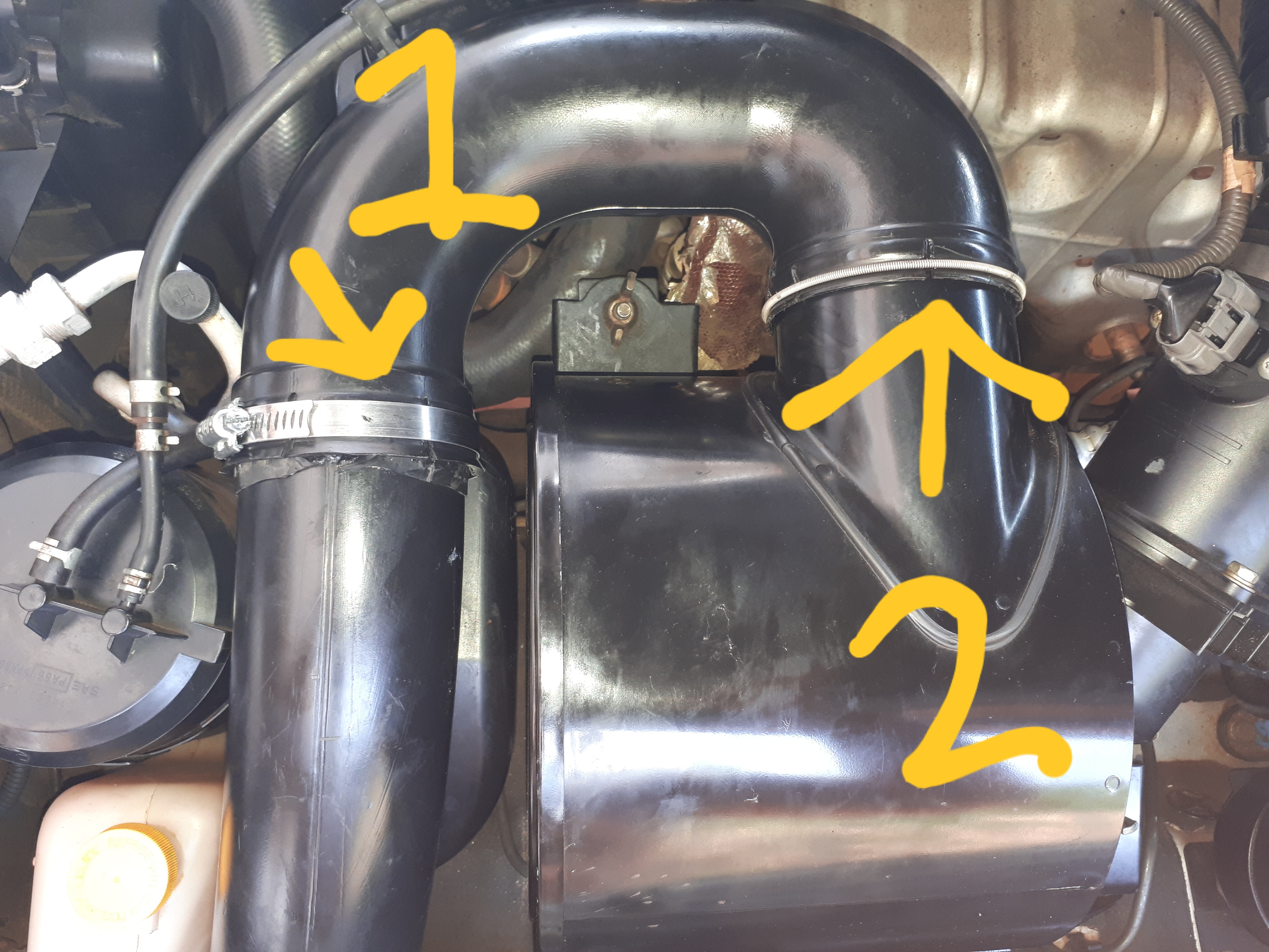

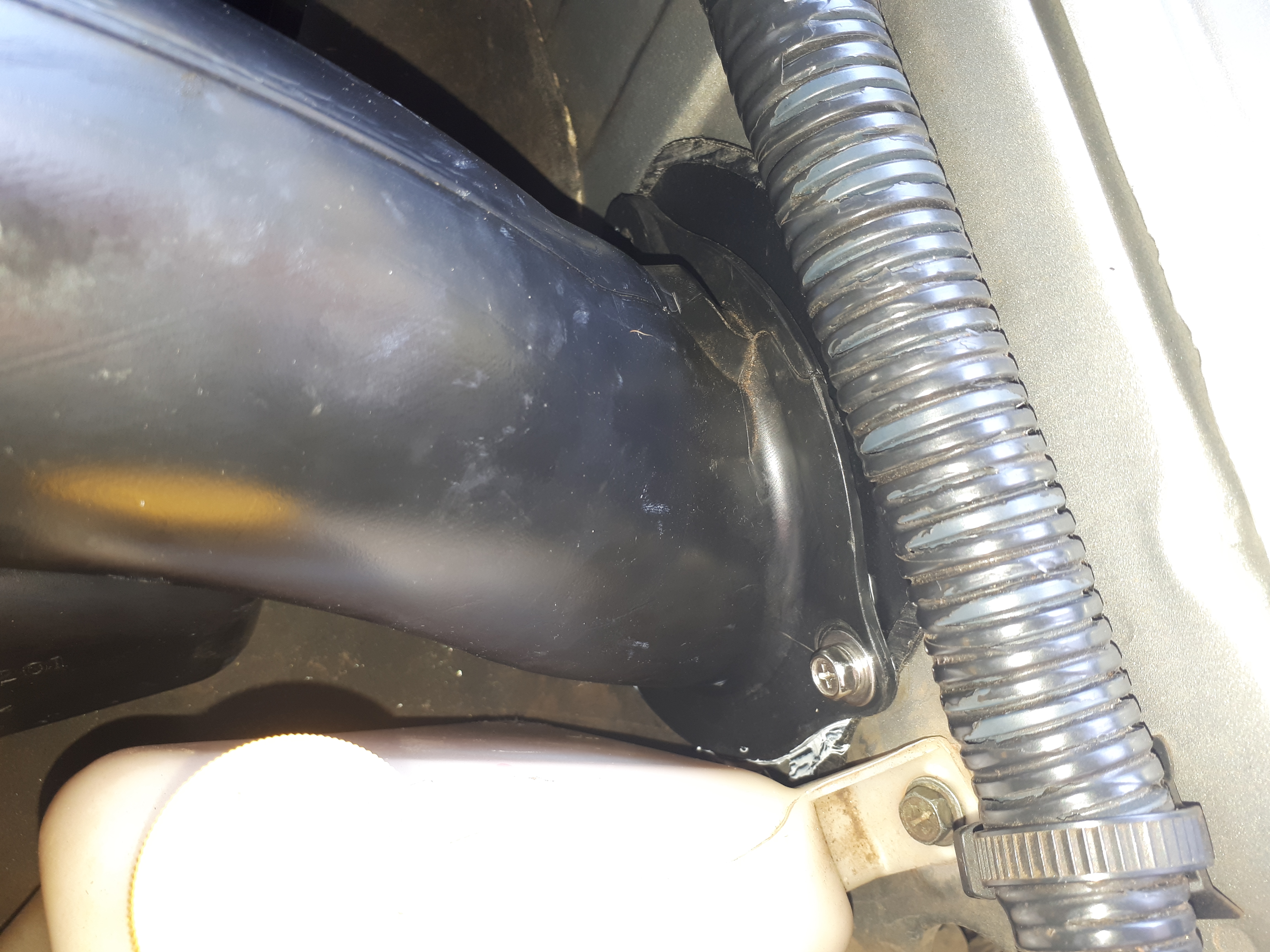

The following 3 joins in the engine bay leading to the airbox and filter...
For the first join I used an odorless, non-acidic polyurathane sealant which is non corrosive to paints and metal and is sensor safe. Makes a tight seal and is an elastic bond so it allows for movement in the joint and does not go brittle. (See below)..
For the the next join which is numbered "1" in the picture below I cut an old bicycle tube about 5cm long and stretched this over the end of the pipe which was difficult as its a tight fit. I then closed the join and secured it with the hose clamp. (I didnt want to use a sealant here because it will become a mission every time you want to change the air filter. This join can be taken apart with no stress and used again and again... I hope...
Lastly for the join numbered "2" I used a sensor safe gasket maker from Wynns. Able to withstand the high engine bay temperatures, it's also sealing onto the metal pipe from the air box which I'm sure most get quite warm on long drives.
I have done nothing from the airbox to the engine as the seal there seemed good.
First test this morning ing and it did exactly what I want. I took the ram head off the top of the snorkel and closed the top with a thick piece of cardboard and voila the engine died almost immediately.
