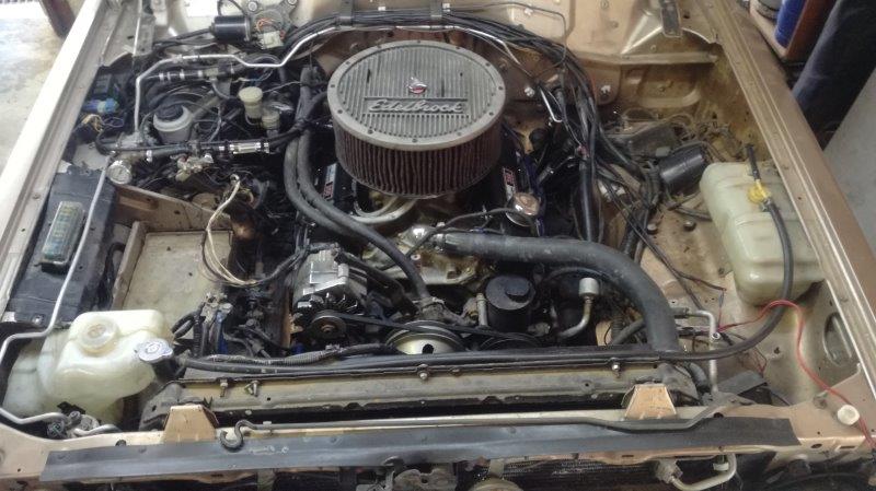

I've had the vehicle for a few weeks and have not done much (relatively speaking) besides removing all the door panels, dash panels, switches and starting to strip all of the tape and sleeving off of the wires in the engine bay so I can see what goes where.
I'll load a few progress pics as I go....
This morning I removed the bonnet and started stripping, identifying what wire is for what, what relay operates what, cutting out a lot of redundant cable and starting to get a handle on whats happening.

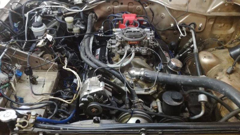

This is an overview of the engine bay as I start. At this point I had already done a lot of stripping of the sleeves and tape, but it gives a good Idea of the work to be done.
1. Engine bay to start.jpg (71.13 KiB) Viewed 3188 times

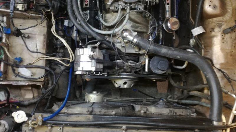

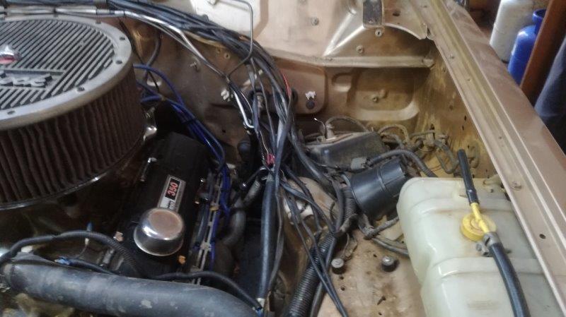

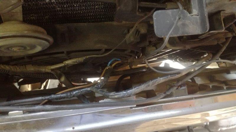

The next 2 pics are of the passenger side of the engine bay, also stripped of sleeve at the start of the day
2. Engine bay passenger 1.jpg (57.42 KiB) Viewed 3188 times
3 Engine bay passenger 2.jpg (55.17 KiB) Viewed 3188 times

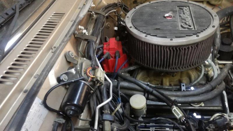

scary spiderwebs behind the grille :surprised:
4. behind the grille.jpg (52.79 KiB) Viewed 3188 times

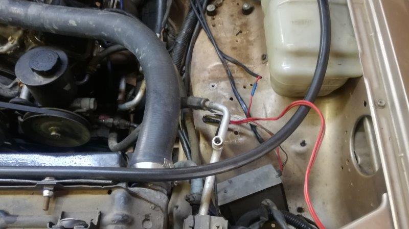

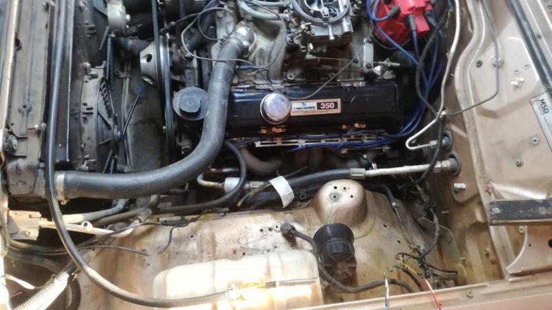

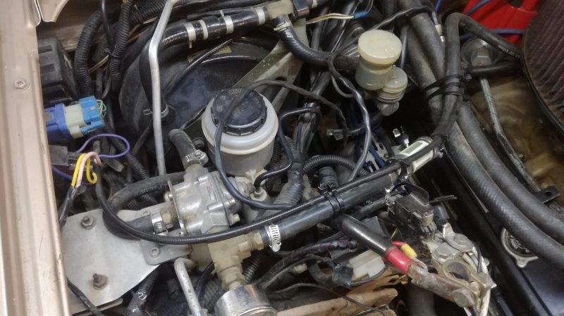

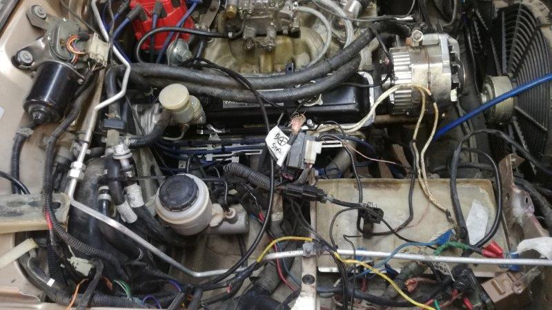

the next 2 pics are of the drivers side of the engine bay before i really got into it
5. Drivers side firewall.jpg (68.18 KiB) Viewed 3188 times
6. drivers side engine bay.jpg (65.98 KiB) Viewed 3188 times

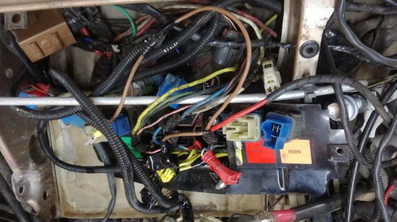

This is the fuse and relay panel next to the window washer bottle. I wanted to re-use it, but it has been badly molested :rolleyes:
7 behind the relay and fuse panel.jpg (73.78 KiB) Viewed 3188 times
So here are some pics at the end of today.
In many ways it looks worse than the pics before I started but I have to tear it apart and rewire most of it. I also pulled out a lot of redundant wiring and marked up many of the wires
8. engine bay After a day of stripping.jpg (75.26 KiB) Viewed 3188 times

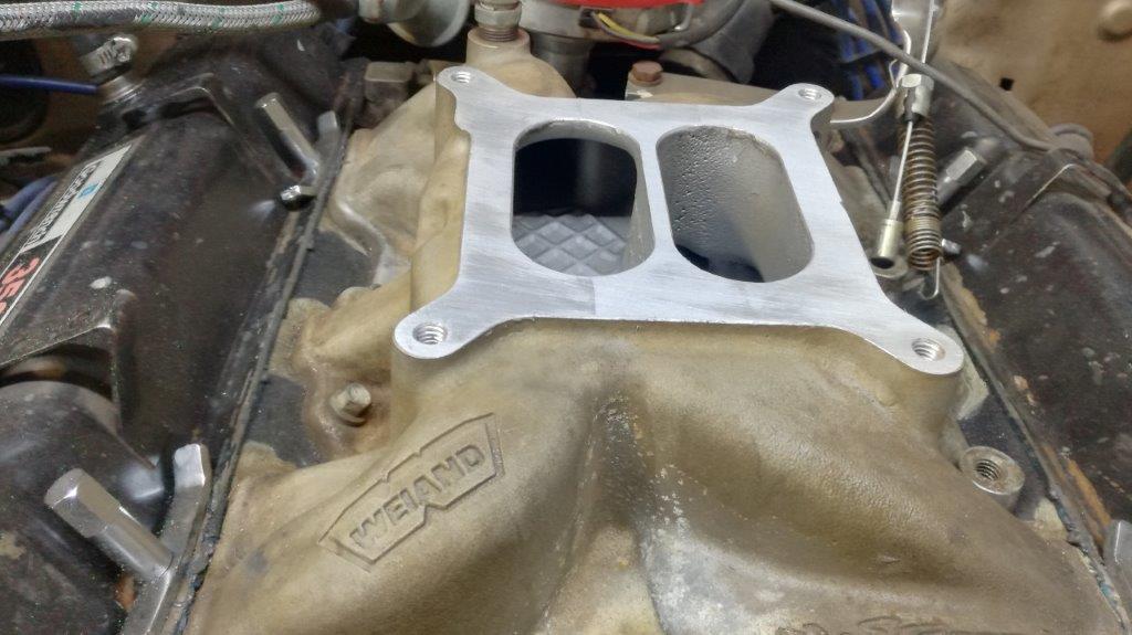

The Quadrajet is a spread bore and the dual plane Wieand intake manifold is for a standard 4 barrel carb.
1. Dual plane manifold.jpg (86.53 KiB) Viewed 3057 times

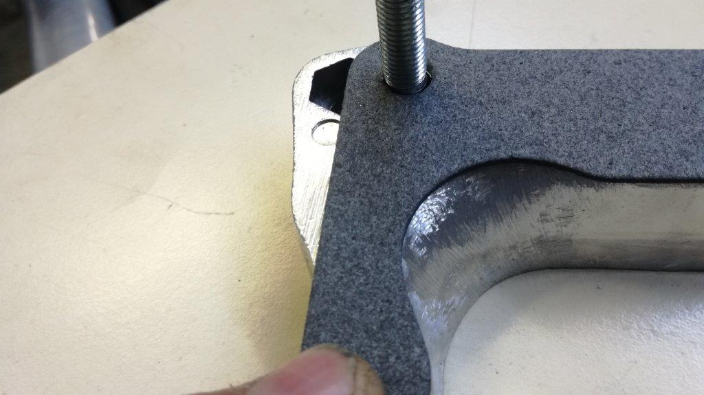

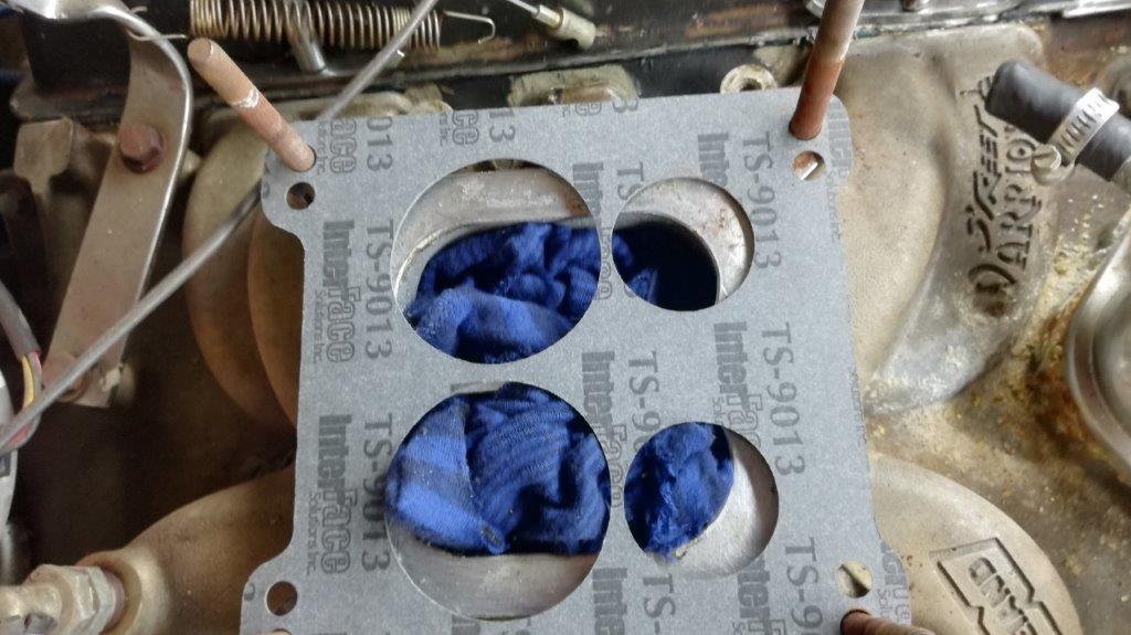

Heres a pic with the spreadbore gasket in place showing the problem.
2. spread bore gasket.jpg (91.91 KiB) Viewed 3057 times

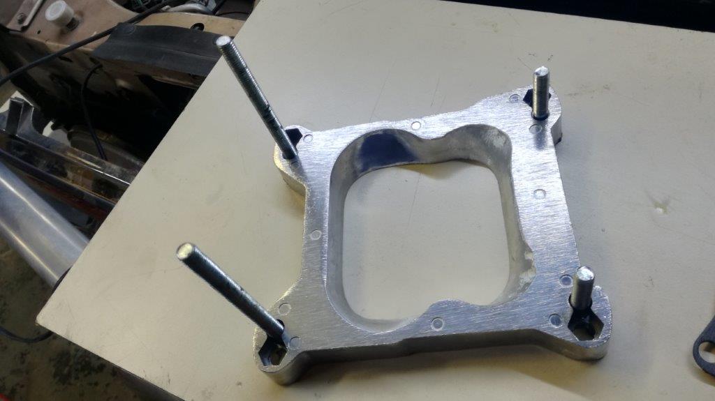

Heres the solution: a standard 4 barrel to spreadbore adapter plate
3. spreadbore adapter.jpg (58.32 KiB) Viewed 3057 times

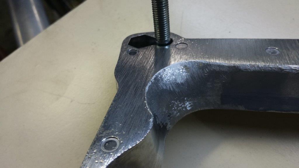

The adapter needed some modification to improve airflow so I used a burr to shape it
4. Spreadbore Adapter shaping.jpg (52.98 KiB) Viewed 3057 times
Aaaah, that's better
5. Aah thats better.jpg (74.97 KiB) Viewed 3057 times

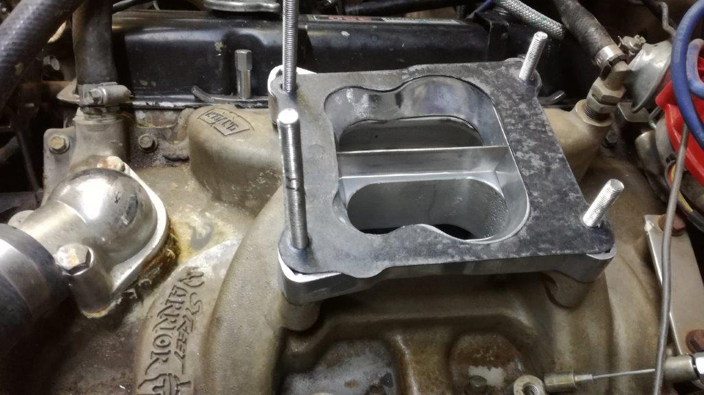

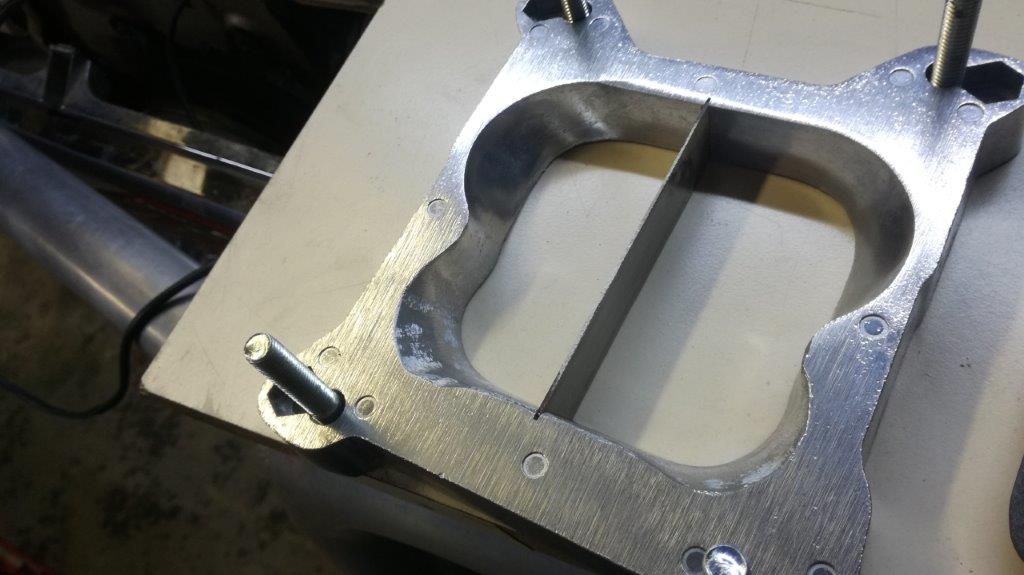

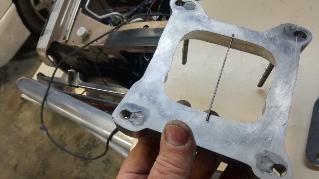

But, there's a problem. The adapter isn't dual plane, so you would lose all of the torque advantage and improved idling and off idle response that the dual plane manifold offers. So I cut a piece of stainless steel and slotted the adapter plate to receive the stainless steel divider
6. modification for dual plane 1.jpg (67.27 KiB) Viewed 3057 times
7. modification for dual plane 2.jpg (71.26 KiB) Viewed 3057 times

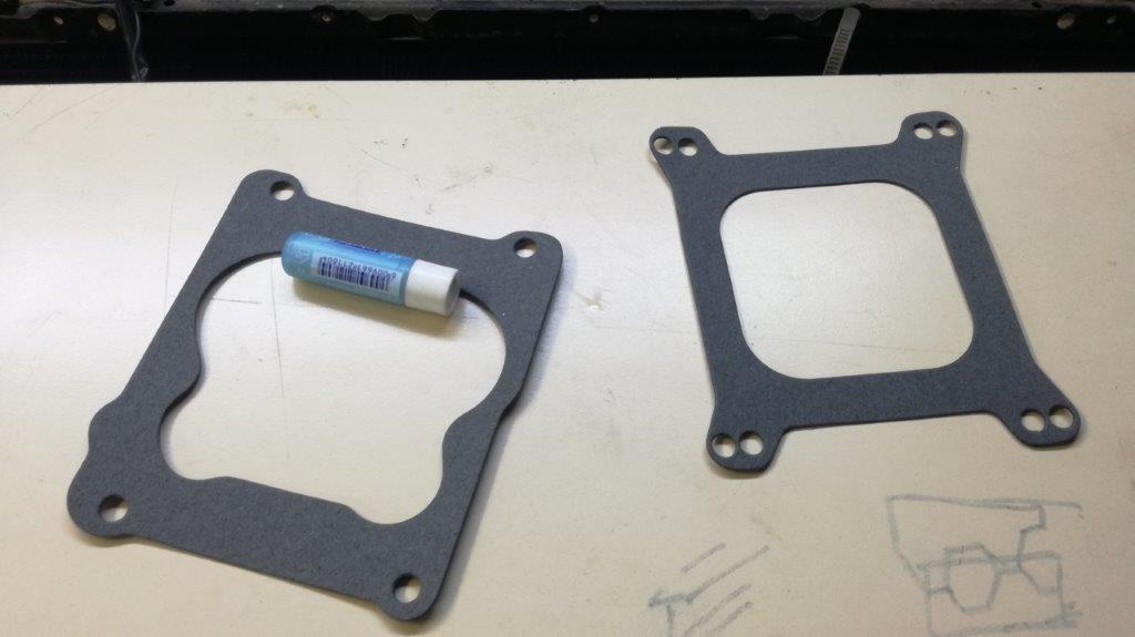

Here's the new gaskets for the dual plane adapter with the lip ice which I apply to both sides of the gaskets. Its a trick I was taught. It prevents the gaskets from sticking to the metal surfaces when you remove the carb.
8. the gaskets with lip ice.jpg (51.88 KiB) Viewed 3057 times

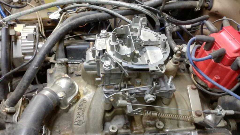

and with the carb mounted
10. carb fitted.jpg (105.86 KiB) Viewed 3057 times

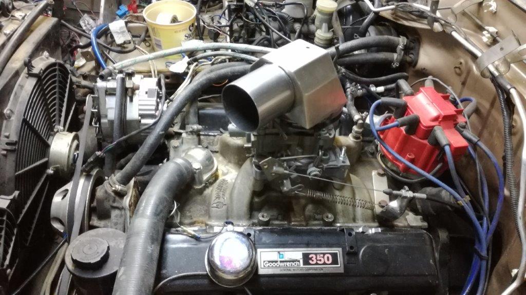

and with the new carb cap (Peter Connan design)
11. new carb cap.jpg (113.53 KiB) Viewed 3057 times

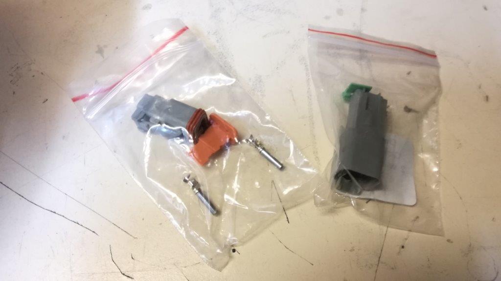

I also bought a bunch of deutch plugs for some of the electrical components
12. deutch plugs.jpg (49.87 KiB) Viewed 3057 times
