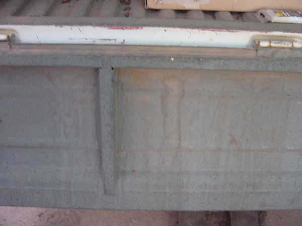

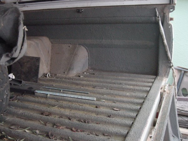

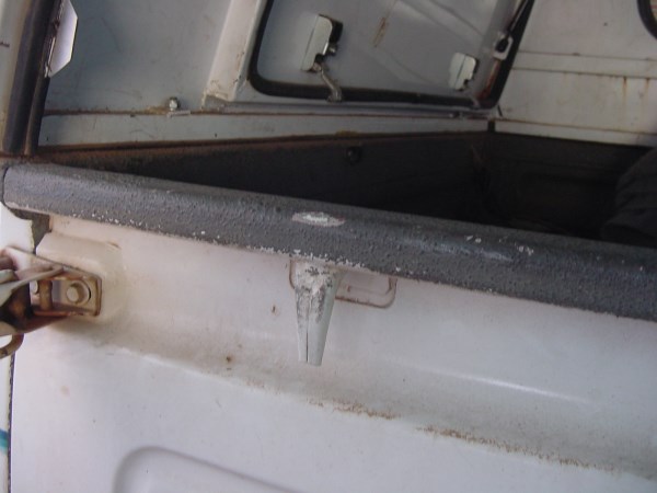

I did my Safari's loadbin with Durabak and it is not too bad with a few scuff marks here and there
