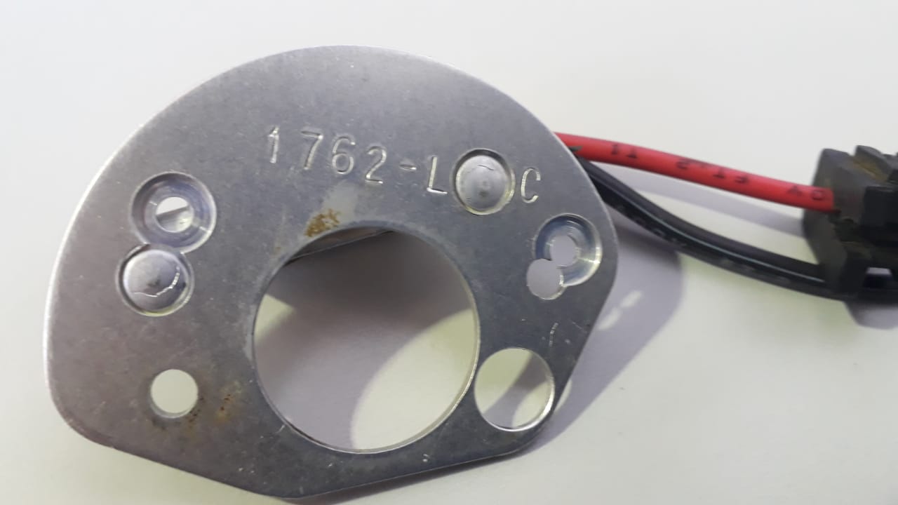

Hi guys, need some help please if anyone can help. Apparently my ignition control module in my distributor is faulty on my patrol. Can anyone please assist me as can’t get it at any outlet so far and the suv is still stuck on the side of my road... thanks rob.

Sorry to hear that Rob
Contact Bruce at Offshore Marine in Cape Town. 021 786 1007 (I hope).
Alternatively or in the mean time, the car started life with points. The correct points are Echlin CS351, which you could get from any spares shop. Presumably the original wiring is missing, but any competent auto-electrician should be able to sort that out for you!
