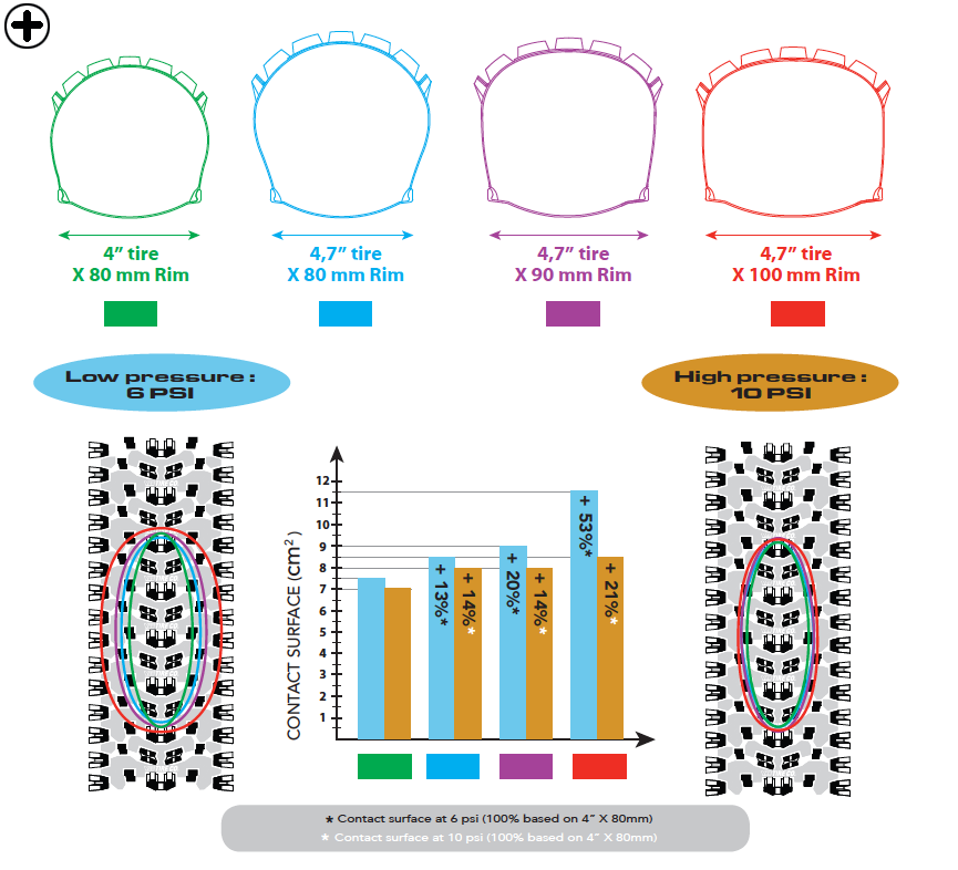

nisjeep wrote: 01 Aug 2018 22:43.
This looks like quad bike information? The rules are different for them, because there is not enough weight to crush the sidewalls.
Anyway, if 10psi is high pressure, then 6psi is NOT low pressure.
On sand, you want to drop down to 0.4-0.6 bar, from 2.3-2.8 bar which is our "high pressure".
One thing I should have added: no one will ever convince me that the biggest tire you can fit and have enough torque/low enough gearing for is NOt the best tire off-road. But that is biggest diameter, not widest.
And the higher the profile (higher the sidewall) the better too. The higher the sidewall, the longer you can stretch that contact patch.
