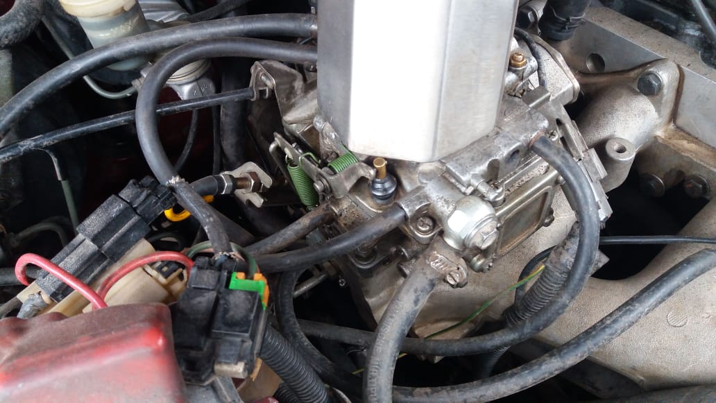

As for your question, the vacuum hose leading from the vacuum advance on the distributor is connected to the carb just above the air mixture screw. Is this correct? I have found a few basic vacuum diagrams online but they don't show exactly where the hoses connect.

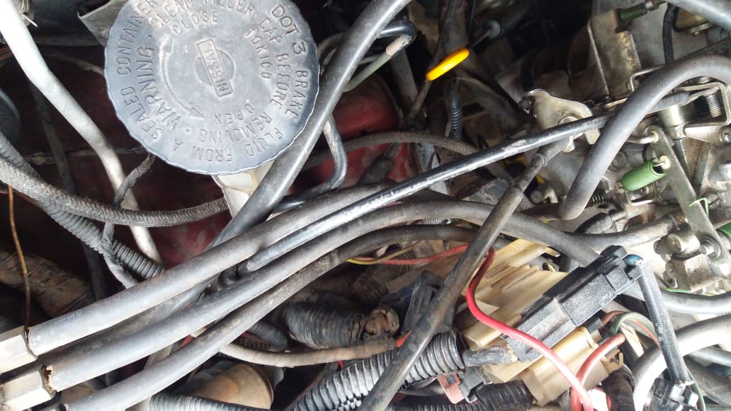

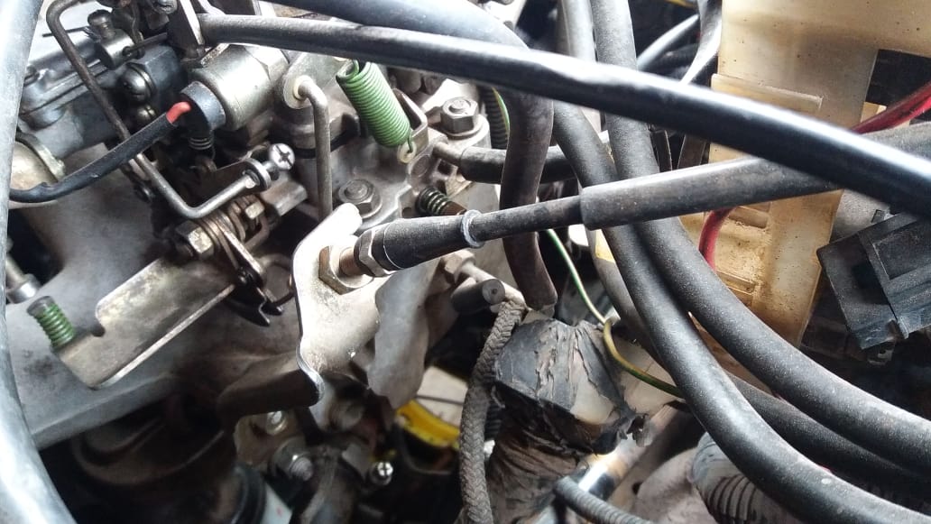

I also have a few other vacuum gremlins to work out:
1. the hose from the idle compensator that connects under the airbox was disconnected on the other end. The only port I could find to connect it to was one on the tree connecting to the intake manifold under the air mixture screw. Is this correct? The other two ports on the tree were plugged and I need to work out where they were connected to.
2. I found some other cut and plugged vacuum hoses, one from the altitude compensator.
If you have a detailed vacuum diagram, other than the one in the Nissan service manual, that would be very very helpful.
thank you for the info and your kind offer. I will try and source a full carb rebuild kit if I can but if not would very much appreciate any spare gaskets and an air mixture screw.

Dustin, that is the correct port for the vacuum advance, whichs brings up another question:
These engines are very sensitive to ignition timing. Mine will ping audibly at higher revs and loads at anything over 7 degrees idle advance. Thus I must wonder whether your crank pully hasn't perhaps shifted? Have you pulled no.1 plug and checked that it is at TDC when the mark is at the TDC?
vacuum system: the big (bottom) pipe on the compensator goes to the bottom of the air filter box.
The three top pipes go to the three ports on the "upper story" of rhe carb, keeping the same sequence. In other words, working from the rear of the car, the rear port on the comp goes to the pipe furthest back on the carb, the front pipe on the comp goes to the pipe on fhe front of the carb, above the "viwing window".
The branch on the intake manifold's big pipe goes to the bottom of the air filter box. The tiny one goes to the vacuum solenoid on the firewall which switches when the air con is switched on. The other side of the solenoid should go to the diaphragm mounted at the back of the carb. This system increases the idle speed when the air con is switched on.
The third one is plugged. Looks like a factory part.
Note that mine has a non-standard air filter setup, but I did tjat myself with careful consideration to keeping the vacuum system the same.

Thanks Peter, that is very helpful.
The big vacuum hose from the branch was plugged with a screw and the small vacuum hose from the branch to the vacuum solenoid was missing! Got that sorted out now, just need to replace the left side hose from the altitude compensator as it has been cut and plugged with screws on both sides. I will test the compensator first.
I think you might be right about the crank pulley having shifted, will check TDC tomorrow.
There is one other thing regarding the vacuum system that you could perhaps advise me on: there is no evap canister in my engine bay!? There is also no EGR system. My Patrol is a 1995 SGL, did these not come stock with this model? I found today whilst traveling home that there was significant pressure build-up in the fuel tank. Could this mean that the breather pipe was blocked and the evap canister was ditched?
Thanks again for all the guidance.
