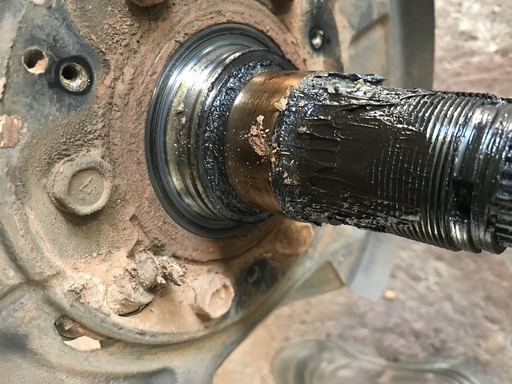

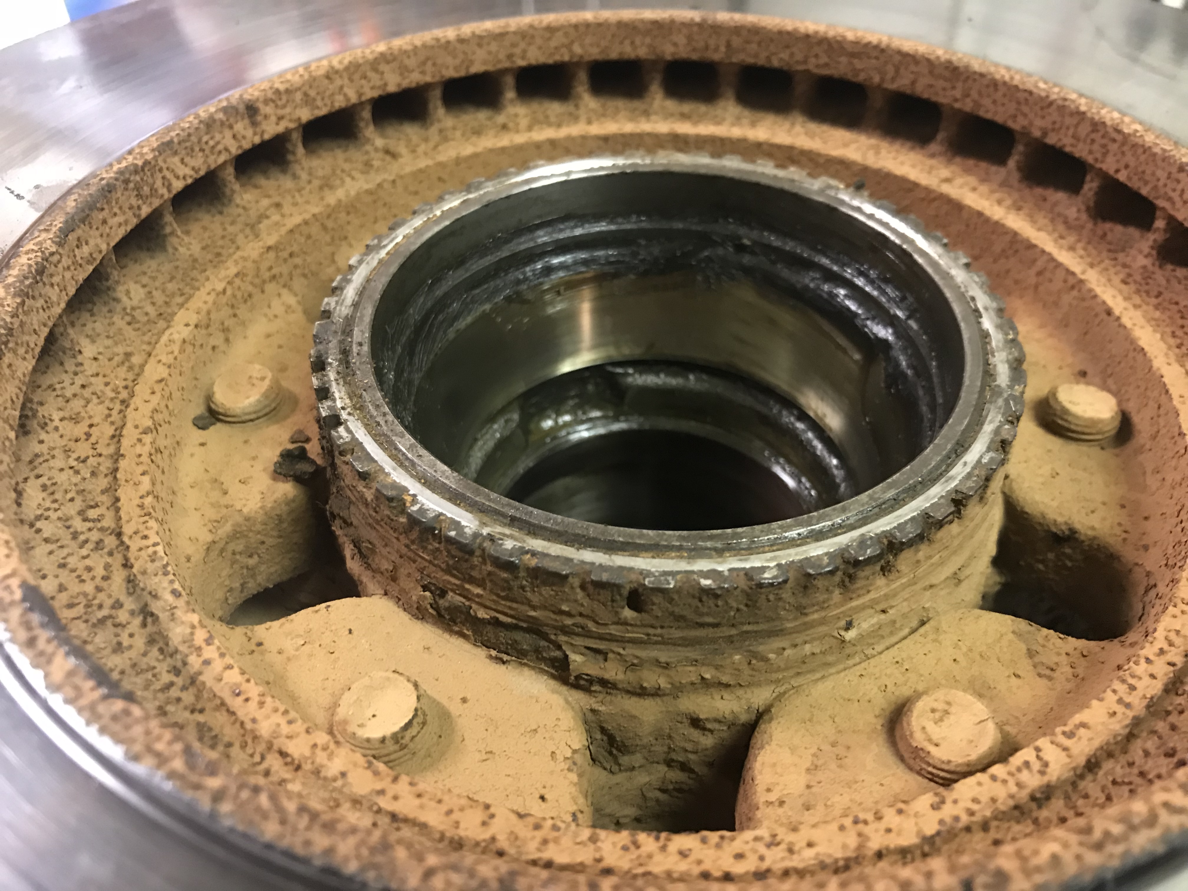

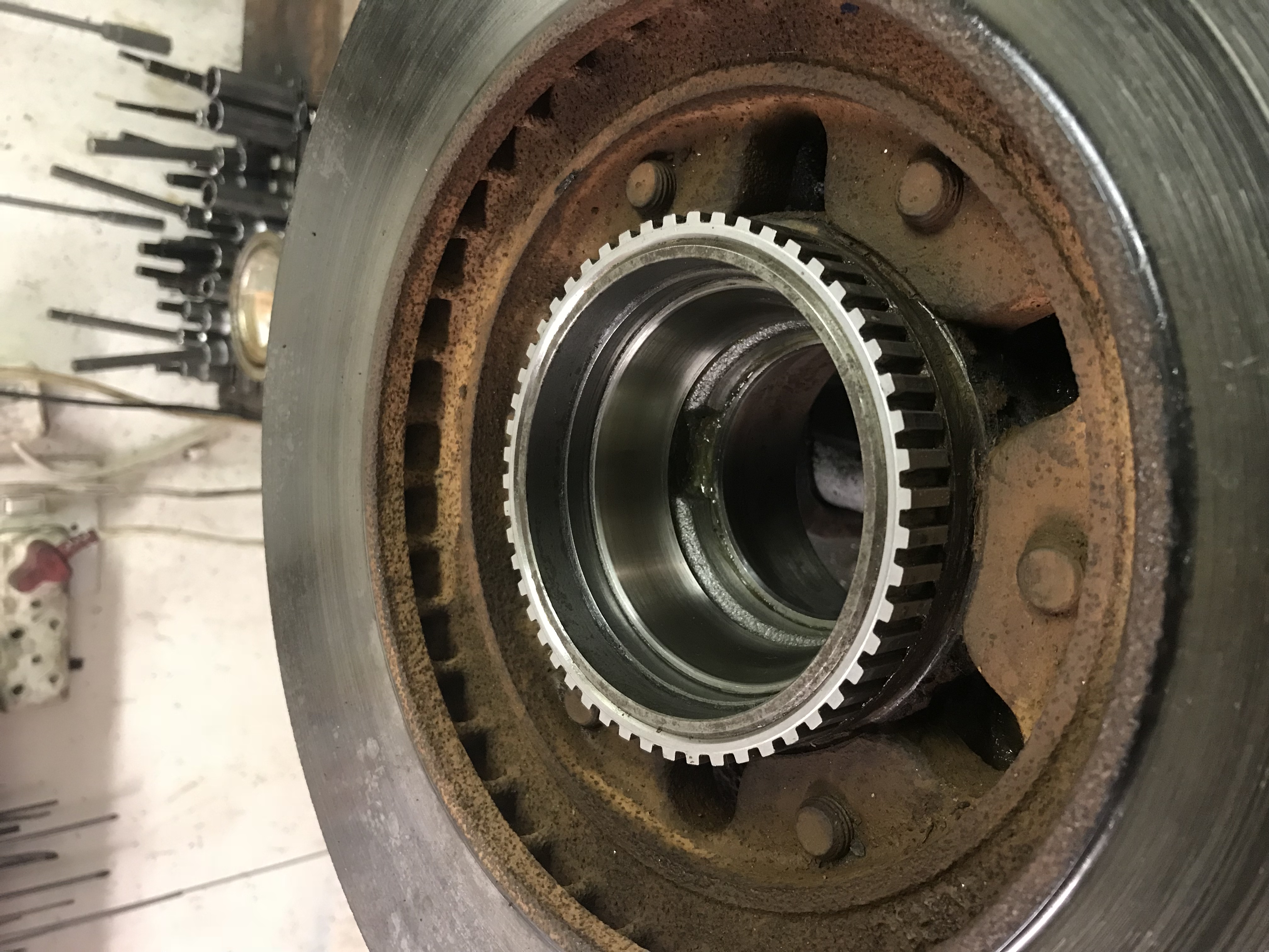

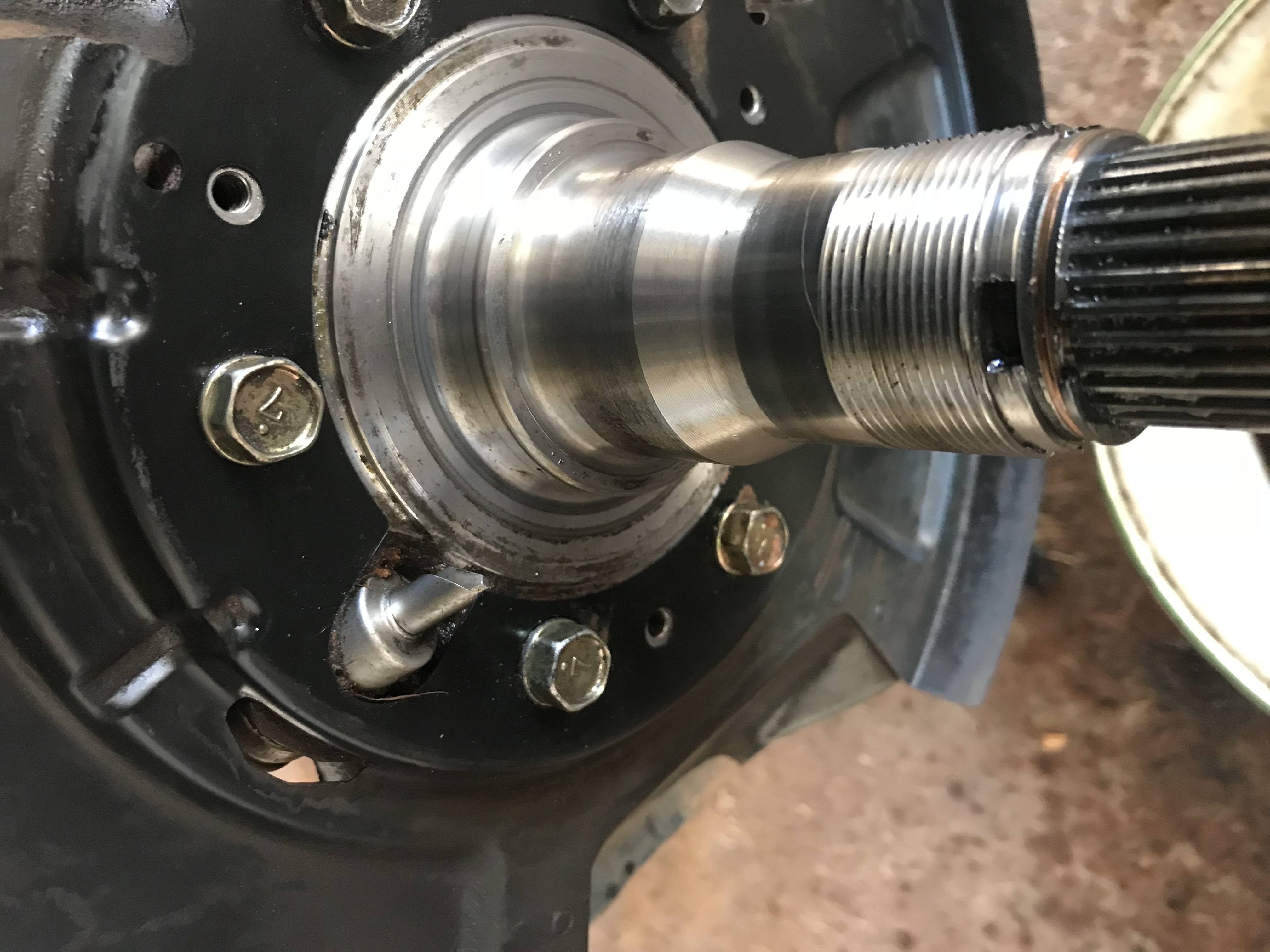

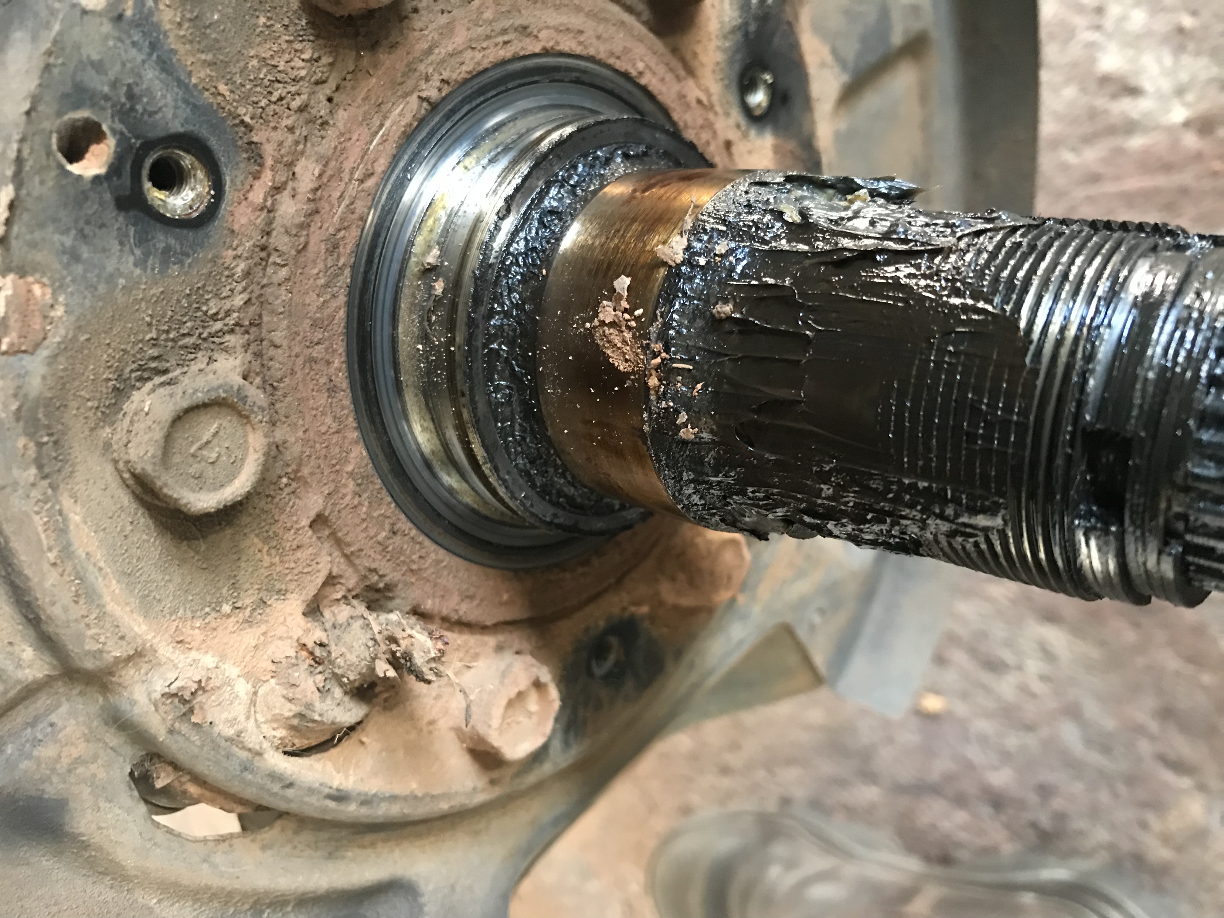

We all like to play a bit in the bush and mud and suddenly the abs light is staying on....????
Where to start or how much is this going to set you back. Well hope this will also help a bit
Before and after photos

Is dit nagevolge van die Botswana trip? Daai rat is behoorlik toegekoek van die modder

Great post!
Shows how a good clean is so well worth the effort!

Is die sensor beskadig, of is daai net stuff wat daar vassit?
My briek discs se vent-gleuwe was amper heeltemal toe van stokke, gras en modder.

nee dit is maar jare se opgaar van gemors en ook n lekkende wheel bearing seel :lol:
