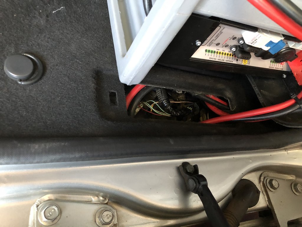

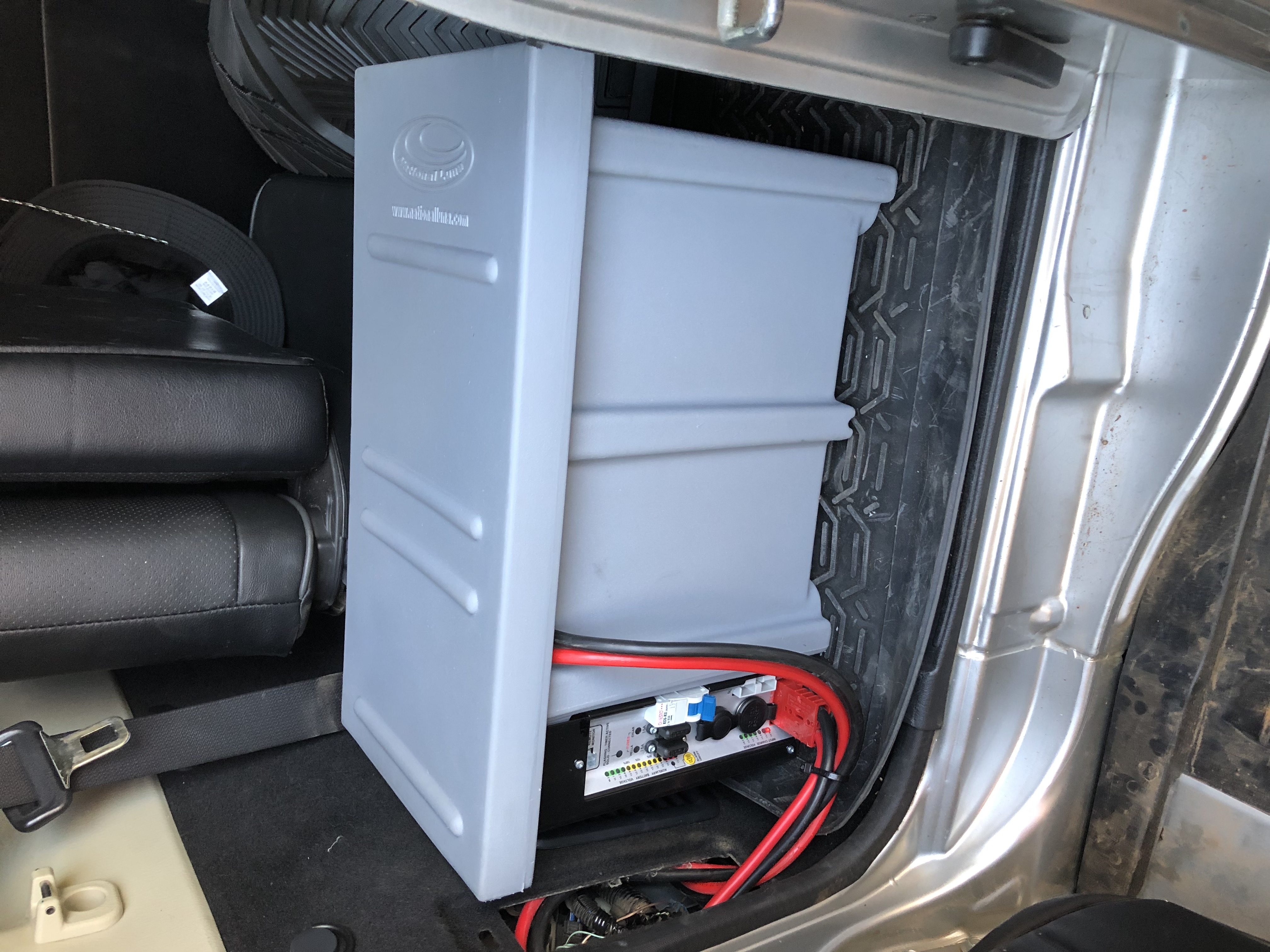

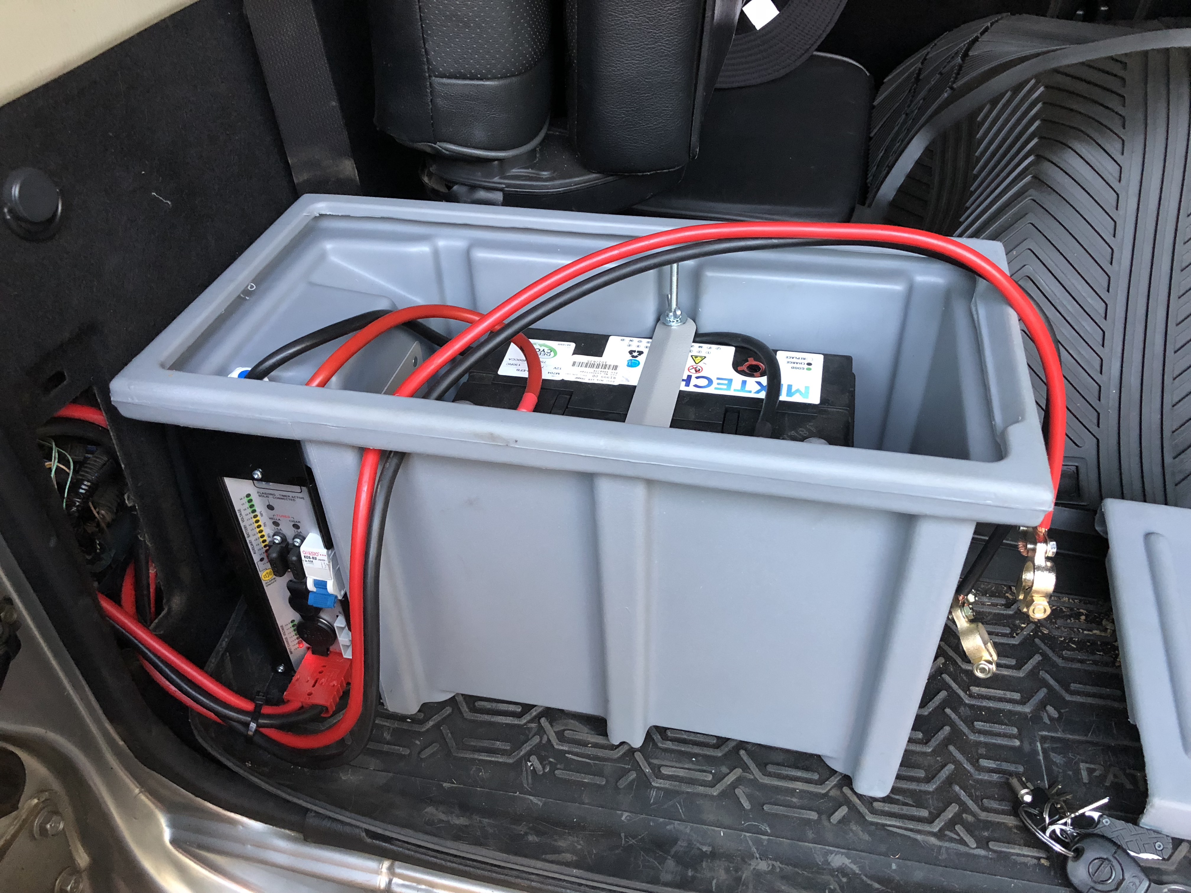

Well today I decided to treat the trolly a bit, except for the shocks and coils I also has a portable battery box installed. Now the guy that did it, misunderstood me a bit (he's a buddy and did it for free, I only supplied the components). But I wanted the battery box installed and then also a brad Harris plus outside to charge my trailer (which has a hcdp controller in it, its a wildebeest). So on the Navara I had a Harris plug outside which charged the trailer as I drove. Worked like a charm. But unfortunately he thought differently, so he installed the battery box, as well as the Harris plus outside. Which is fine. But, unfortunately, he did the setup in the way that I have to connect the cables to the auxiliary battery before the Harris outside will work (you will see in the pictures.
Now my first question....can I not just add a brad Harris to the cables running to the outside Harris plug, and then plug it in either on the side of the battery box if I want both to charge while I am driving, or just connect it to the cable charging the battery box (which also connects to the battery box with a Harris plug) if I don't want to take the battery box with?
Last question, anyone know of a nice little cover I can use to cover the opening where the wires come through into the back? I have the original cover but don't know if it will hold if I cut it in half

Thats a bummer with that extra cable and connectors, but, could you not plug that cable into the output brad harrisson plug on the outside of the box rather than having those extra battery connections? (assuming you wont need that output when towing the trailer).
On the cover - I have the same battery box setup, we just cut a notch in the cover, seems to work fine.

I don't understand the reason why you have a set of cables with clamps going in through the side of the box. Where is the other end of that set going?

Don’t ask, don’t ask. But solved it. Bought a red BH plug, so if I pull the trailer the battery will not be used (as the trailer has it all). So will add a BH to the wires going to the trailer. So then I just connect them. When the trailer is not in use, I’ll disconnect the two red BH, and plug the one back into the battery.
Don’t know what he was thinking but he did it for free, and everything is working so

Isak die beste manier vir daai systeem is as jy die twee rooi brad harrisons op n tee koppel voor die box sodat alles direk krag van alternator af het.
Miskien net seker maak dat jy fuses het van alle battery supplies af veral jou trailer ens
Maak ook seker die battery laai omdat daai nie systeem nie mooi werk vir iets anders as crank batteries nie....maar dis weer n ander een daai

Like Tinus said:
1. Keep permanent alternator power to the battery box (1 BH plug to the battery box)
2. Run permanent alternator power to a BH plug at the rear bumper for the trailer supply.

JipTinus lotz wrote: ↑27 May 2018 06:49 Isak die beste manier vir daai systeem is as jy die twee rooi brad harrisons op n tee koppel voor die box sodat alles direk krag van alternator af het.
Dis wat gedoen het, nie battery clamps afgehaald, nog 'n rooi BH aangesit. Fuses voor van die trollie se battery af. So babies gaan ek wanneer ek sleep, die twee rooi BH koppel dan charge die battery after in die waentjie (deur 'n hcdp charger) wat kom van die alternator af. En wanneer ek nie sleep nie, is die battery box gekoppeld van die alternator af. Gou vanoggend getoetst en dit lek dalem af alles werk, wel niks het nog afgebrand nie.
Nou moet ek nog net 'n solar regulator kry dan kan ek dommer my solar panels vir die battery box ook gebruik
2007 Nissan Patrol 4.8 grx
Re: Portable Luna box and other questions
Isak die probleem is die charge voltange en tipe battery ...sodra jou crank battery begin vol raak sien die alternator dit en die laai spanning val van 14v na 13.5 of daar rond so meeste smart batteries soek min van 14.8 tot 15v om oordentlik te laai soos lead crystal agm ens .
Op jou luna box is daar n output c/b wat keer dat die battery in n short kan voer kyk met of jou trailer ook n groot oorstroom sekering het onthou jy voer nou krag van 3kante in n moontlike fout in ...het al gesien wat gebeur met so iets en dis lelik.
Maar dis hoekom ons graag raad gee ....hoop dit help

Sal bietjie kyk. My Navara het 'n kabel direk van die alternator na die waentjie toe gehad (die ovens van wildebeest het dit nog in geit). Dit het baie goed gewerkt. Die waentjie se charger cater daarvoor. Hy het een van die bad boys inTinus lotz wrote: ↑27 May 2018 11:02 Isak die probleem is die charge voltange en tipe battery ...sodra jou crank battery begin vol raak sien die alternator dit en die laai spanning val van 14v na 13.5 of daar rond so meeste smart batteries soek min van 14.8 tot 15v om oordentlik te laai soos lead crystal agm ens .
Maar dis hoekom ons graag raad gee ....hoop dit help![]()
http://www.hcdpelectronics.co.za/index. ... duct_id=79
Jy sien daai is n dc na dc toe ramp die charge voltage op ...ek sal jou wys hoe om daai luna box te jippo om hom te maak charge ....toe Piet getrou het op Kubu moes ek 4 karre se luna stelsels jippo omdat as die voltage laag is val hulle heeltyd uit
