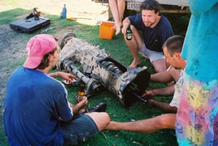

With the help of some friends we removed the gearbox.

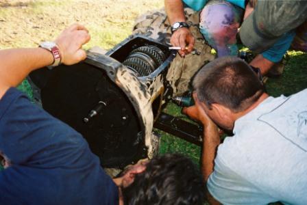

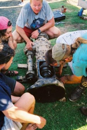

We took off the top access plate and the side PTO plate and could then get at the shaft and gear, but not the locating plate and bolt which was in the back part of the box. Unfortunately we could not get the idler gear out of the box without removing the main shaft with all the gears, which we were reluctant to try.
We managed to get the idler gear and shaft into their correct position but with the shaft back to front with the end protruding forward from the bearing and with the slot exposed. We then carefully drilled a 4 mm hole into the side of the gearbox opposite the slot in the shaft. This was the only way we could think of to ensure that the shaft could not slide forward again.
We cleaned out the hole and epoxied the drill into position with the end of the drill in the slot in the shaft.

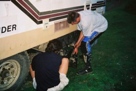

After washing out the box with some diesel and replacing the oil we got the gearbox back into the vehicle.
I drove about 1500 km home with no problem.
