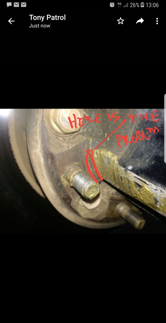

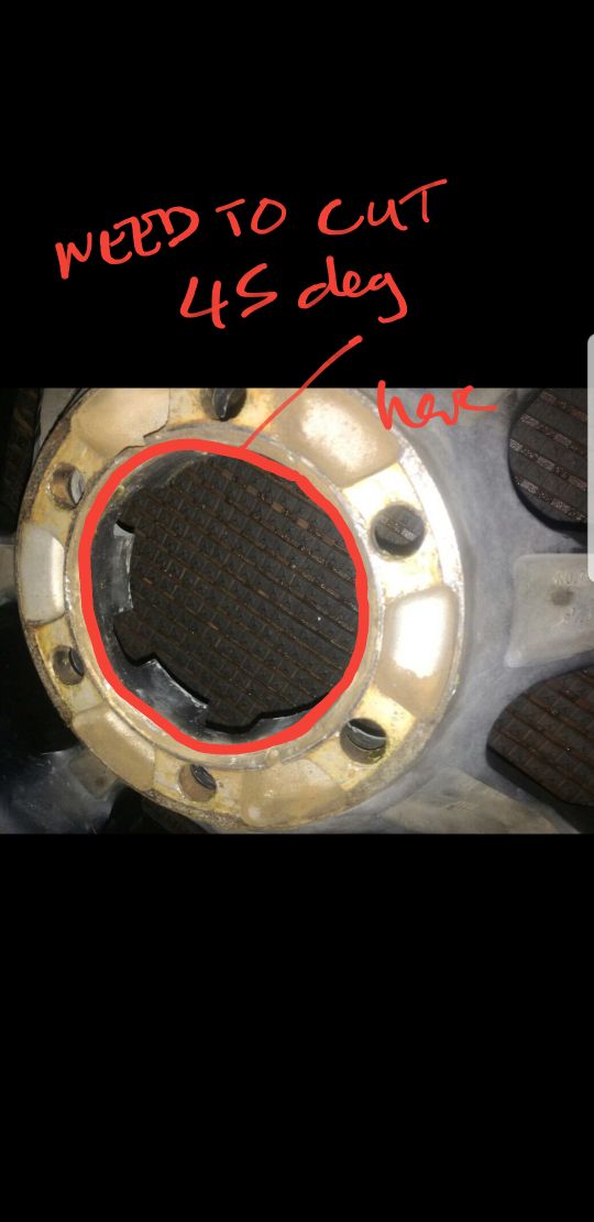

Ok, so, if I can machine my current rims to fit the Patrol hubs better, then no need to replace them - or if anyone can help out with the correct spacers to overcome the problem then I will be really grateful as my rims really do look cool and I would prefer to keep them!
I remember a thread some time back on wheel spacers, if anyone can point me in the right direction. Thanks.

If the rims are not to "thick" for the wheel studs to be long enough to have sufficient thread left, then the 6mm spacers that Cedric organized while back should do the trick.
Otherwise 30mm adaptor type spacers. But this might just be too wide and make the wheels stick out too much, depending of the wheels offset. ..
I got a set of 30mm spacers I am selling, but only got two. Also got 4 of Cedric's 6mm spacers lying around. (using one on the sparewheel carrier currently, but can make another plan there)... Let me know if you want to try them to see if it will work (see if enough thread on wheel studs will be left)..

Tony, call Gavin Byrne at zero82 36719one7. He can machine them. Much better than spacers.
Tell him I sent you, and tell him to call me to explain what he has to do. He did my previous mags, but that was 6-7 years ago, and I doubt he can still remember the dimensions.
